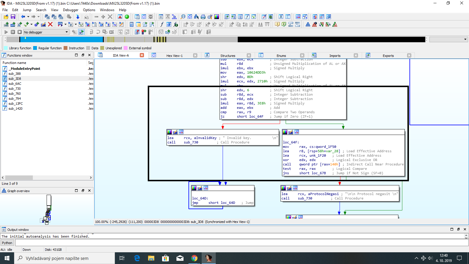

                                • RethoricalCheese
                                  • Mar 2013
                                  • 1519
                                  • Estonia
                                  #116
                                  Re: Remove_SMM... UEFI.
                                  Originally posted by kiknusko
                                  No problem i am working on lenovotranslateservice which will accpet any key
                                  You are focusing on the wrong part. Look a bit lower, outside of the box. There is an easier option to bypass.

                                      I Can unlock your ntb for free send me your BIOS dump and model
                                      • RethoricalCheese
                                        • Mar 2013
                                        • 1519
                                        • Estonia
                                        #119
                                        Well done! Did you find the spot I hinted or modified something else?
                                        • kiknusko
                                          kiknusko
                                          • Jan 2019
                                          • 26
                                          • Slovensko
                                          #120
                                          I think i find the spot you mentioned about, i changed jmp short loc_64D to short loc_64F
