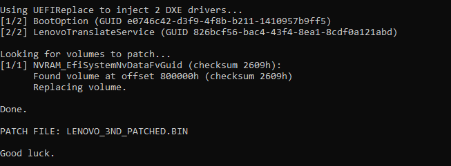

        Originally posted by daasco
        Hello
        I've tried the auto patcher and both bioses in attachment result 5 beeps
        both bioses are from Two different laptops
        in attachment there patched and original one
        thank you
        best regards

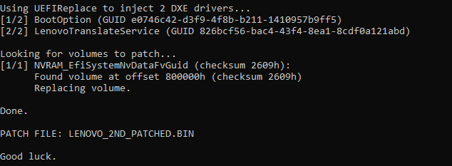

        Could you take a screenshot of the command line output you get when running the auto patcher with those files?
        They come out fine when I run it.
          not like your pictures my result different
            What's your version of Python?
            python --version

              Originally posted by knucklegrumble
              what's your version of python?
              Python --version
              2.7
              by the way
              the file you give works
              thank you
              • Knucklegrumble
                • Jun 2020
                • 78
                • US
                #1087
                Re: Remove_SMM... UEFI.
                2.7
                by the way
                thank you
                Latest auto-patcher does not work with Python 2.
                You need Python 3

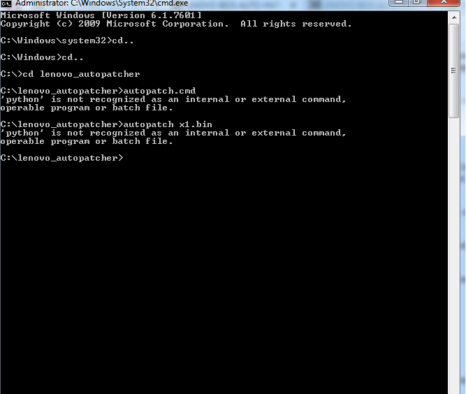

                  Hello. Why I can't download "LENOVO DXE Auto-Patcher.rar"? I got some error every time i try..
                      Thanks Knucklegrumble. I install python 3.5.1 and again got error in cmd. I m not sure where is problem, can you help me please?
                      • Knucklegrumble
                        • Jun 2020
                        • 78
                        • US
                        #1091
                        you need to add Python to Windows' PATH
                        here is the first link that came up on google...
                        https://geek-university.com/python/a...-windows-path/

                            #1093
                            Thanks a lot, I tried adding a path before I posted message here, but more things were causing me problems. I managed to get started lenovo_autopatcher in cmd and successfully made a patch.
                            I also tried "LENOVO DXE Auto-Patcher" but to no avail. I put python 2.7.18, set the path, the program starts, I choose the bios that I would like to patch, it says loading, but no file is produced... the program could not even be installed on win7 64, while on win10 64 it could ..
                              There is a security problem on a file. A file remains read-only. I have to look at why this occurs on my patch.
                                You need Python 3. The cleanup step won't work with Python 2. If your machine is an older gen it doesn't matter, but newer generations need nvram to be cleaned.
                                  Yes of course I used your patch with python 3.5.1, and it works perfectly.
                                  I can confirm that I have successfully unlocked the X250.
                                  Thank you so much for your work and commitment Knucklegrumble and Maxpower3.
