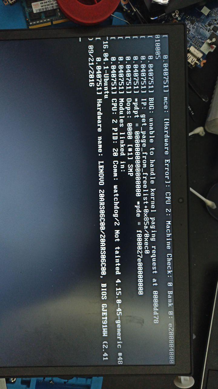

            #485
            Re: Remove_SMM... UEFI.
            Use Uefitool 0.27.0 for replacing the 2 files and Uefitool A56 to see or comfirm the address.

                      this bios is 8mb,the org bios is 16 mb.i check ram and ssd,its ok,i try without any drive and its the same problem.If i try to write mec 16xx can you help me with schematic pin connection and a good bin for EC MEC 16xx?thank you very much,i aprachiate!
                          Excuse me.Dont see size file
                          Goood ec file plus 1633 ec connect j tag pdf
                                        thank you very much for all your time i solve it.

                                          #500
                                          @CraterM
                                          @dani981
                                          I figure it out. The notebook it have 8MB flash. Probably someone try to unlock and replace the chip. Very strange that it start and ask for password. I discovered only when I change the chip
                                          So, I resolved by changing the BIOS chip, write one ME clean BIOS dump. After that I patch the new BIOS.
                                          Thanks for your efforts.
