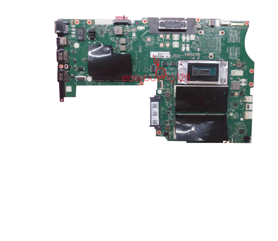

          Does anyone have solution for L450
          cant find modules Lenovotranslate and bootoption
          both chips uploaded
              both chips uploaded
              Hello supervisor password store not MEC1633 but also ps2408 chip data.
              Read ps2408 chip data and send bin file.
                both chips uploaded
                Maybe this chip.
