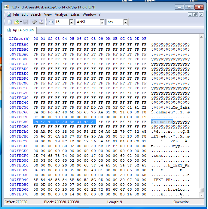

    good day
    anyone have a clean bios for hp 14-am070tu
    thanks
    this is my old bios

    Re: help need clean bios for hp 14-am070tu
    Whats your problem with original bios??? First describe a bit about your problem in detail.
      have power but no display
        your backup file is corrupt and can be extracted. I have downloaded bios from hp site but there are 06 diffrent bid type. can you post your BID number?? If you dont know how to find BID number ,then repost your bios to make sure the archive is not corrupt.
              Originally posted by Francisamd1
              try dis one sir
              The bios you have attached has 080BB as BID which is impossible. You seems to have downloaded wrong bios from HP site. The correct bios for this model is 081DC/DD/E0/E1/E3/EA. So first you clarify the confusion.
                I'm uploading all the six type of bios in two parts. One of them will definitely work,if it is bios issue.
                      Originally posted by ala_borbe
                      this is the bios
                      Ala borbe, i have a question. Normally we use HEX editor-find tool nad type $BID OR BID to find BID number on hp bios. But why on this particular bios searching didnt showed BID???
                      Please answer. I have a lot to learn from you.
