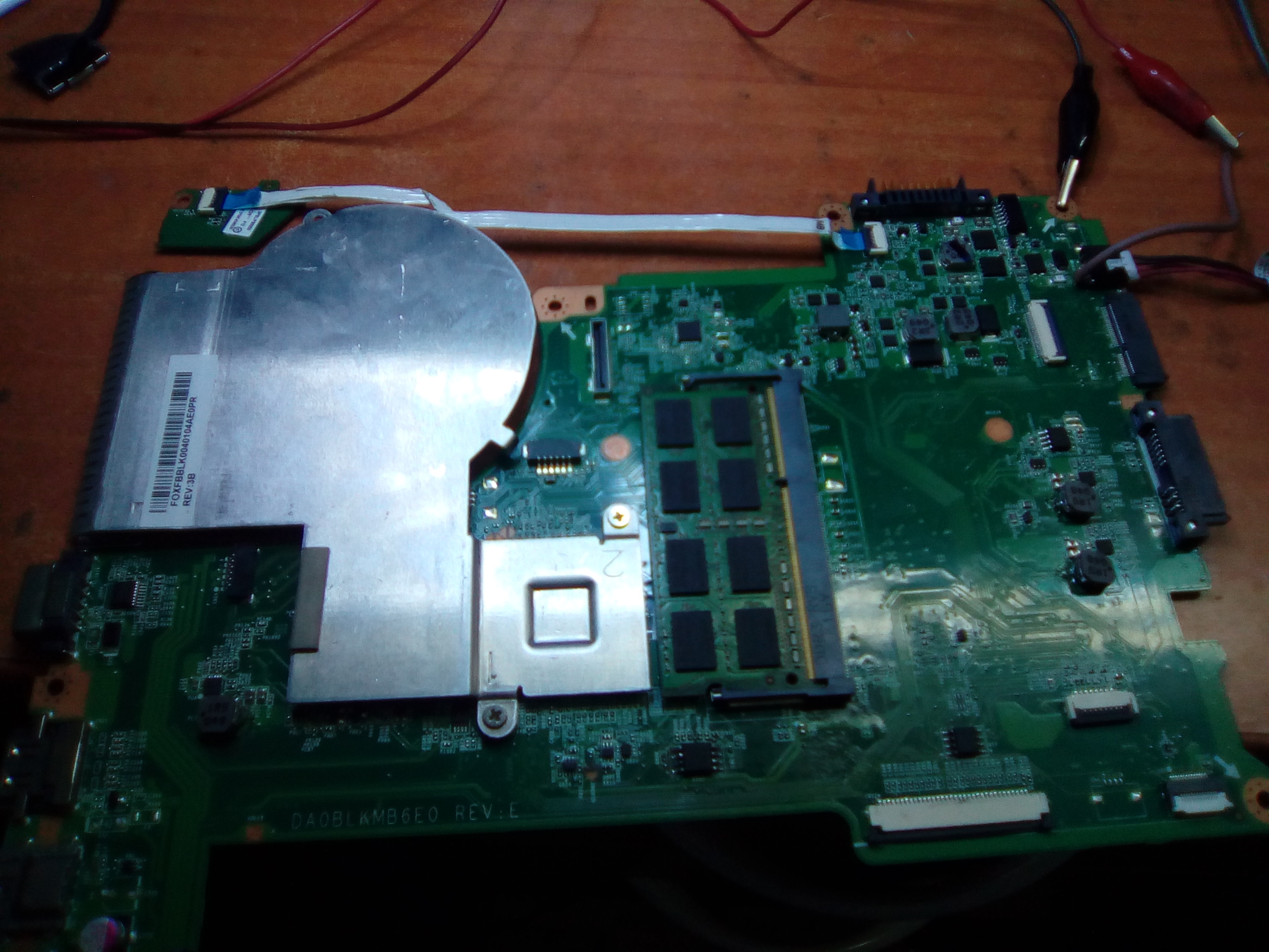

    please any one can help me ....
    Toshiba c55-b1179
    part : PSKTWV
    Board : daoblkmb6e0 rev : e
  • sourcebf
    • Jul 2016
    • 433
    • N/A
    Re: Toshiba c55-b1179 need bios
    update: 3.3v & 5 v are always present botton
    when I press power botton the other voltages are presents for 2 sec and goes..

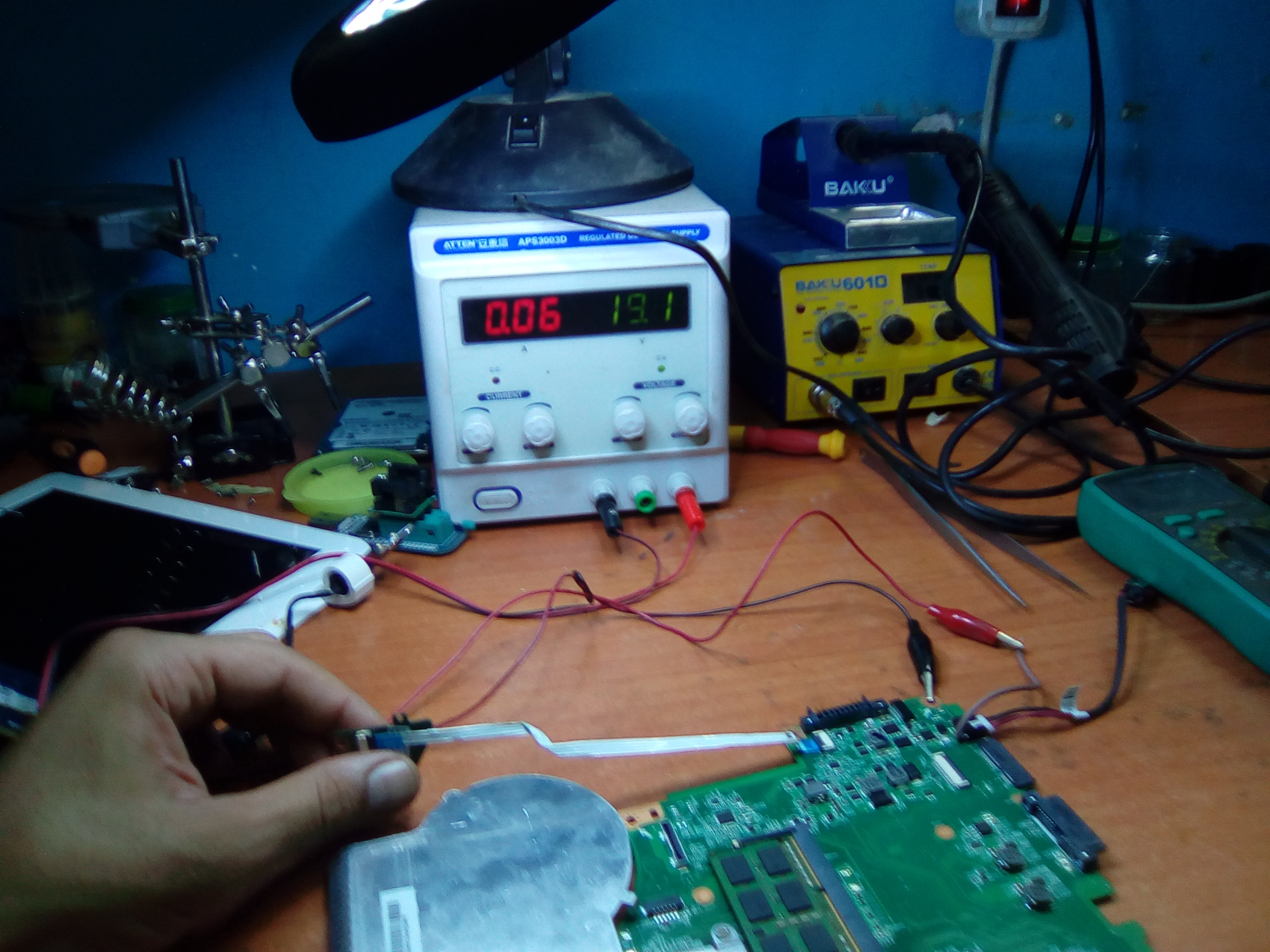

              thanks for your help, but still the same problem I think it is not a bios issu,
              using power lab, I inject 1.1v in coils and there is no consumation of amps
              (no shorts)
              when I press power button, it consum 0.08 amps and goes down ??
              any advices....
