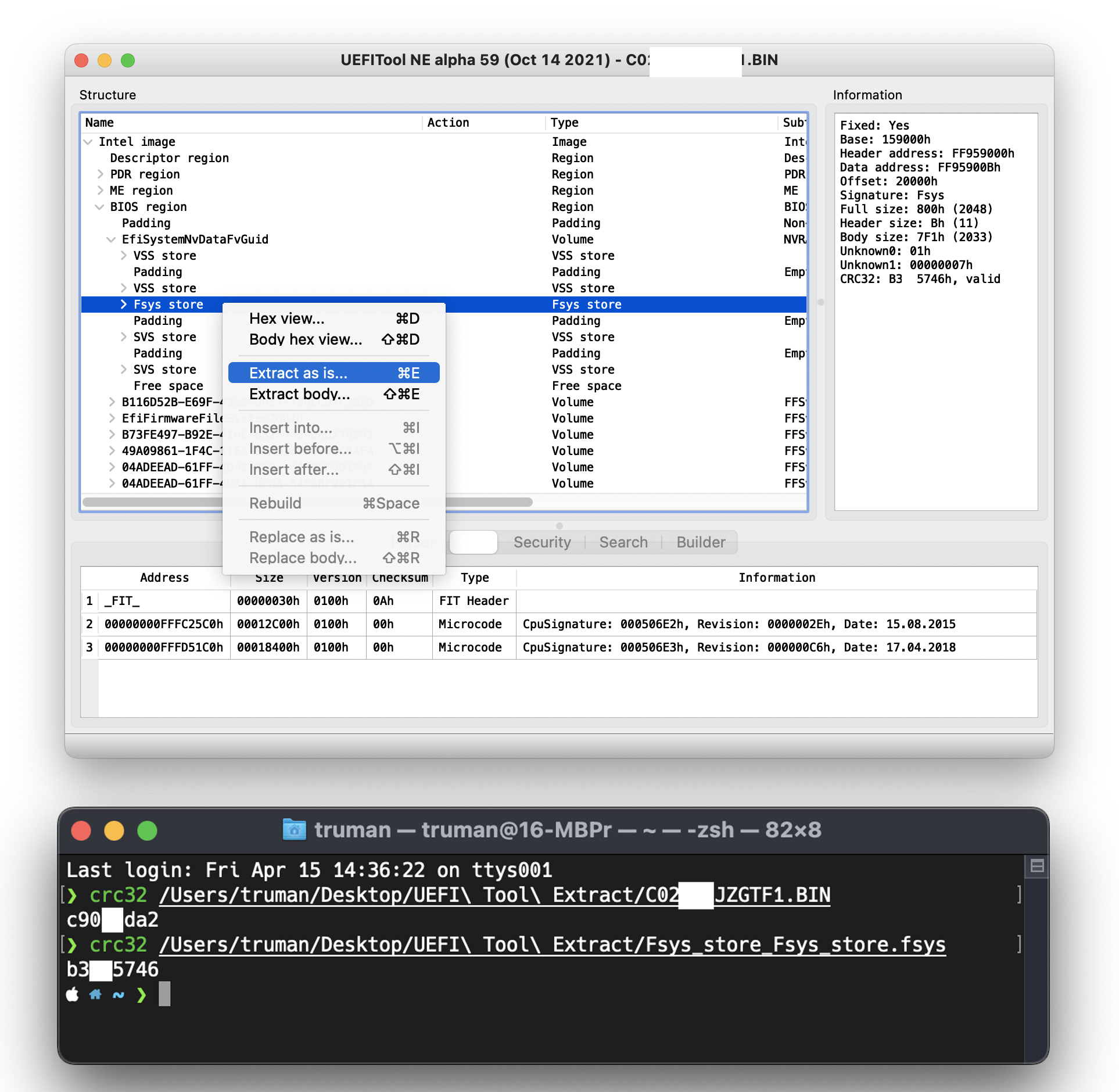

                      • TrumanHW
                        TrumanHW
                        • Jun 2021
                        • 52
                        #31
                        Re: Apple MacBook Pro A1502 (820-3476-A)
                        AWESOME !!!! YOU GUYS ARE EFFING AWESOME !!!
                        I found a tool called
                        UEFITool ...
                        Which parses a BIN out as shown
                        (note, it will open an EFI .bin but not a T2 ROM's .bin)
                        Navicated to:
                        Intel image --> BIOS Region --> EfiSystemNvDataFvGuid --> Fsys Store
                        Located in the right hand pane...
                        Which'll tell you if the CRC32 is valid.
                        Terminal: CRC32 [dragged entire bin]
                        Results (as shown) completely wrong.
                        Extracted a BIN (as shown) of just the Fsys region.
                        Apply CRC32 to just the Fsys section (same terminal process)...
                        It was the same code (as shown in image) as that which was "valid".
                        (for others, the "h" at the end (or x0) just means the format is Hex)
