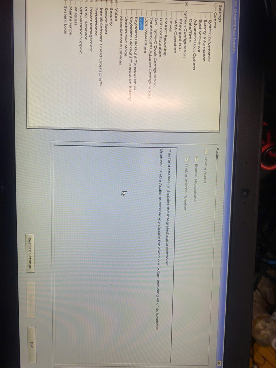

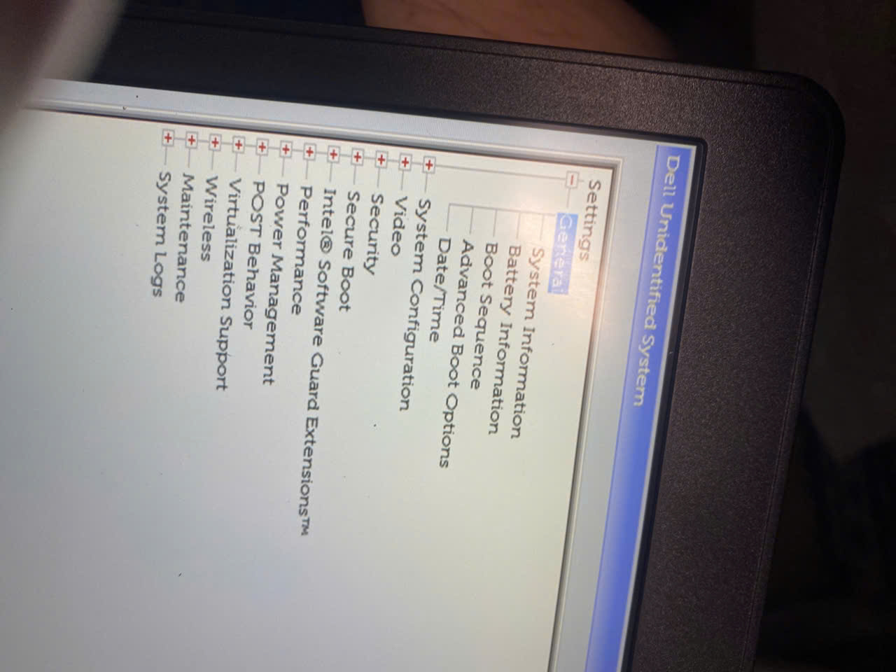

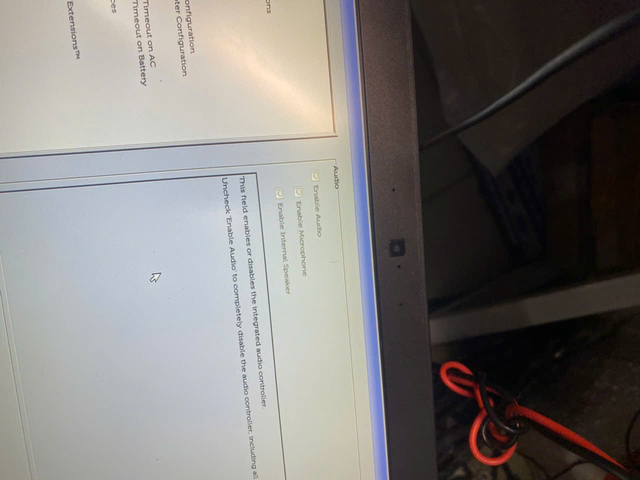

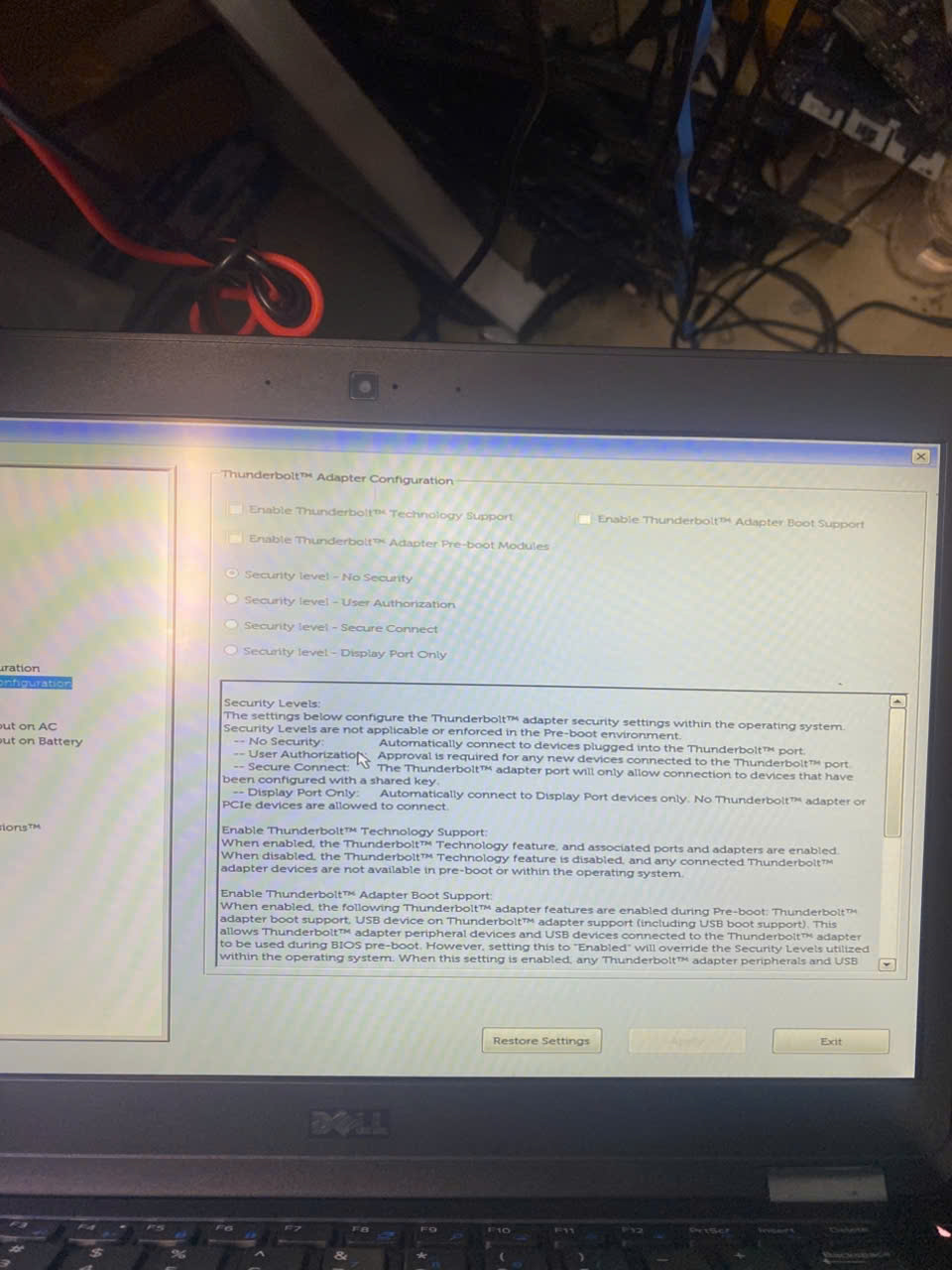

                    pls help me fix this dump, cannot boot and some items are hidden.
                    ST: 24XJTC2
                    • lapfix
                      • Mar 2020
                      • 2764
                      • my workshop

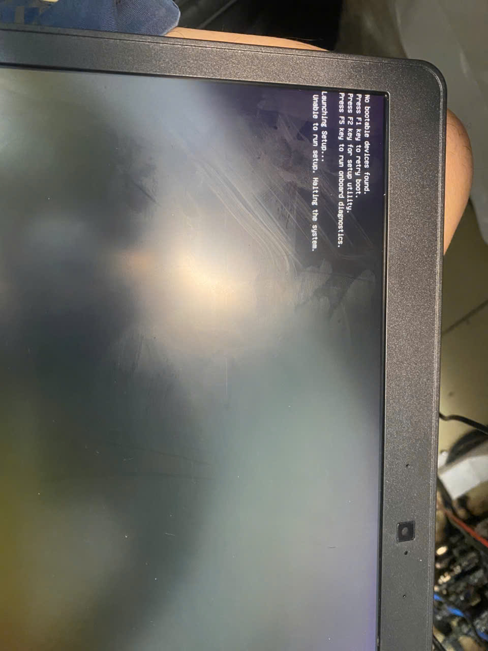

                                        I need help with my Dell Latitude E5470. Today, I decided to add an M.2 SSD to my laptop. I already had a working 2.5" SATA HDD with Windows installed. My plan was to use the HD to boot and then format the SSD.
                                        I installed the SSD and tried to boot from it, but it seemed very slow. Then I inserted the HD along with the SSD, thinking the system would boot from the HD and allow me to format the SSD.
                                        Now, the laptop won’t boot at all. The LEDs light up, the HD spins, but there is no video, and it seems like the BIOS is frozen. I read that this model might only support one storage device at a time, and I didn’t change the AHCI settings in the BIOS before installing both.
                                        Has anyone experienced this? Can anyone guide me on how to recover the BIOS or safely use both drives?
                                        Thanks in advance!

                                        post S/T, full name and model, motherboard model, etc.
                                        post the contents of the bios chip even if it is corrupted..
                                        The bios chip must be unsoldered from the board before writing or reading..
                                        do not use the clip, you may have errors..if you do not have anything to unsolder it with,
                                        solder wires between the programmer and the bios chip..
                                        you need an SPI programmer...here is a video for example..https://www.youtube.com/watch?v=DWWi...nnel=ThisIsHow
