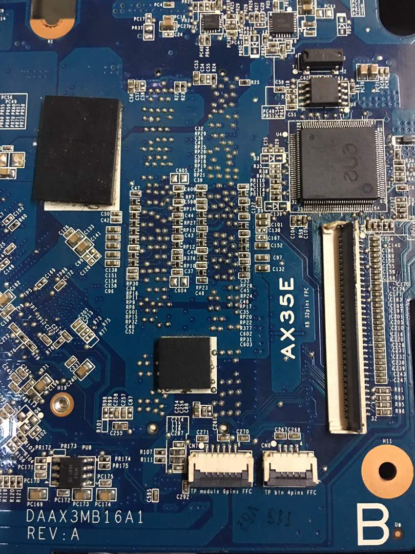

    Hi guys. Pls i need bios dump for HP G72 intel
    DAAX3M16A1
    REV: A
    this the old backup of my motherboard

                  Re: HP G72 intel
                  full model like g72-xxxx and is this only eprom on board?
                  i doubt that hm55 based board will have 1mb bios
                  find other eprom and read and post here

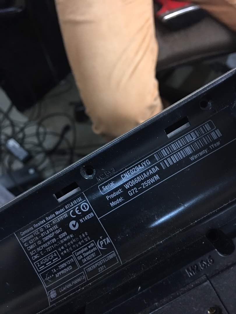

                    • ala_borbe
                      aka Donald
                      • 1625
                      • Malta
                      Re: HP G72 intel
                      HP G72-259WM
                      on hp support there are 3 biosfor this model
                      1. 1mb size 1484F37.zip
                      2. 2mb size 21484F37.zip
                      3. 4mb+512k 1425F37.zip
                      all there but you should use first 1484F37.zip
                      if that does not work, its not bios problem

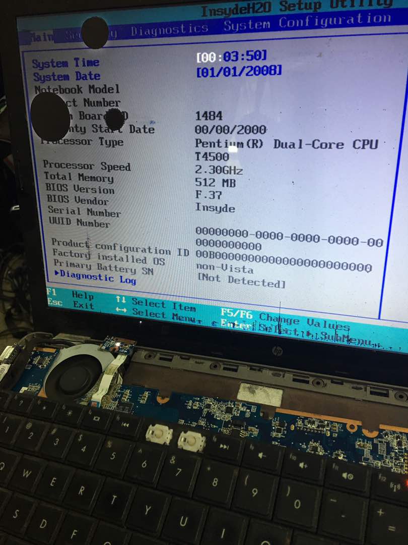

                      • imranromi
                        • Jan 2015
                        • 1288
                        • Pakistan
                        Re: HP G72 intel
                        here is.

                          Re: HP G72 intel
                          Originally posted by ala_borbe
                          HP G72-259WM

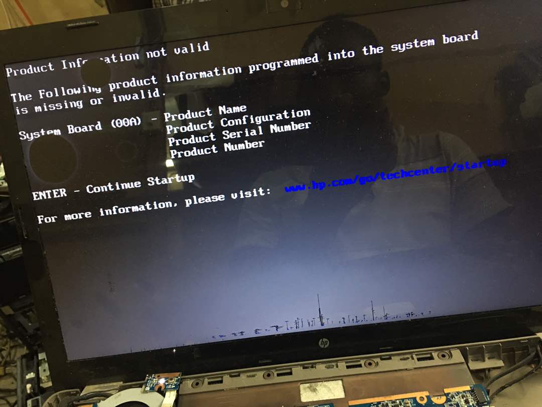

                          My brother I flashed the motherboard :
                          produit information not valid

                            Re: HP G72 intel
                            Originally posted by imranromi
                            here is.
                            thank's brother please can you help me? After the flash it writes produit informartion not valid

                                • mcplslg123
                                  • Jun 2015
                                  • 7262
                                  • india
                                  Re: HP G72 intel
                                  Man use dmi tools to fill missing info. Thats it

                                    Re: HP G72 intel
                                    Ok thank's bro
