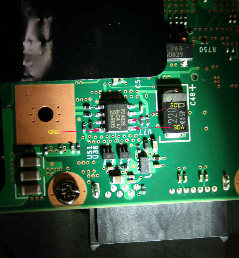

    hi to everyone
    pls help me with lenovo thinkpad t400 bin
    i have the locked one attached

    Re: Lenovo Thinkpad t400 bios bin
    Originally posted by jougounou
    hi to everyone
    Hello. By the way the lenovo T400 password is not in the bios chip. Its is in the '' NXP '' to see in the following image
      yes of course; it is the one i attached sir
        i only need the bin
        the one i attcahed is locked so i need annother one or the password
          [QUOTE=jougounou;747272]the one i attcahed is locked so i need annother one or the password[/
          ok Try her. His work
              hi and thanks mr Pascal Komlassan for ur collaboration
              it works like a charm
              once again thanks
