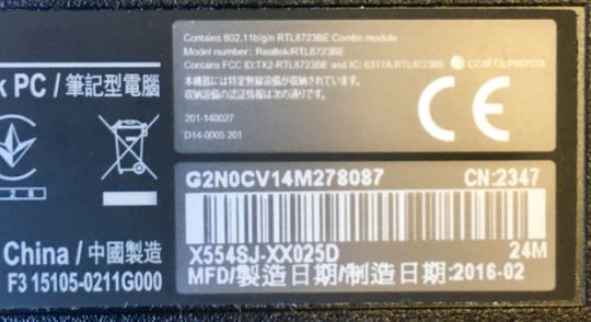

    Need Dump Asus X554S Please help.
    Asus X554S
    1609 CM-4 94V-0
    E162264

        Re: Need Dump Asus X554S Please help.
        Please look up model number again no such # it's showing. and reply with exactly what it has on sticker thanks

          It should be one of these models"X554UQ,UA,LI,LJ,LN,LD,LA,LP ...These are the X554 MODELS unless you gave that wrong ...something is not right.

            i think this mainboard x554sj , but from bios backup get dmiinfo x555sj biosver .205...
            At Asus website no bios update for x554sj... only x555sj
            refer : http://www.phang-nganotebook.com/upl...hread&tid=8304
            you right it should becheck from tag/label from bottom notebook, to makesure.

              You can't go by bios somebody could have programmed the wrong bin file that could be your problem he needs to read sticker maybe under battery so we could start from the beginning.
                here is a image of the model
                • cacla
                  • Apr 2015
                  • 442
                  By sn is this model X555SJ here ok bin
                    thanks for the help guys
                    • cacla
                      • Apr 2015
                      • 442
                      It work for you ?
