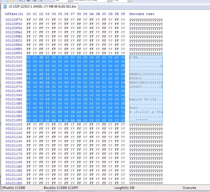

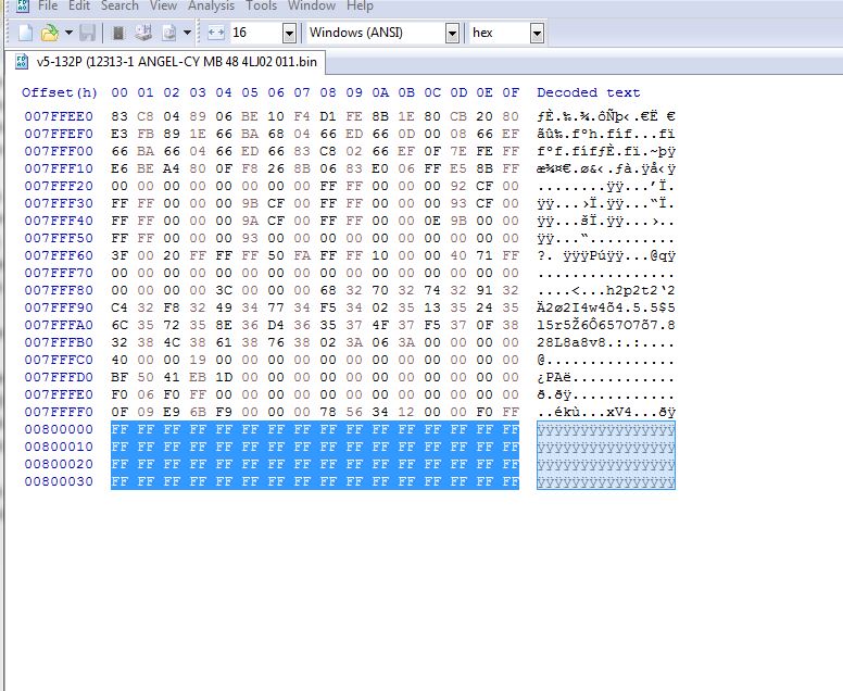

                        my orig bios 8192kb only, this file 8193kb after extracting, what can i do to be same on original files cpacity.. thanks
                          • 22312
                          Re: Acer v5-132p bios dump needed
                          Open the bios with a hex editor,delete the last 4 lines which is 1kb ,click save.If you still have your old bios backup you can copy your DMI info from the old to new if its important to you.
                          HxD https://mh-nexus.de/en/downloads.php?product=HxD20
