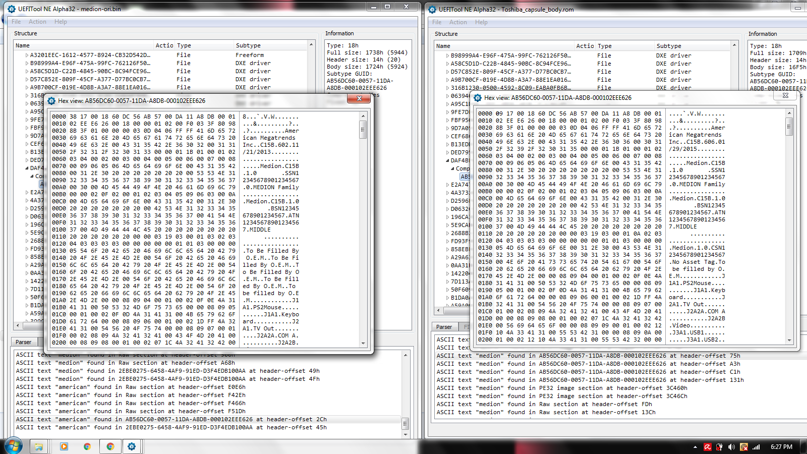

    Hello everybody,
    This one came to the workshop from a friend of mine. Never heard of this brand.
    Is it possible that anyone might have a bios dump for this one?
    It has 2 chips, main & EC.
    I have already made a backup of the main bios and also attach a file from the manufacture's site.
    Can somebody please help?
    Thank you

      what is your bios problem??
      password?? corrupted??
      trying to analyze your files...
      1. your backup files is different stucture with extracted from updatefiles, even it same size 4mb.. your updatefiles is for broadwell type...
      2. i think this updatefiles not for your type mainboard cause your mobo is hasswell
      3. I've tried to find the most likely this biostype, bios is hasswell then I, looking for another hasswell medion, and I get the only type E6421 with lot same (chipset, vga , cpu support, etc) the main different display size,,,
      so.... i think you can try this bios...
      toshiba_capsulebody.rom was extracted from bioe624x_p664x_w8.exe
      have a nice try...

        I friend of mine brought it, laptop powers on fan works everything gets hot but no picture.
        The original problem was with the operating system, no boot. He changed the hard disk, went to bios to check the settings and after saving the settings & exiting the bios the problem appeared. So I think that something went wrong with it.
        The problem is I can't find the part number - model - type of the motherboard in order to search for a dump.
        rioreno thanks for your effort, I will try it later and get back to you.

              ...so there is no problem for your bios, you dont need to to change or update...
              you can enter to bios right?? have you try to default setting??

                  rioreno I don't know how you did this but thanks a lot!
                  Laptop works perfectly. So for anyone looking for a dump it works perfectly.
                  Thanks again very much!
