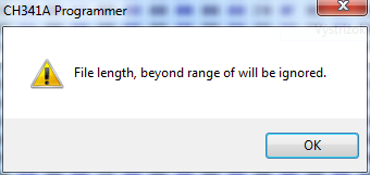

    Hi!
    I need ec bios file for HP ENVY dv7-7230ec laptop. Capslock led blinks twice - bios corrupted and screen was black. I tried flash bios file from official page throught external programmer, but now laptop is totally dead. Program wrote out error with file length and at the end of programming it wrote out another error. I have screen only from first error with file length ..I mean the bios chip is good, because I read the program from it before flash file from official page , I try to program this backup to chip tomorrow if it will be blinks twice again..
    Thanks for any advice"

    Re: HP ENVY dv7-7230ec bios problem + I need bios ec file
    Post the motherboard reference, and then search the dump for this mobo.
      Goya/Balen 1.0 DDR3
      11254-3
      48.4ST10.031
      I found bios for dv7-7252er this laptop has same mobo. I try flash it.
        dv7-7252er not work - power led blinks and fan spin for 1sec - again and again.. - same with backuped dump.
        at the end of the programming software wroute out " Chip with the contents are in disagreement."
          try this its for your laptop, but not latest version cos latest is crypted with rsa so i cannot prepare it so here is a version before it
          if laptop gives image, be sure to update to latest win official win flash
          serial also fixed
            your dump worked. Thank you very much.
