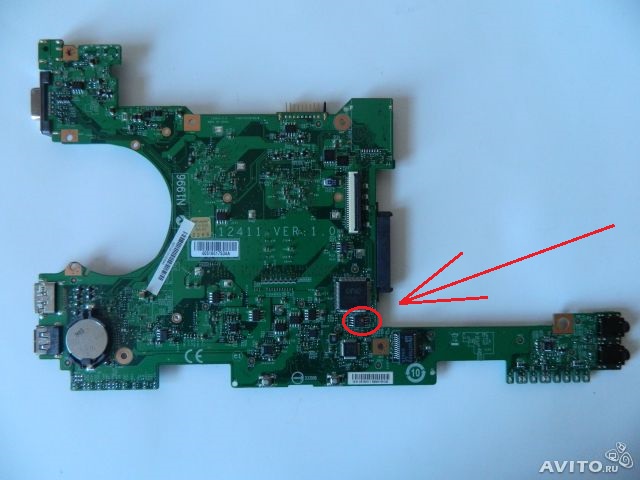

      Thanks for that do you know the location of the ROM chip
        Re: MSI u230 bios
        Here

              I have got my CH341a with the clip on attachment but it cannot find the clip I think I have everything connected up ok I know the diagram in the software is not correct.
                Re: MSI u230 bios
                I've got the clip red wire to to chip point with the dimple above and I've got the add-on board in the slot nearest the lock with pin 1 near the lock
