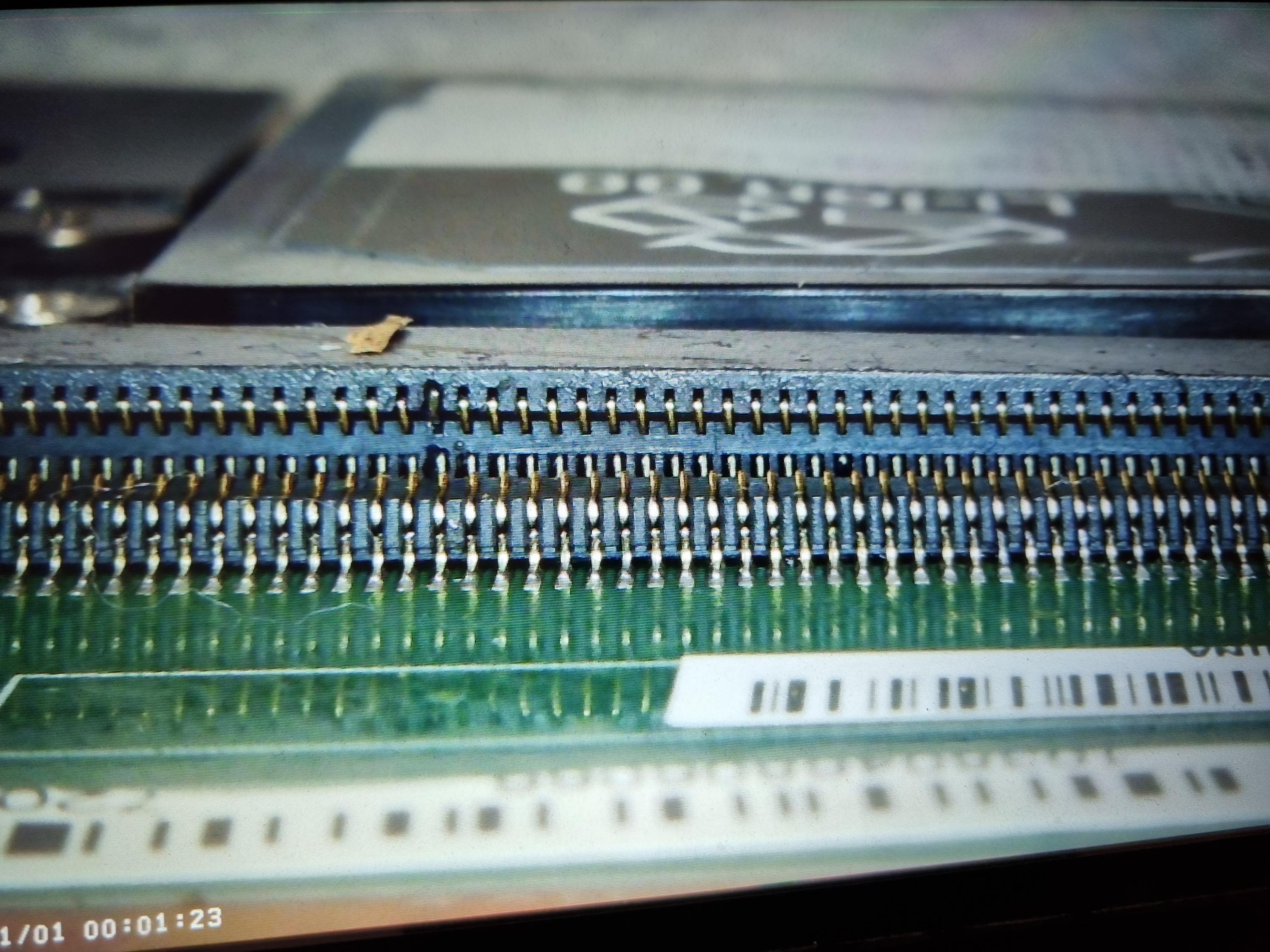

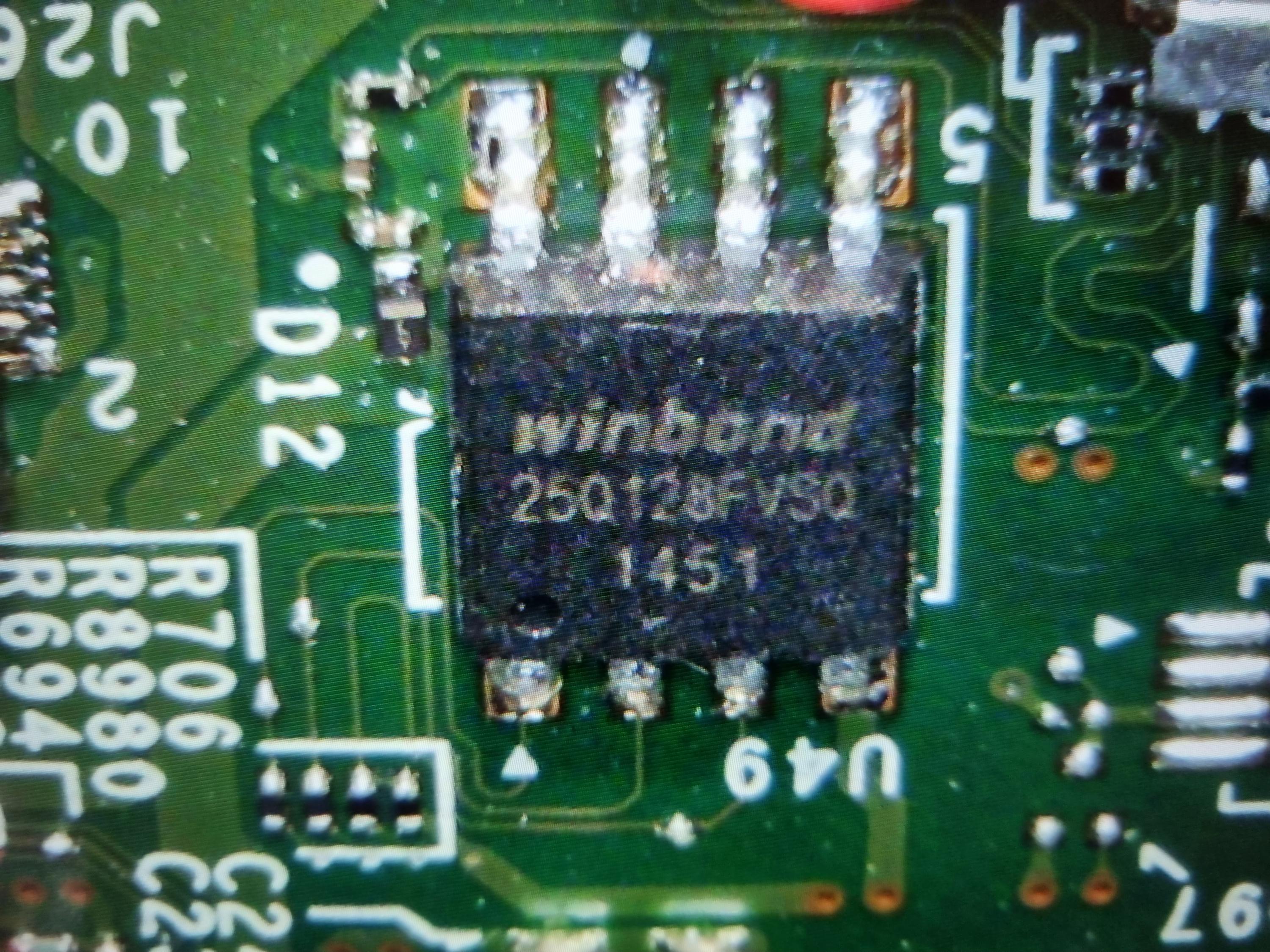

              Thinkpad X240 bricked by a Windows 10 update
              I was watching YouTube on my Thinkpad X240 when suddenly, I was greated by Windows 10's blue screen of death (BSOD). I've allowed Windows to do its log collecting stuff (from 0% to 100%) and the machine performed a reboot. While rebooting, it decided that this is the best time for a Windows update so it started applying some changes and then all kind of artifacts started appearing on the screen and the laptop froze.
              After a few minutes, I've powered off the machine by holding the power button and pressed it again, only to be greeted by what seemed like a BIOS level boot loop. The keyboard lights up (I got a backlit keyboard), fan kicks in then shuts down after ~1 second...and it was repeating this forever. Not even the power button did anything.
              I came to the conclusion that Windows attempted to make a BIOS update (I have never asked for) at start but something went wrong and hence my laptop is now bricked.
              I thought, well...I can reflash the BIOS. in fact I got a spare i5 motherboard I can read a working BIOS from. It's the same model number and revision as my i7 motherboard that I'm currently using (VIUX1 NM-A091 Rev: 1.0 2013-04-17).
              I only have a CH341A (black PCB) and a Raspberry PI 3 model B to do stuff like this so I went with the first.
              Both motherboards have the same winbond 25Q128FVSQ chip. Reading the corrupt BIOS went fine (I'm using SOIC-8 clips) and I made multiple backups and compared them, I did the same with the spare i5 motherboard.
              I've then written the i5 motherboard BIOS to my non-working motherboard but things only improved slightly: no more BIOS boot loop. The machine seems to power on but doesn't POST, screen is black and it automatically turns off after 1 minute. Neither trying the reset button (on the bottom of the laptop) nor pulling out the CMOS battery for 30 seconds improves the situation.
              I then tried almost all BIOS I could find in this thread:
              https://www.badcaps.net/forum/showthread.php?t=53578
              I got the same black screen, no POST with all of them.
              Then I did some more digging and found this great guide about how to clean the ME region:
              https://www.badcaps.net/forum/showthread.php?t=88533
              The ME Analyzer has given me the following warning, so I got hopeful:
              "Warning: Data in Engine region padding, possible data corruption!"
              I've build a new BIOS with a clean ME region using this guide and loaded it...only to be greated by the same black screen, no POST issue
              After this, I've tried to make a sanity check by loading the original, corrupt BIOS back to the motherboard and was surprised that even this has the same behavior, black screen, no POST.
              By this point I'm not sure what's at fault:
              The programmer (CH341A)? I have verified all reads/writes multiple times and found no problems. I've even tried multiple applications (AsProgrammer, Colibri, NeoProgrammer).
              Maybe none of the BIOS-es I have tried are compatible with this motherboard and I have failed to restore the original with my clean ME attempt?
              ...or did that update fried something on my motherboard?
              I would love to hear your ideas

                  #88
                  Re: Thinkpad X240 bricked by a Windows 10 update
                  Originally posted by hoaca388
                  X240 Laptop (ThinkPad)
                  Just tried it, still the same issue: black screen, no POST
                  Did 2 verifications after writting just to be sure. Also tried the reset button and pulling out the CMOS battery for 30 seconds.
                  • Norrecito
                    • Apr 2022
                    • 40
                    • Hungary
                    #89
                    Re: Need bios dump for Lenovo Thinkpad X240
                    OMG, it's the DIMM slot! The problem is the DIMM slot.
                    I have a bent pin there. Either this or I have cold solder joint on one or more pins of the DIMM slot because if I hold down the RAM while powering on the machine, it starts normally and I have picture. I also POSTS.
                    It freezes as soon as I let it go though.
                    The corrupt BIOS was definitely a problem but there is this too.
                    Still can't believe I have two separate problems...anyway, I will see what I can do about this.
                    hoaca388: thanks for the BIOS, it seems to work fine. I will use that one if I manage to sort out my DIMM slot problem.

                      #90
                      FIXED!
                      I've managed to bend back that pin and it's all working now
                      Considering the history of this motherboard (which I previously didn't share because I thought it was irrelevant), it seems to make sense now.
                      This laptop originally came with the i5 motherboard (the one I've referred as a "spare" in my previous posts) and I bought that i7 motherboard with a "no picture" issue. The issue was a corroded pin in the DIMM slot...most probably the same pin which was now bent. I've fixed it by simply cleaning that pin and was using this machine with the i7 motherboard for more than 6 months without any issues. I even did multiple memory tests after cleaning that pin to be sure it was working and also verified the contact of the pin with a multimeter.
                      I'm not sure how it got bent (I didn't open that machine until it was already bricked) but my theory is that it somehow came lose and caused a memory problem which failed that forced BIOS update.

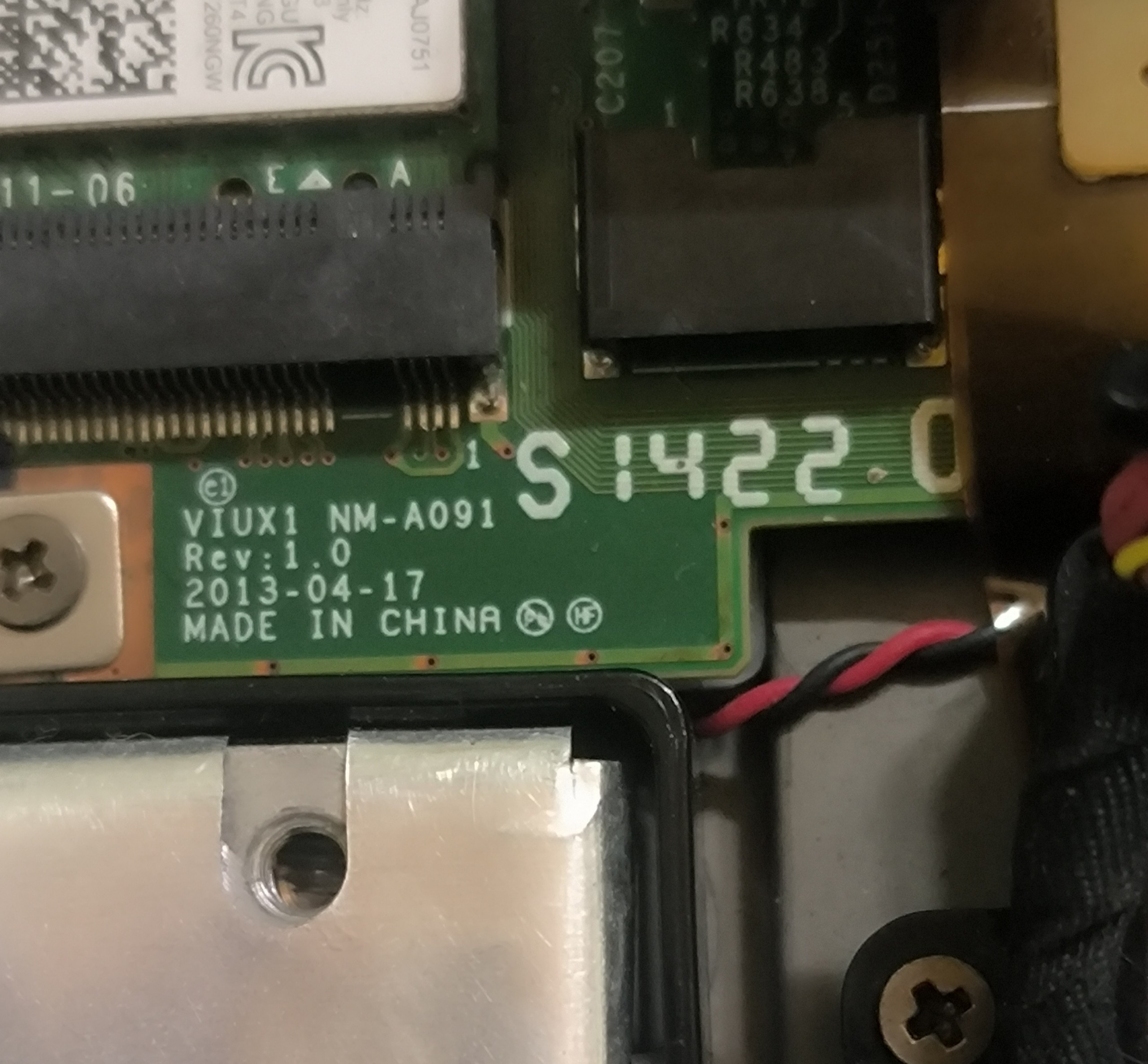

                              #94
                              Re: X240 BIOS FILE/Clean ME HELP
                              Originally posted by SMDFlea
                              Sorry...!
                              My thinkpad x240 seri: NM-A091 v1.0 date 2013-04-17

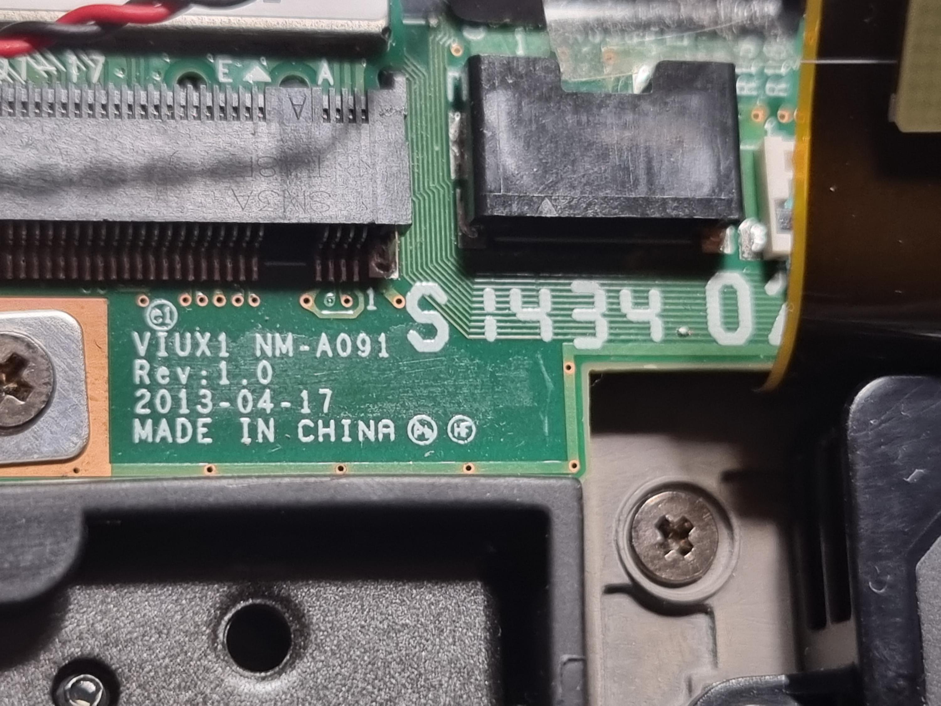

                                #95
                                Hi
                                After update the bios to 2.49, the computer died, and dont turn on anymore.
                                Thinkpad x240 NM-A091 v1.0 date 2013-04-17
                                I was not able to able to backup the original bios because it fails always the reading, so I tried programing the bios.
                                After lots of attempts, finally i was able to flash the bios, and now the bios already reads and writes well.
                                I flashed the bios in this post
                                https://www.badcaps.net/forum/showpo...8&postcount=20
                                and the computer wakes up finally.
                                the computer now is booting, but takes to long to boot, since I press the on button until the lenovo logo appear, takes more than 40 seconds.
                                I noticed that it don't have the ME firmware installed, I tried to flash another bins from this thread, always the same, no ME installed. i tried to download the ME from lenovo page, to install it thought windows, but always get a message no ME installed and fails.
                                How can I install the ME firmware. Any help is welcome!

                                  #96
                                  Hi!
                                  I installed the bin in this post
                                  https://www.badcaps.net/forum/showpo...3&postcount=48
                                  it already shows a me firmware version, and is faster to appear the lenovo logo, but after 1st reboot, when starting boot, it goes off and on automatically 3 times and now I'm getting this error in bios (pitcture attached)
                                  Its a I7 4600U CPU and bios chip is W25Q128FV
                                  I'm newbie, its the first time that I'm dealing with bios problems, so any help is welcome.
