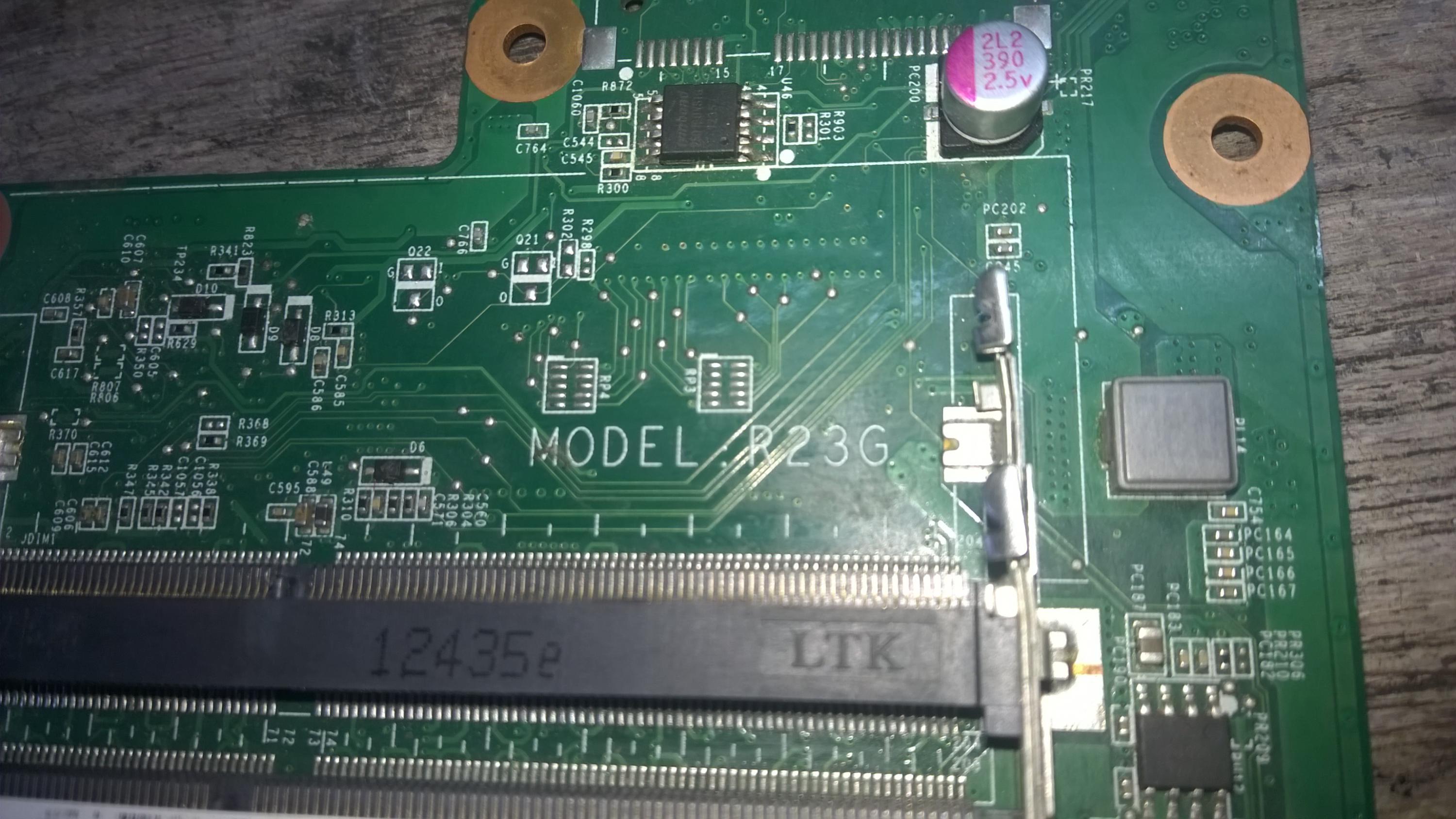

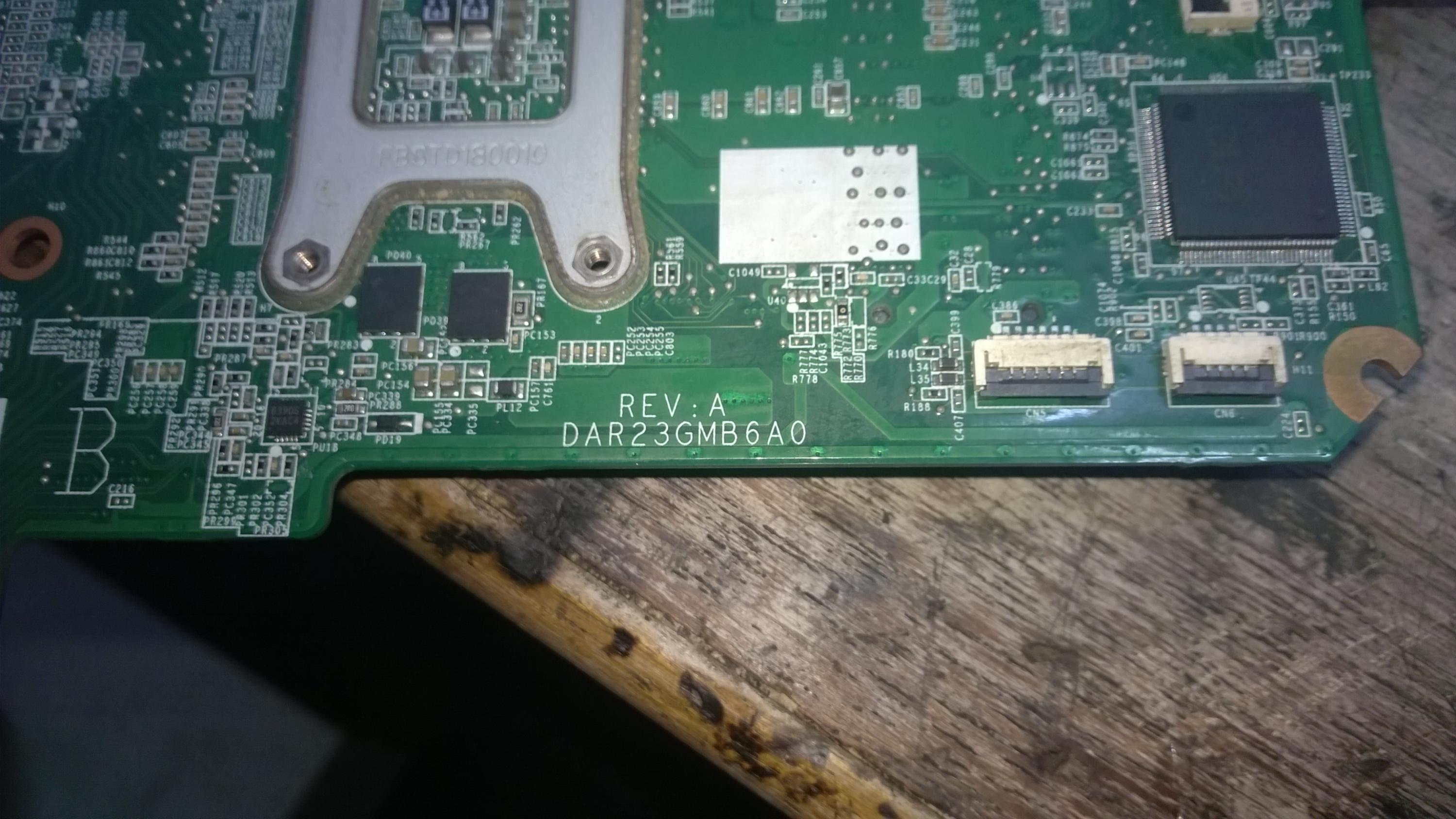

    WHEN I TURN ON LAP SOME TIME WORKING .BUT 1 OR 3 minutes then auto off . charging blinks no show . then no power no turn on .
    after 1 hour again insert charger then show charging blink .turn on. only working 1,or 5 mintues then auto suddenly off .
    already reblow northbrige again same result .no ceramic shot and ram slot voltage also correctly 1.5v power jack 19v correctly coming , cmos 3v , v core line correctly . power switch 3v . all fets correctly showing voltage . i/o get 3v
    then i think bios may be corrupted so i change bios using nano bios programer. download from internet. i forget that before no backup my factory installed bios . after check laptop no power
    before conditions not working . i think wrong bios installed
    pls give correct bios

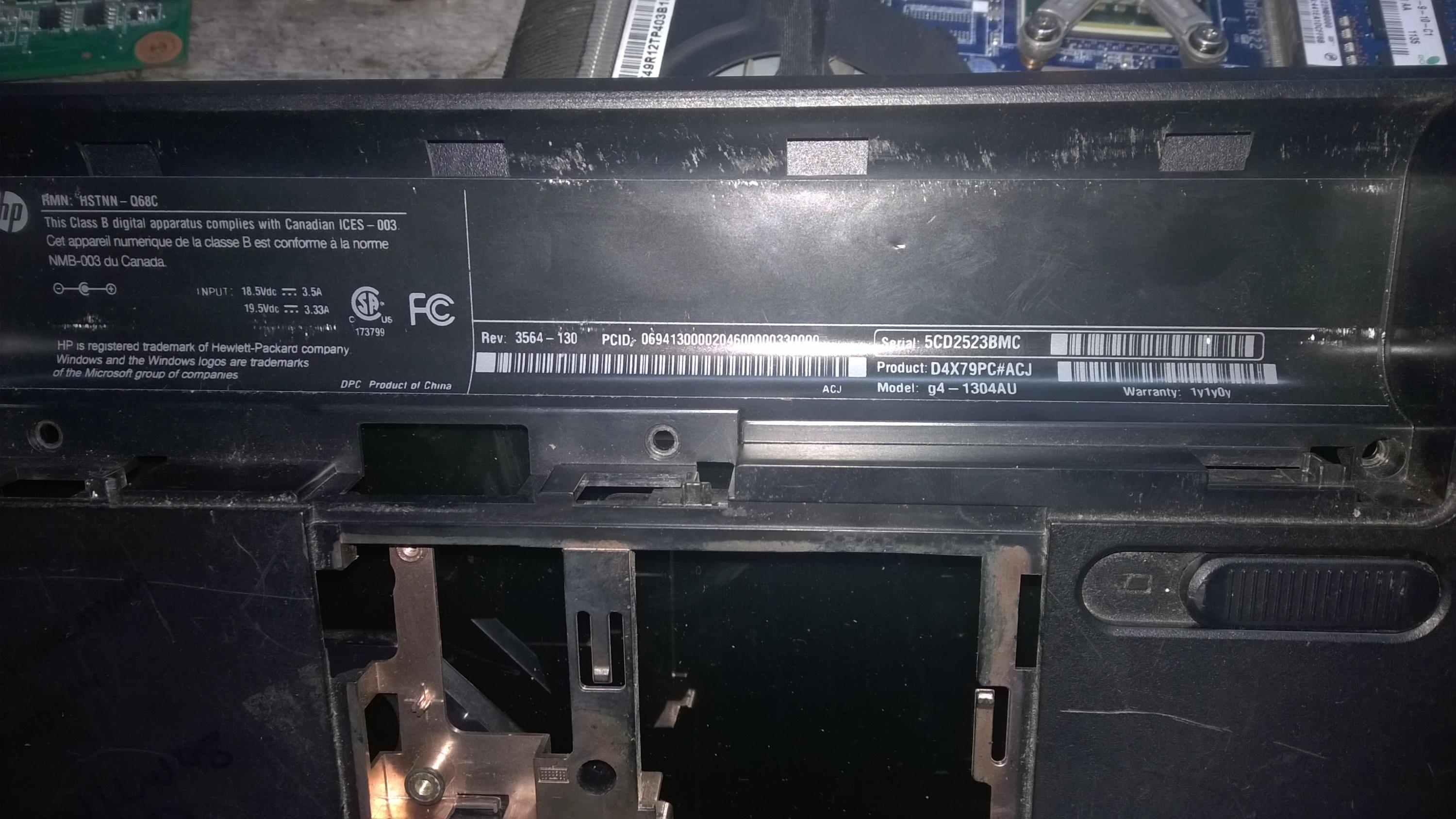

    model :G4-1304AU
    rev:A
    DAR23GMB6AO
    BOARD MODEL :R23G
    AMD PROCESSOR AND AMD CHIPSET
  • maestro_lpc
    • Mar 2015
    • 14
    • Georgia
    Re: Hp laptop
    Official dump hp.com. 4 bios dump no serial. See BID information in old dump.
