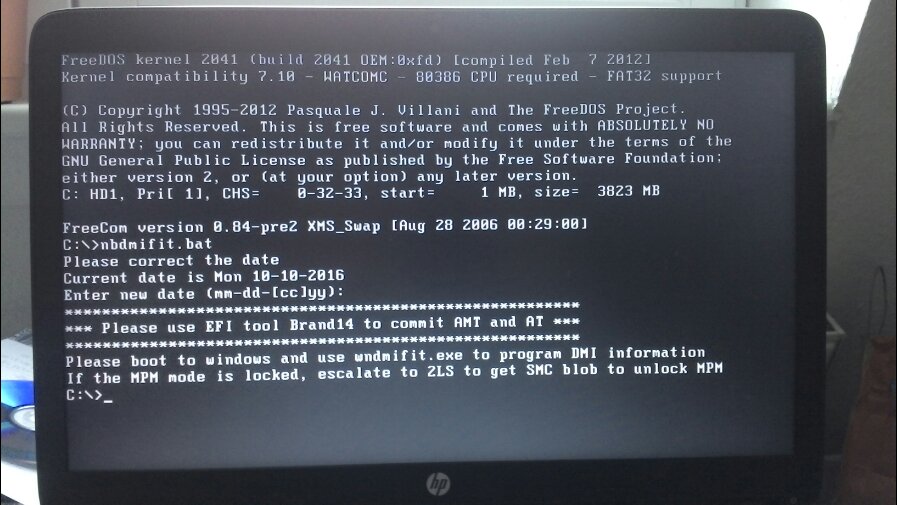

        Re: HP6735s "invalid serial number", bios needed
        Guys,
        I got this message. Any suggestions?
        I believe I am close to be able to finaly tattoo again the serial number and the product model.

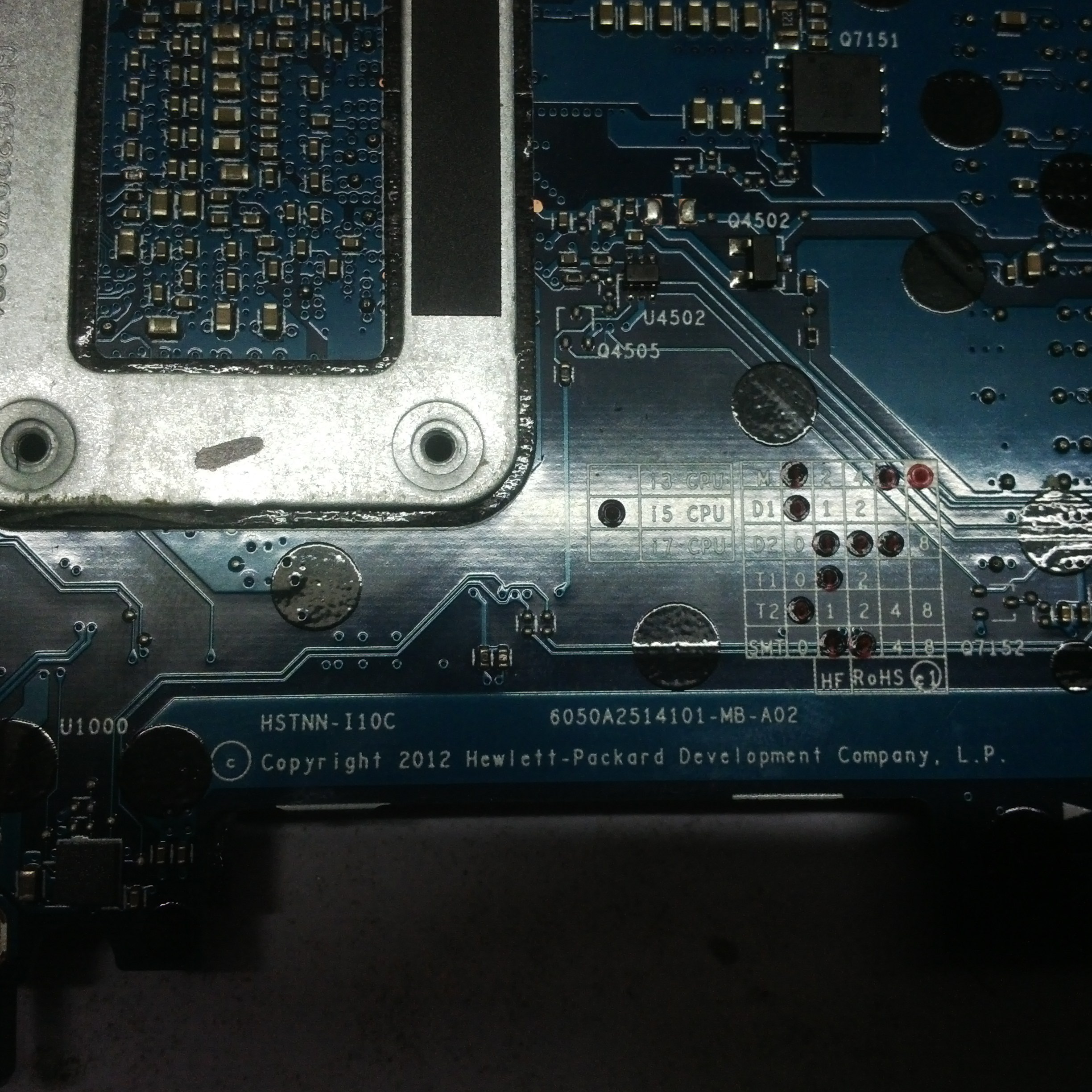

                      Originally posted by ala_borbe
                      underneath that sticker is a motherboard code which is i guess 6050A2235601-MB-A03
                      all dumps i found are 2 mb.... schematics also says 2mb SST_25VF016B...
                      why not take eeprom from other non working board and put it in... its worth a try.... any 2mb spi eeprom should work
                      did you see traces of soldering when opened? maybe someone did some work before you... :/

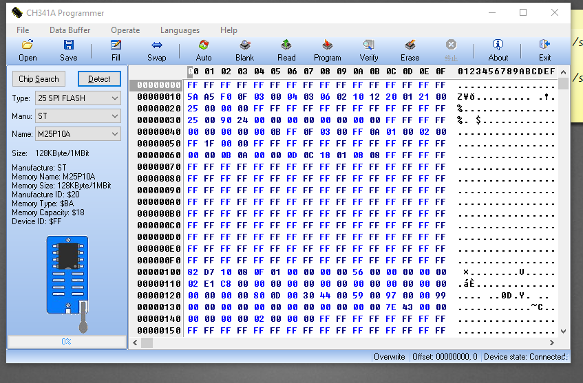

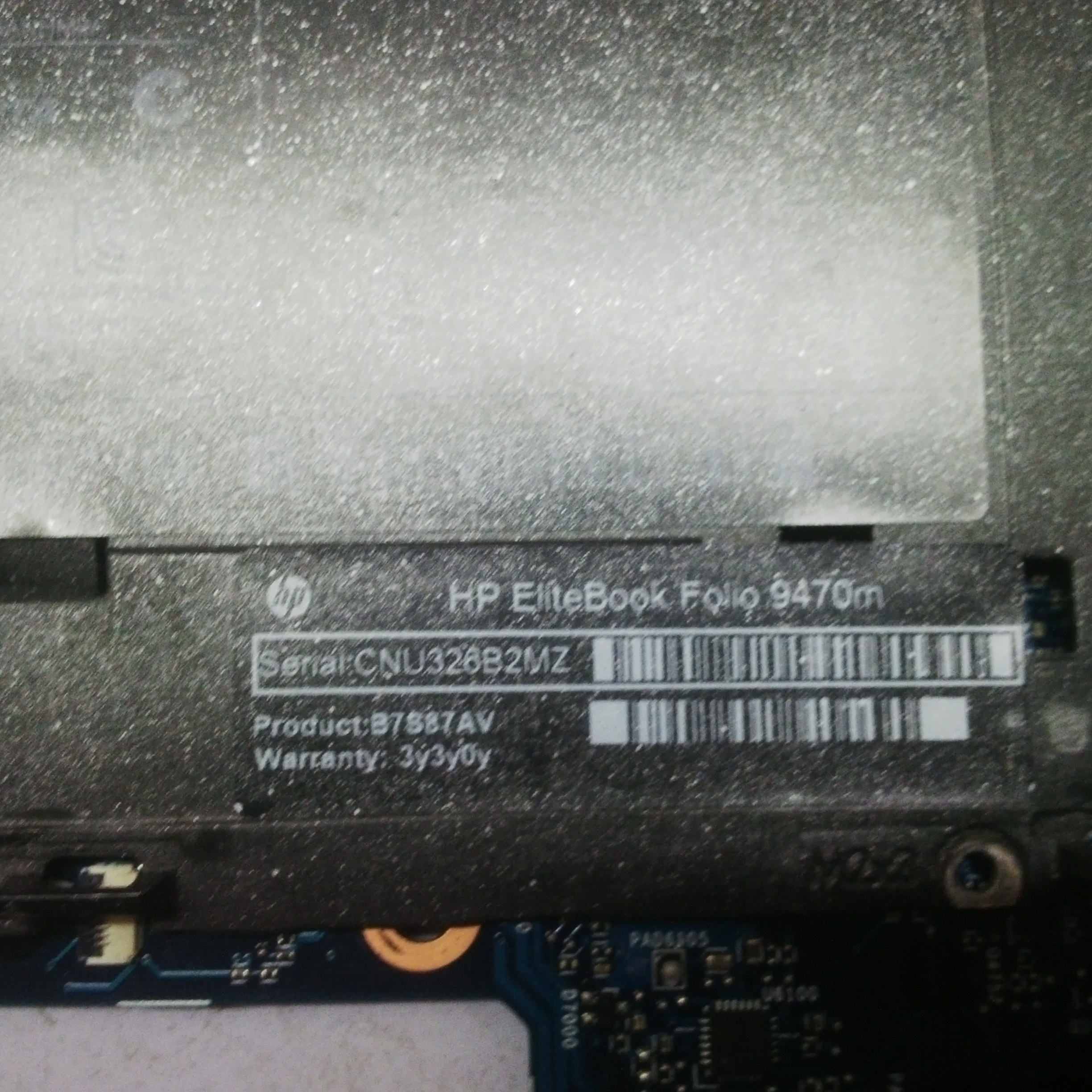

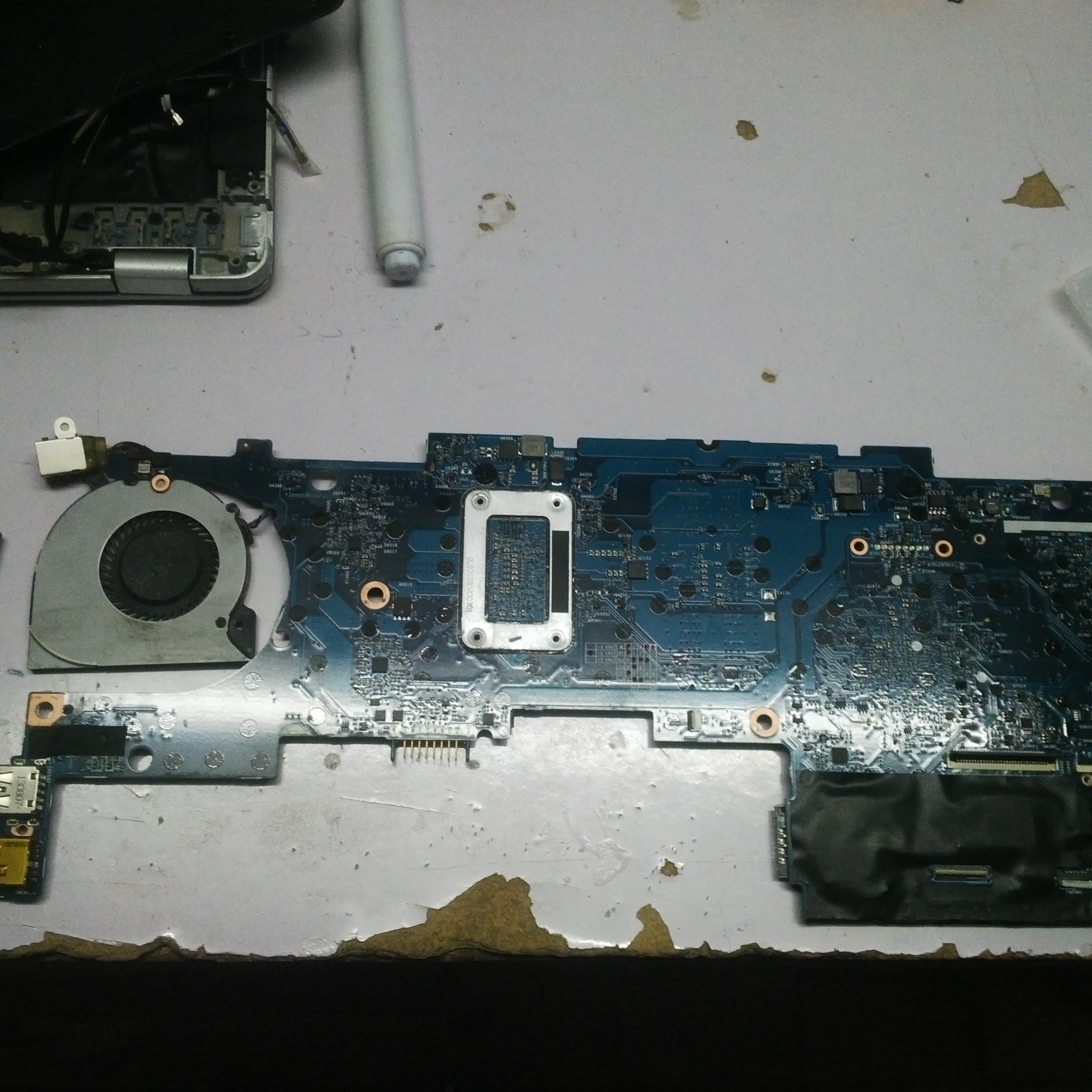

                      hallo there i recently replaced a clients motherboard for folio 9470m, it says non committed state but bios chip is 128kb/1mb st chip but cant find right bin file for this ...see attached mobo no. and screenshot am using ch341a lack mini programmer

                          This worked for me after a LOT or searching online. Wanted to document for others. Pre-req: get all your machine info beforehand (S/N, Product # and CT #).
                          HP Elitebook 8460p, fine for many years but after a power outage it went into "Manufacturing Mode". Got past that but was having the "System Board (00A)" not found errors after that and then Windows wasn't activated anymore. This worked for me:
                          1- nbdmifit -2.10 above, built out a bootable flash drive with this, using Rufus / Freedos.
                          2- Renamed \wndmifit\FSMC.bin to SMB.bin and copied to root of flash drive.
                          3- Shut down. Hold windows key, Up-Arrow key, and the Down-Arrow key then the power button. This put my machine back into Manufacturing Mode (required for next steps)
                          4- Disable UEFI in BIOS (if used), boot directly to USB flash drive with Freedos, run the Run NBDMIFIT.BAT and followed the prompts - this didn't work earlier until I used STEP 3. When done rebooted and no more Manufacturing Mode anymore. Restore UEFI in BIOS if needed.
                          5- If seeing a "Restore Mode On" message during boot, I was able to fix that by re-running the HP BIOS update program on my device and then rebooting.

                            i bad check bios id. it was 2MB, but it was corrupted. Cannot program it to end. So i took the same from HP 625 and program it. now i can see boot devices and can boot to DMI and change the sn.
                            I attach DMI with usb format tool.
