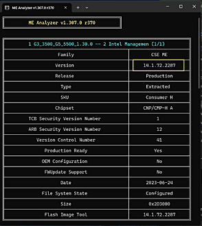

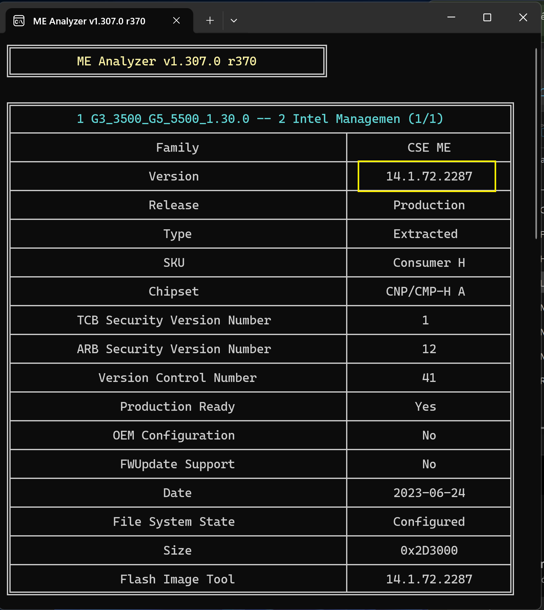

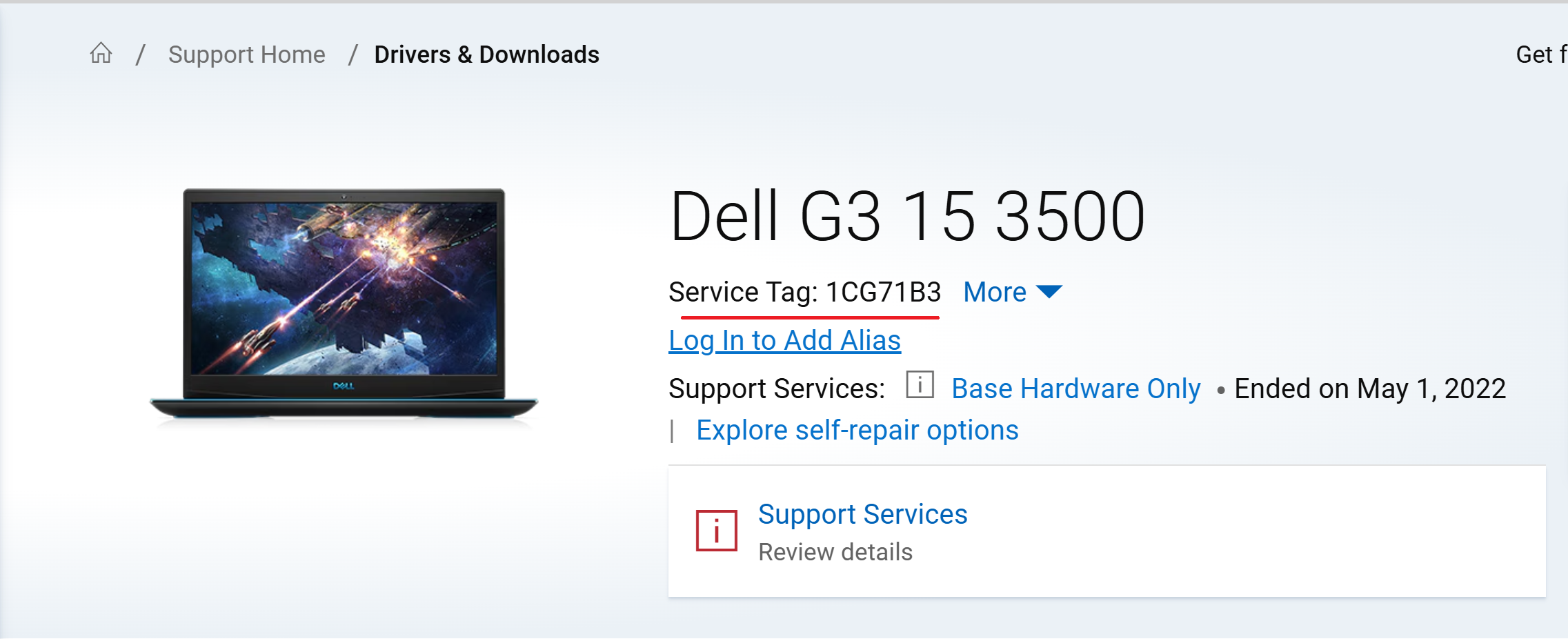

    According to the Service Tag your model is Dell G3 15 3500 and it only has Me 14.
    Click image for larger version  Name:	2025-09-16 13_26_45-Settings.png Views:	0 Size:	601.7 KB ID:	3725943
    Click image for larger version  Name:	2025-09-16 13_28_48-Settings.png Views:	14 Size:	87.0 KB ID:	3725946

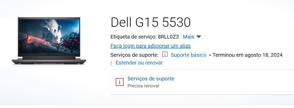

      Hoacca388,
      thanks for your answer, but I think you´re wrong, my friend.
      Service Tag is 8RLL0Z3 and is really a G15 5530.
      The screenshot is attached.
      But thanks a lot for your quick response.

        Originally posted by bednarek
        Hoacca388,
        Dell G15 5530
        Service Tag: 8RLL0Z3
