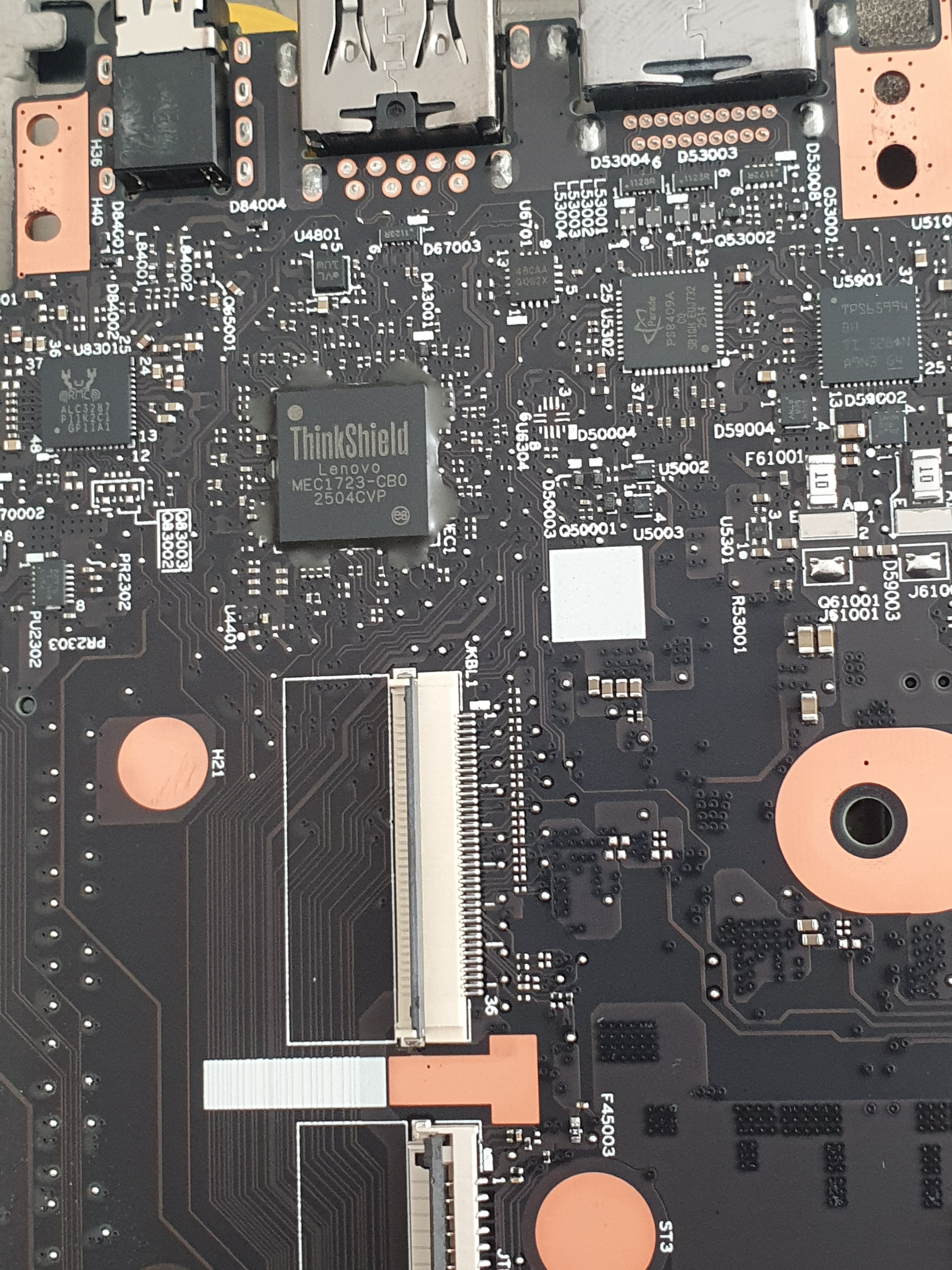

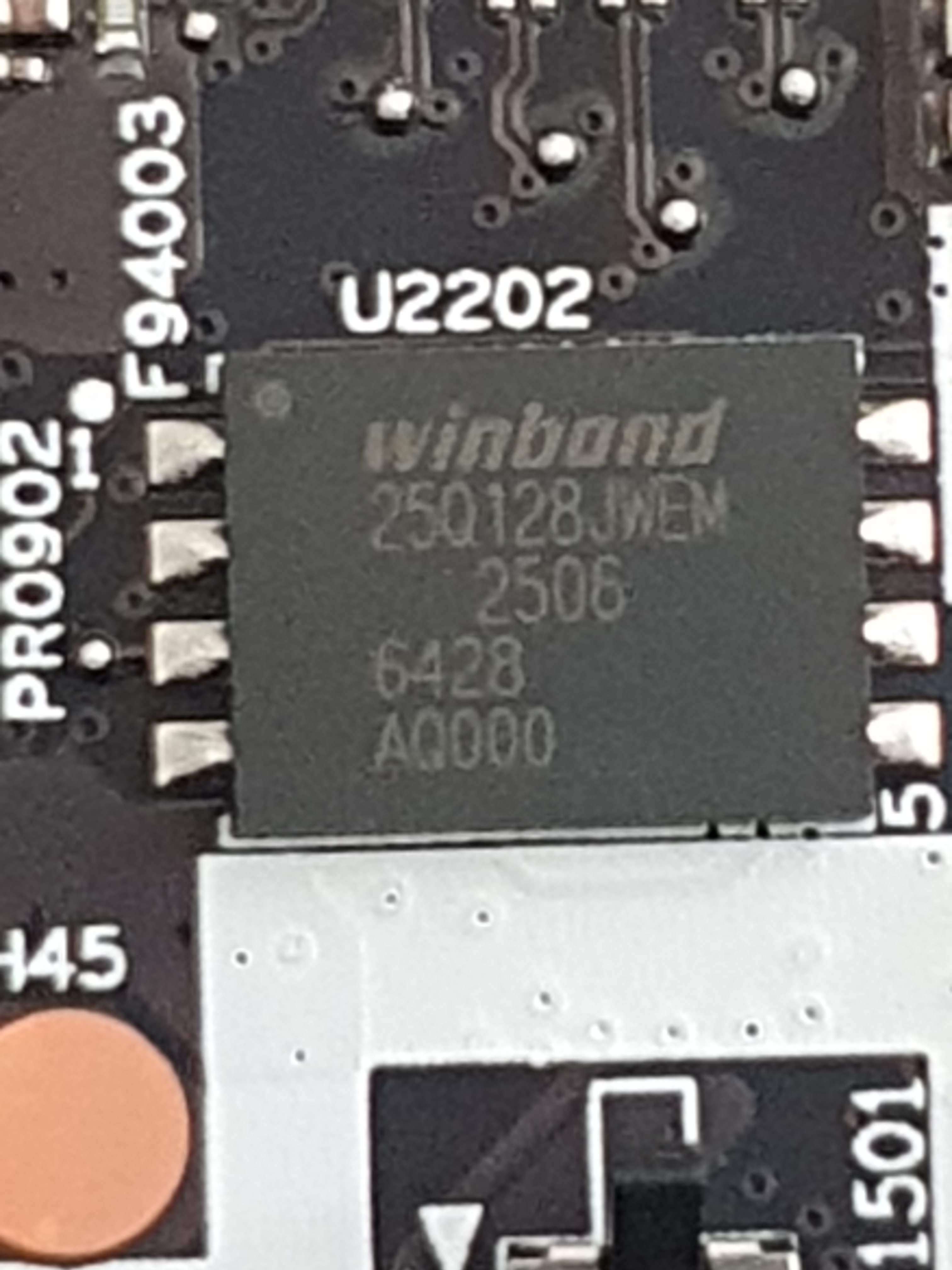

        how to read this model chip without any expensive tools i have some Ez and ch341 (black) will read ?also i have opened backside now, is the chip near i/o thinkshield the 8legs?
          The bios chip must be unsoldered from the board before writing or reading..
          do not use the clip, you may have errors..if you do not have anything to unsolder it with,
          solder wires between the programmer and the bios chip..
          you need an SPI programmer...here is a video for example..https://www.youtube.com/watch?v=DWWi...nnel=ThisIsHow

            okay im on it turned motherboard opposite to cpu and i read ThinkShield Mec17xx-CB02504cvp so which chip do i desolder for reading with ch341
            Last edited by Ashi; 09-12-2025, 08:58 AM. Reason: noticed on the upperside this chip winbond see picture attached if relevant

              i figured out(with help from some friends and of course Badcaps here need Mec1723 chip renew /read/write to save this lappie, thanks for the help, appreciated
