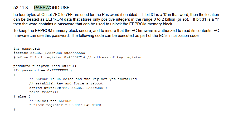

                                • ahmedalzenk
                                  • Oct 2019
                                  • 9
                                  • Deutschland
                                  if u see the data sheet , we are able to unlock the pass , i think we just have to read it and set the Adress 0x40002c10 of 0xff , then we have unlocked the pass , i have i jtag at work , i try to read it with it then i give feedback

                                    • sergei66666
                                      • Mar 2022
                                      • 17
                                      • Russia
                                      If it works via JTAG, that would be great. If I understand correctly, some have already tried, but it didn't work.
                                      If it doesn't work, then there are only two options (in my opinion):
                                      1) easier - replace the EC chip
                                      2) more difficult - edit the EC firmware so that it clears the memory block with the password. However, I don't know if the firmware is signed. It's possible that the modified firmware won't even start.
