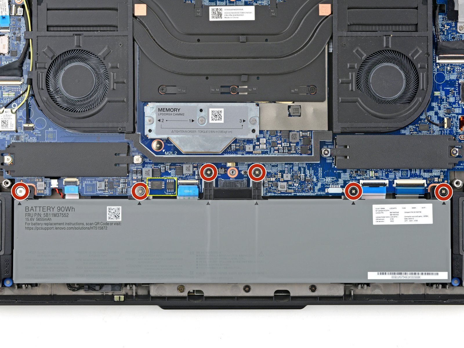

    Hi FORUM!
    I have a laptop Lenovo Thinkpad P1 Gen 7 with no sings of life.
    I checked EC external flash and it is empty FF.
    So i`m looking for this dump or from similar.
    EC is Nuvoton npck397
    MODEL 21kws05p0F

    Must be a 16mb dump file.

          • volinakis
            • Jan 2021
            • 2728
            • N/A
            I think bios is split into 2 chipsets, post a clear picture of region marked in yellow square. Read also 2nd chipset and post it here.

              does your programmer have support for the npck397 chip, which programmer is it, what is the full chip part number
              • akhtian
                • Oct 2022
                • 20
                • Ukraine
                It is empty. Only FF here.
                • volinakis
                  • Jan 2021
                  • 2728
                  • N/A
                  I asked for pic and 2nd bios chipset, it's FF because you read it wrong or erased before reading. If you want help do what I asked, having 2nd bios content I can figure out what's missing from empty chipset and rebuild it from update.
