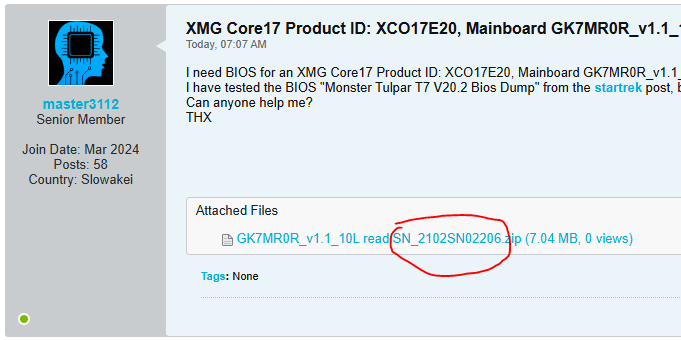

    Please post the laptop serial number, SNID or service tag with EVERY bios request ! It Must be Typed, not posted as a picture or part of the file name -> https://www.badcaps.net/forum/troubl...before-posting

      ​I have posted the SN, this is in the filename.

        Can you just respect the forum rules and Type the serial number. Also can you answer the question, What GPU does yours have ?

          Dear friend. I respect the forum rules. I typed the serial number in my first post. See picture. This is in the name of the BIOS file.
          SN: 2102SN02206

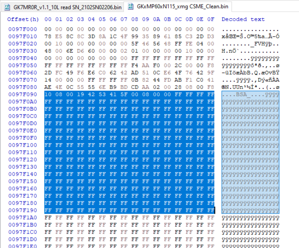

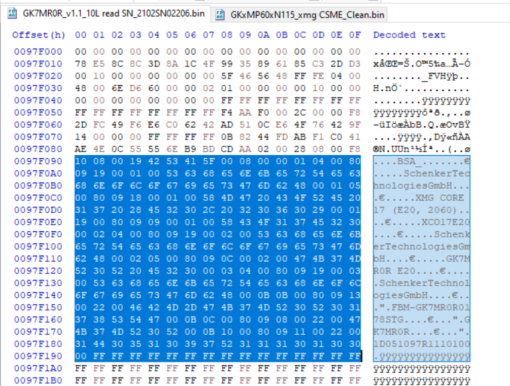

            Try this bios, it has the new bios region merged. There is no DMI in the bios, it must be in the EC. If the laptop boots up OK, run the attached oemsevtool ,there`s a Text file in the folder that explains why you should run it.
              I think this is the DMI block. It looks like Samsung.
              all donations are welcome,
                • 22279
                I think you`re right my friend, i missed that. I don`t know what this is though, it`s not the serial number 1D051097R1110100 ? .Anyway, i`ve added it and edited my post with the new attachment.
                  It's my first time to work on XMG BIOS and I didn't find any website to check for the Serial Number. But I found the Model Number and ID there, so I though it's the DMI block. Also Samsung use the same keyword (BSA) for the DMI block.

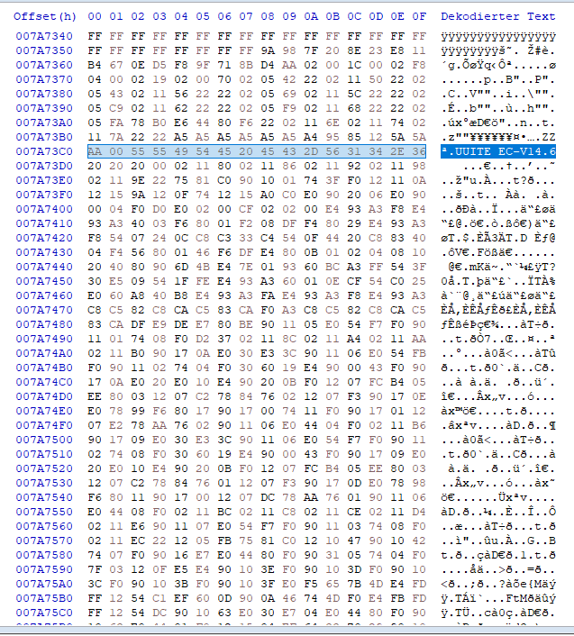

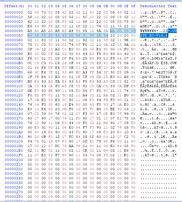

                    I have updated the BIOS. The behavior is the same, the device doesn´t start. The behavior gave me an idea. I have read out the EC, see picture. However, I can see in the HEX editor that only the first few bits are present in the file and the rest is empty. I don't know what such a file should look like, but that seems a bit too little to me. I have read that the EC content is also present in the BIOS file. I also opened the BIOS file and searched for the content (ITE EC-V14.6) of my EC. I found the same content at address 007A73C0. There seems to be a lot more data from this address onwards. Could it be that the content of my EC is incorrect? If so, in which address range in the BIOS file is the content of the EC? Can I take it and program my EC with it? Left EC right BIOS image

                      If you search for All instances of "ITE EC-V14.6" youll see more. The EC will update itself at first boot from the bios.

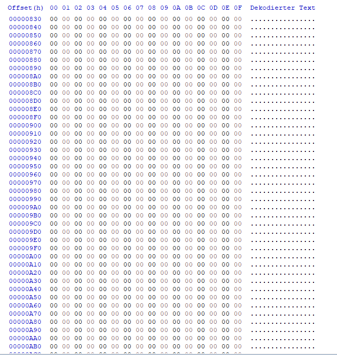

                        When I open the EC file that was read out, I only see what is on this Click image for larger version

ID:	3645731 picture, except for the beginning. I have already started the device, so the contents of the EC should already have been updated, or am I seeing it wrong? Can I delete the EC and then see if it is updated?

                          Yes, go ahead and try

                            I deleted the EC. After that, it no longer responded to pressing the power button. I read out the EC again and it was empty. The EC was not reprogrammed by the BIOS. I was also able to restore the contents of the EC. How can I check whether the EC is communicating with the BIOS chip? I was only able to measure voltages on the BIOS chip. Unfortunately I can't do anything with the values.
