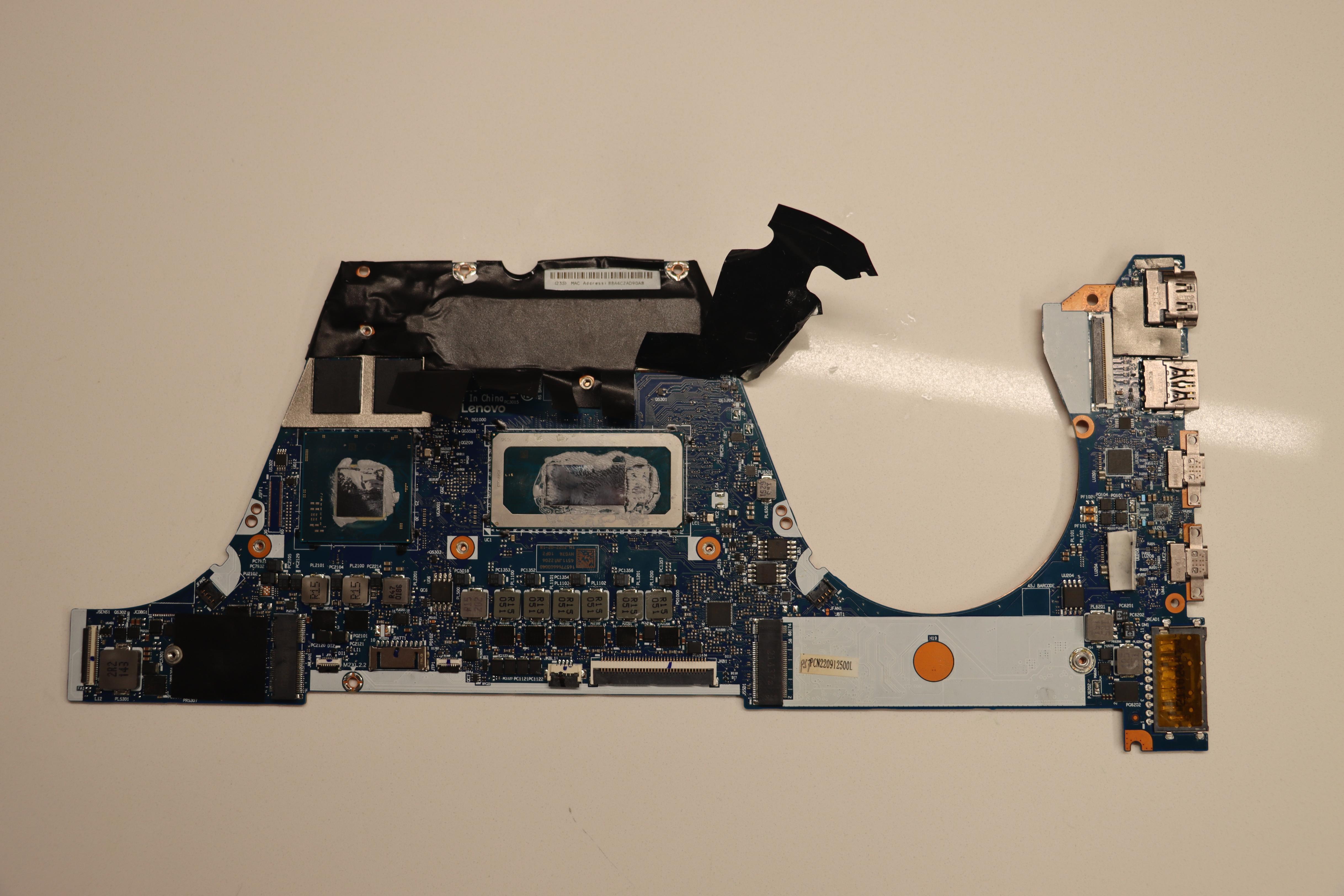

    Hello everyone, looking for bios for a Lenovo Slim Pro 7 14ARP8
    its non booting, power button blinks lenovo
    S/N YX063148
    I made a dump of the bios here

      thank you, unfortunately still no boot after flashing,same 3 sec blinking power button, suspecting it might be hardware issue

          Tried this as wee, no change. I'm suspecting its hardware related

            I have the same problem; were you able to fix it?

              Mine was a hardware problem, had to replace an ic

                Thank you for your reply. I have the same problem, I replaced the motherboard which worked for few days, then I got the very same problem, then I swapped the daughterboard but that didn't help. Would you be able to share which IC was the problem? Here's a high res picture of the motherboard.
