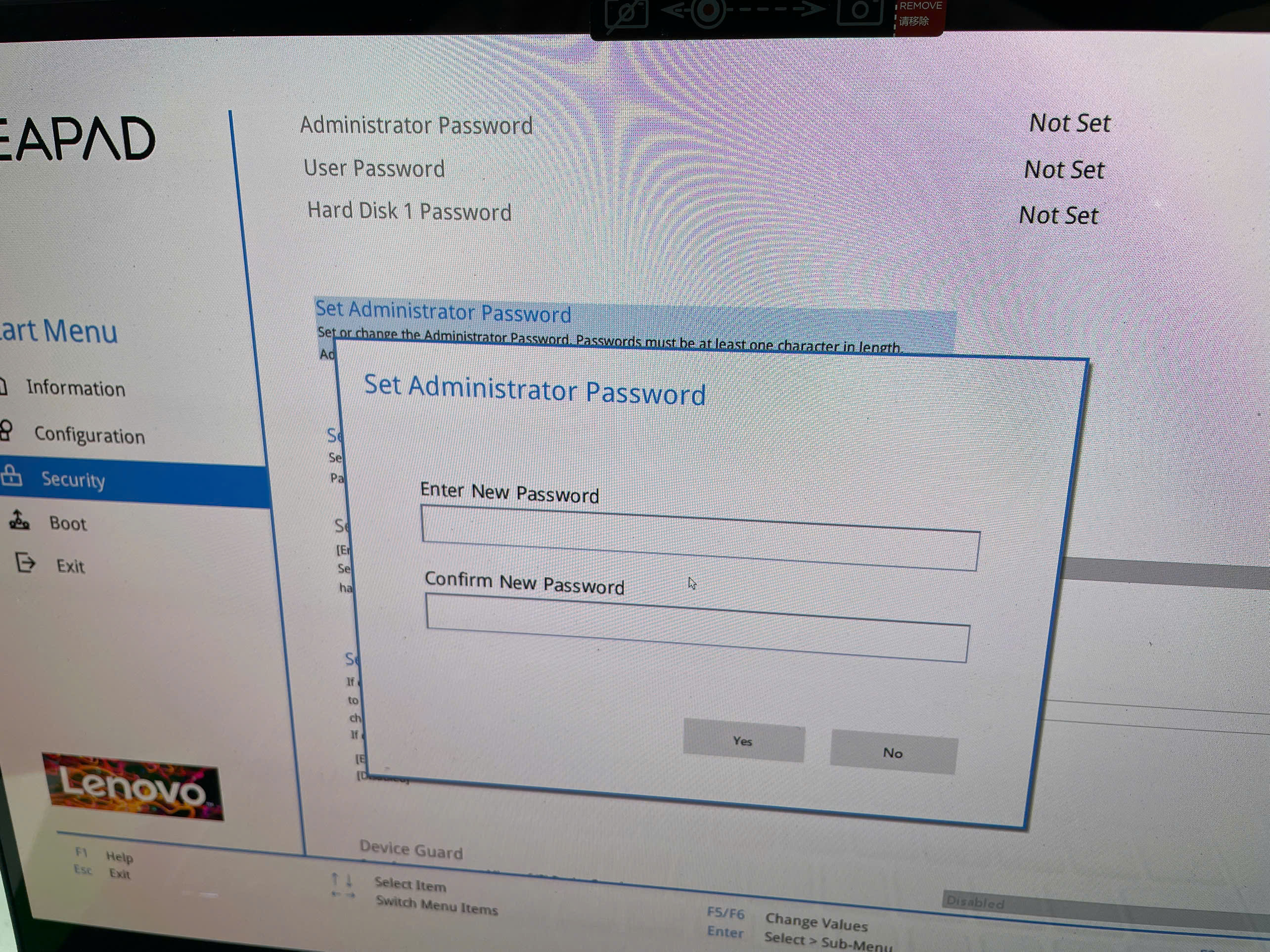

ideapad 5 2 in 1 14Q8x9 bios password
  • black0hackers
    • Jul 2020
    • 365
    can some one help me remove bios password on this model
    model : ideapad 5 2 in 1 14Q8x9
    serial: YX0EB63S
    board code: nb6920a_mb_v4
    cpu: Snapdragon® X Plus X1P42100

    post the name of the bios chip...

      MX66L51235F@WSON8 8X6 1.8v

        What programmer are you using?...

          svod 4

            ok ... the bios is longer and it's also strange.. I'm not sure if it's copied correctly from the chip.. I couldn't find the bios for this model on the Lenovo website, according to the S/N you posted.. the bios can be longer than 32MB on this chip, depending on the configuration, if I'm not mistaken... now I'm thinking that if we go through the content and don't have a correct copy, when you put the content back the laptop won't work at all... the programmer is ok.. make some more copies and check them with the HxD program and see if they're identical... but maybe someone else knows more about this bios....

              100% sure bios is fully read and ok. i program back to bios ic and put back to mainboard it working

                ok try this ...

                  no display on

                    Send to you, try !!

                      hi. i have try it . logo on then off

                        i mod file in attach, now can login main bios. can type the password but if save and restart laptop login again to bios it no ask password
