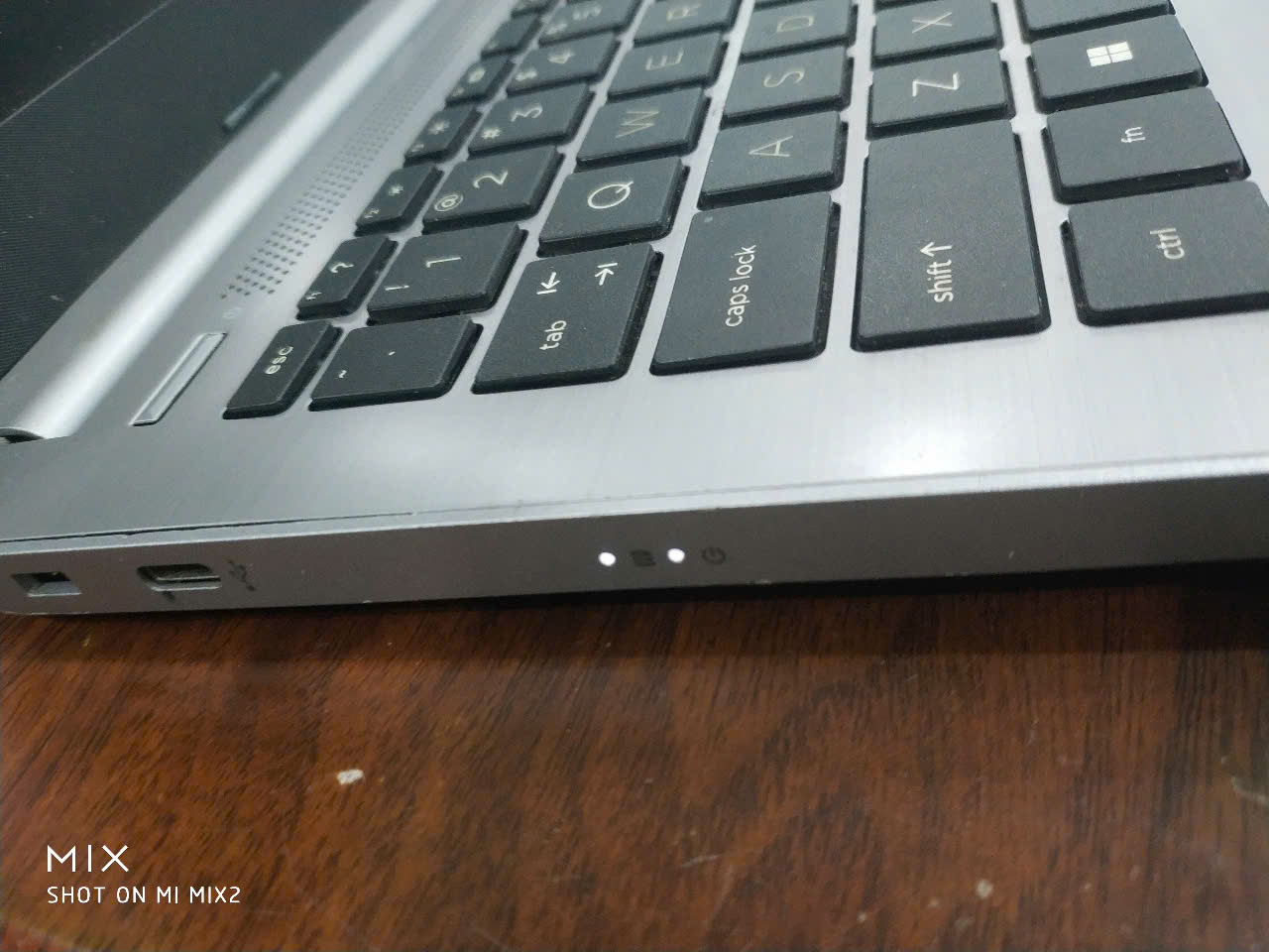

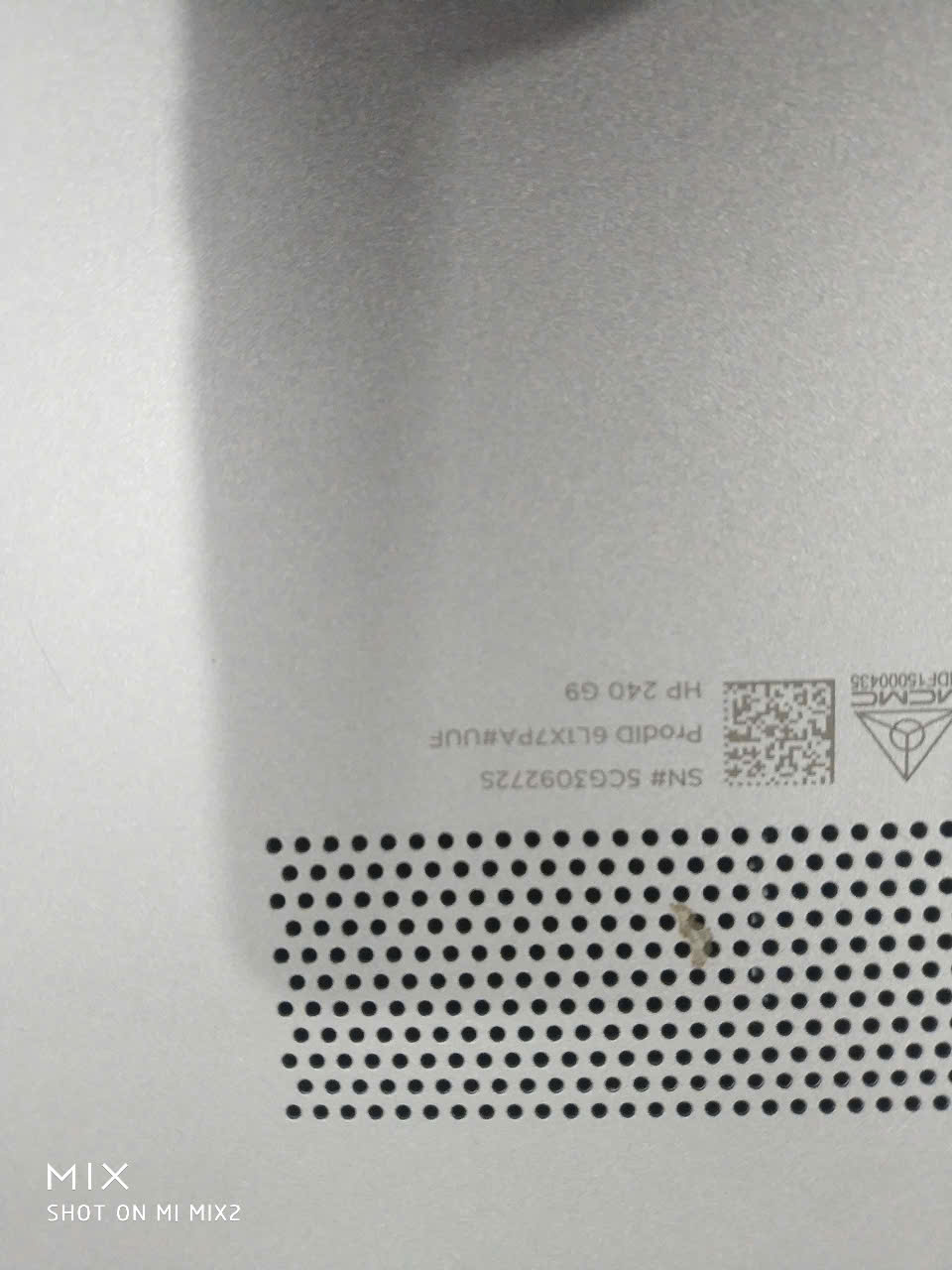

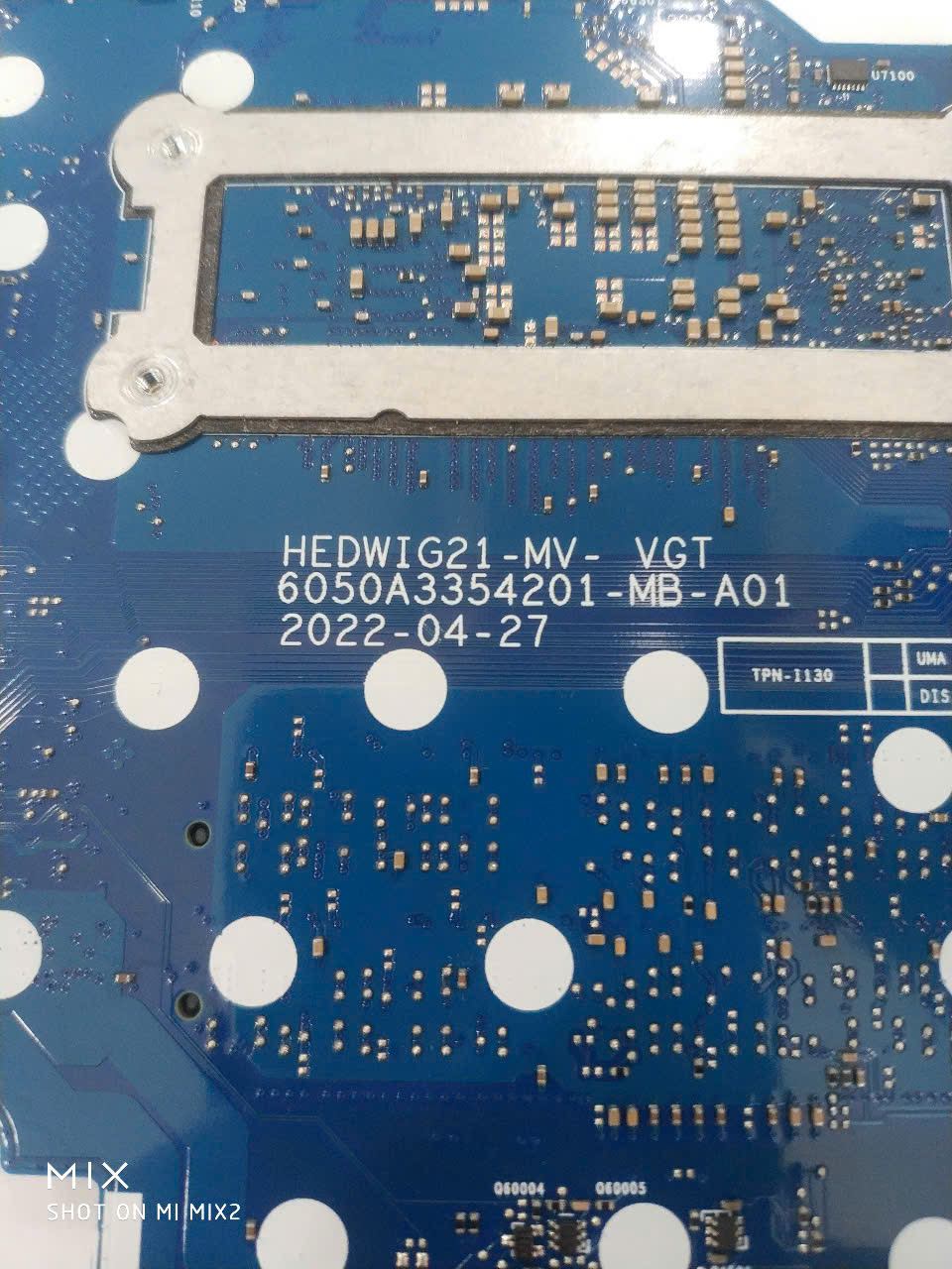

      Hello my friend. Sorry, I had some personal matters so I replied to your message late.
      This is what you asked for ( pictures ) and bios read from chip.
      Error description​: After pressing the power button, the power LED is on, the HDD LED is on.but the screen does not turn on, the caplock led does not light up when pressed.
      the power suply:
      pl60200 = 5v
      pl6970 = 1,8v
      pl60400 = 2,5v
      pl60300 = 1,2v ( for Ram )
      pl66410= 0v
      pl66120 and pl pl 66110 = 0,8v ( vcore )
      pl66610= 1,8v
      pl 60100=3v3
      please help me .
