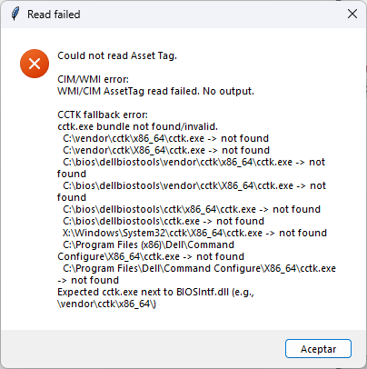

                              Windows defender gets triggered for some reason when downloading the .zip from Github...
                              If i download only the DellBiosTools.pyw and run it I get a different error, "Could not read asset tag" I don't have CCTK installed as I use an HP laptop, maybe that feature should be skipped when running on non Dell/Alienware PCs (Asset tag manager)
                              Pressing OK and the rest of the program seems to work fine

                                  The dellbiostool is for Dell devices not HP
                                  I have updated the python code to hopefully be compatible with Win11 updated security features so no errors when running the asset tag manager tab. Yes windows will unfortunately flag the zip if you do not exclude the folder. You can just of course download the straight python file as well.
