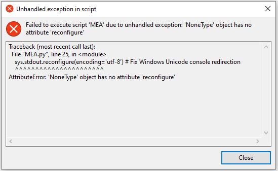

        • mOri
          • Jan 2014
          • 23

          i tried the steps you described but got an error
            don't use "Select Windows Based", select the other option. this worked for me

              Re: Create MEAnalyzer executable from Github Python Scripts
              Not sure about that error, as I don't see that on my system. Are you using Powershell or Command Console? I use the latter with admin rights.
              Edit: Ok I see the error occurs after you launch the EXE. This has started happening on the latest release r318 (r316 did not have this problem). Can confirm using console based during exe creation solves the problem.

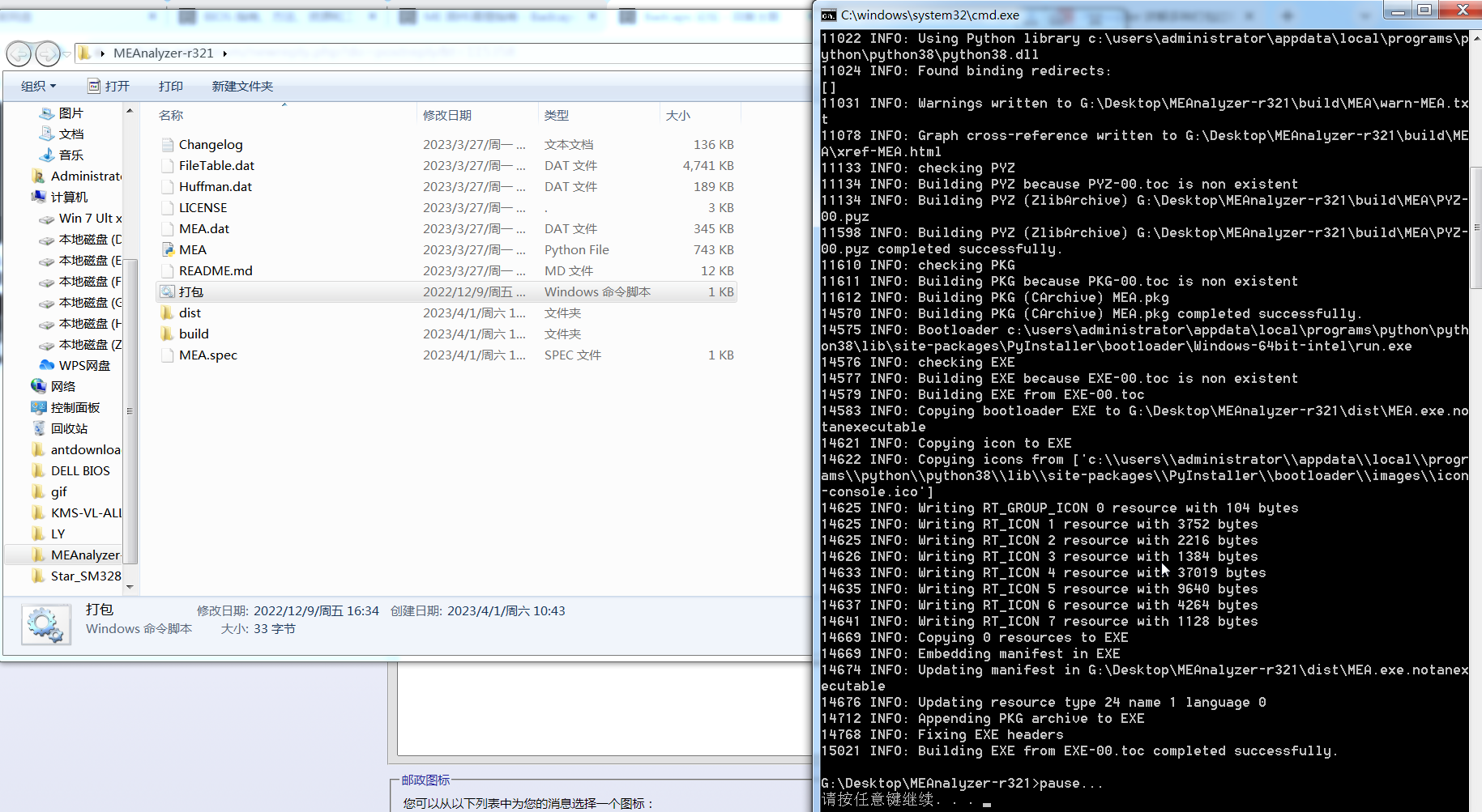

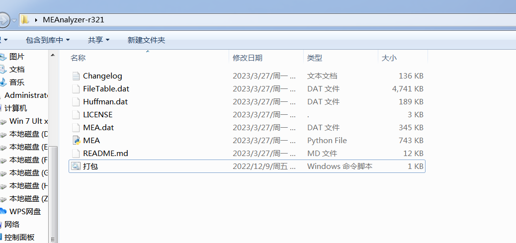

                            • kingthink
                              • Nov 2022
                              • 19
                              • China
                              1、Install Pyinstaller, use the following command to install(win10)
                              pip install pyinstaller
                              2、Place "package.bat" and the downloaded file in the same directory
                              3、Run "package.bat”
                              The generated EXE files are placed in the dist directory. Place the DAT file in the same directory as the generated EXE file

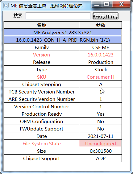

                              • f!ne
                                • Mar 2023
                                • 3
                                • Spain
                                Thanks, worked like a charm. I chose "Console based" just to be sure.

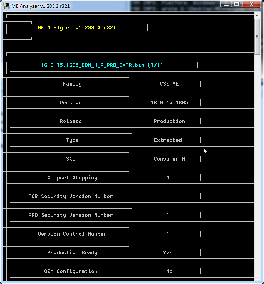

                                      • lbslakmal
                                        • Jan 2013
                                        • 48
                                        • sri lanka
                                        Thank you very much....Its work with "console base" option
