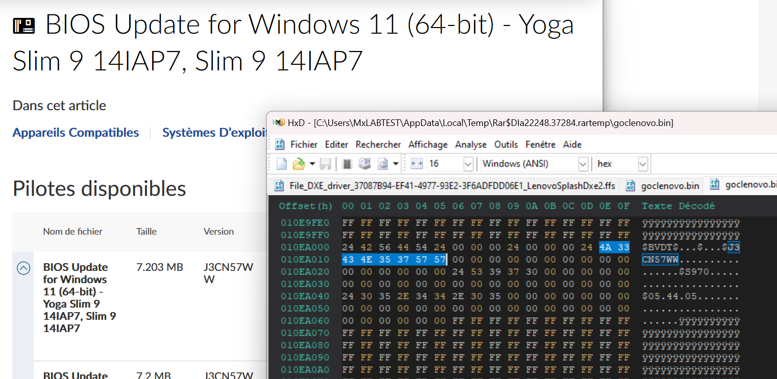

LENOVO NM-E291 REV0.2 Update bios error
  • doivaythoiem
    • Jun 2024
    • 126
    • Việt Nam
    Need help bios
    LENOVO NM-E291 REV0.2 UPDATE BIOS ERRO
    SN not found because it was deleted
    original bios
    • 22084
    Originally posted by doivaythoiem
    Need help bios
    original bios
    Post the full laptop model number and model type
    • doivaythoiem
      • Jun 2024
      • 126
      • Việt Nam
      I don't have it because the information was deleted on the D side of the laptop.
      but i have PN 5BWDC00003 (ON MAINBOARD)
      • Maxpower3
        Bad Veteran
        • Feb 2018
        • 1356
        • France
        • doivaythoiem
          • Jun 2024
          • 126
          • Việt Nam
          Yoga Slim 9 14IAP7 - Type 82T0
