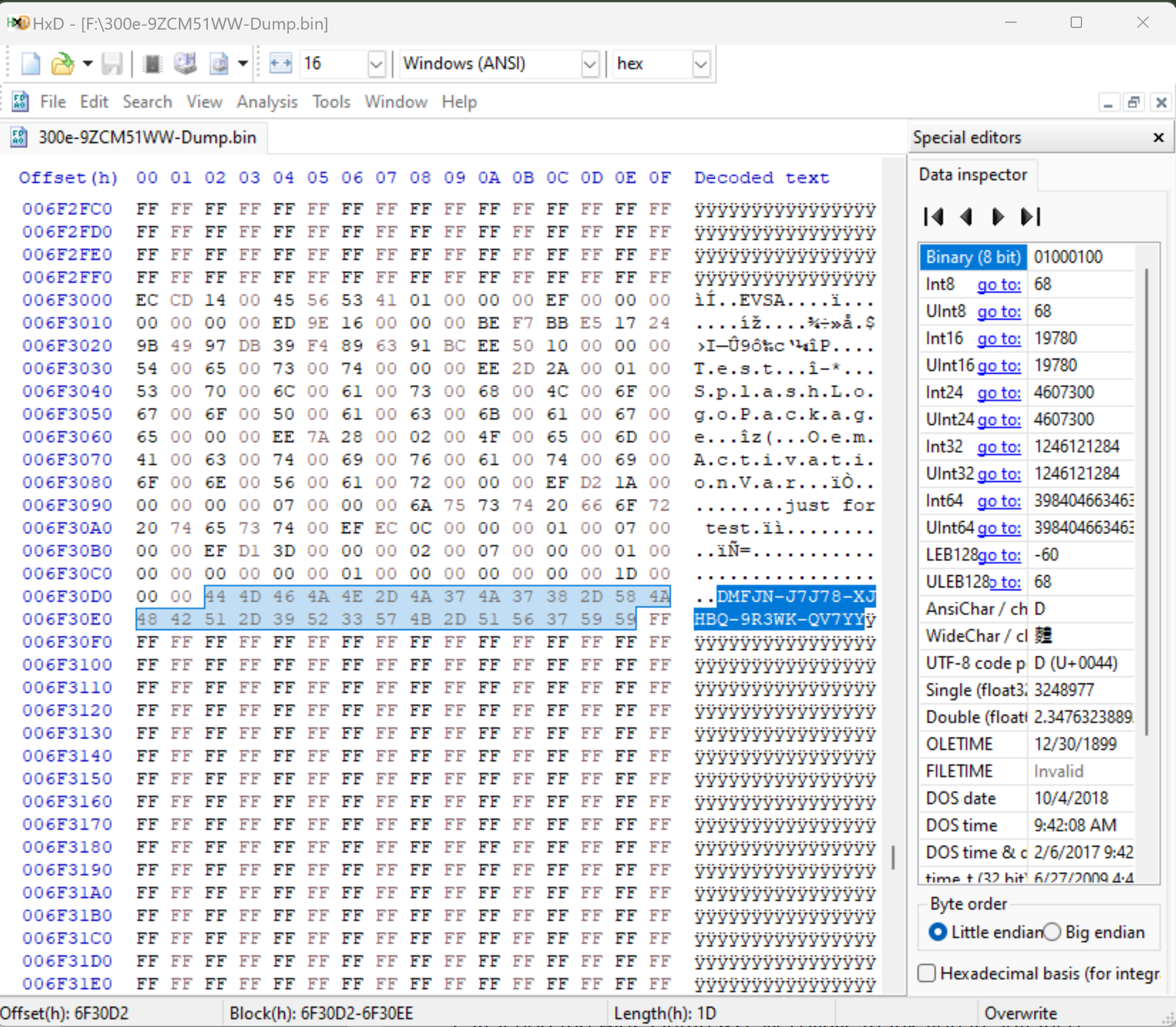

          Here
          Click image for larger version  Name:	2025-02-15 06_20_03-HxD - [F__300e-9ZCM51WW-Dump.bin].png Views:	0 Size:	1.45 MB ID:	3571971

            Originally posted by hoaca388
            Here
            Well, but i’m talking about OA3 KEY ID value that is missing from the bios settings. And this is why i am talking about a tool so i can inject it manually
