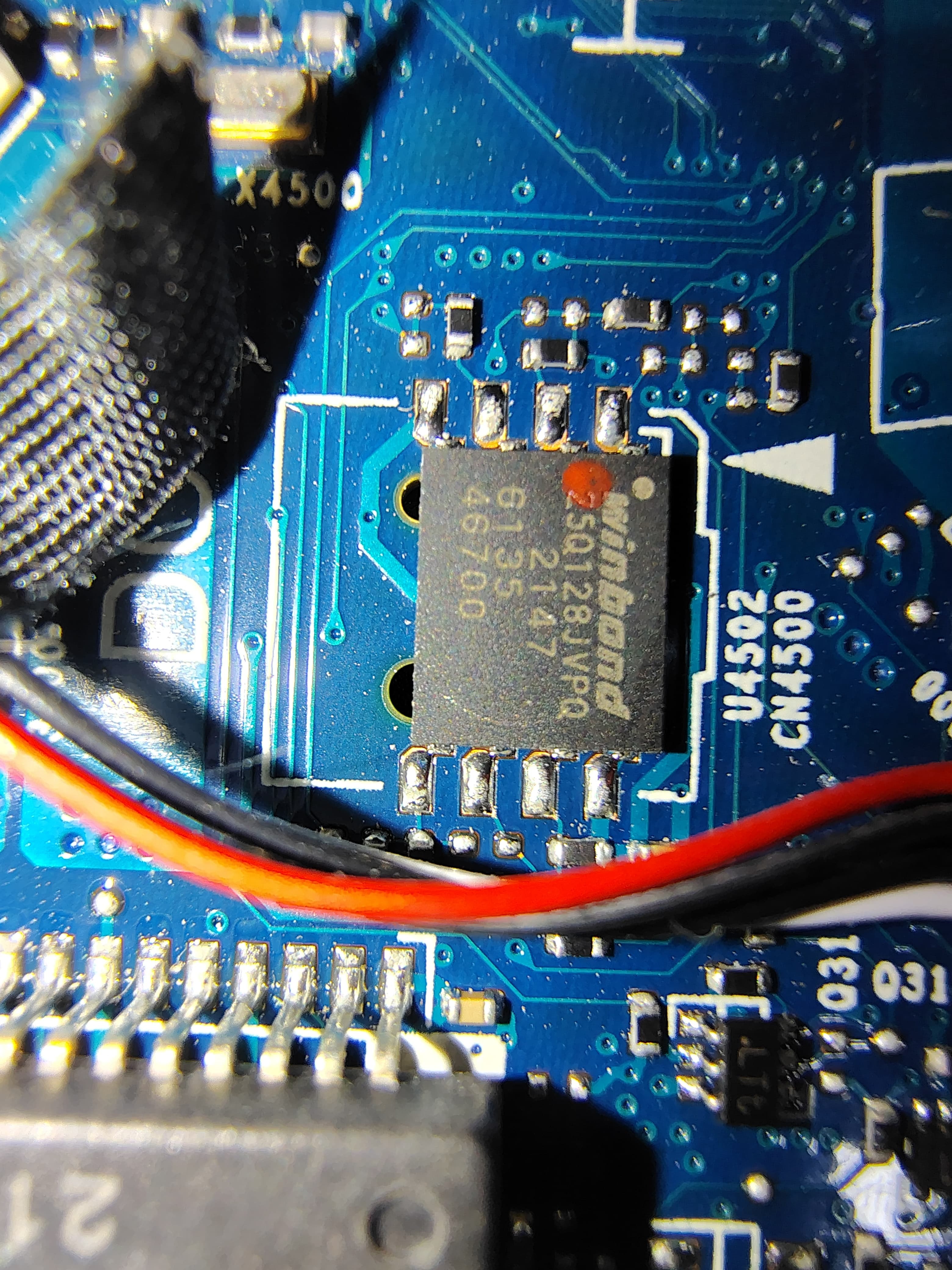

    Looked up in the forum and cant find a compatible version to my BIOS PWD locked on power on.
    Tried several but there are little dif and they cant detect nvme storage because there are 246 g8 or similar but no my model.
    I leave a dump of my original bios file, thanks in advance if anyone can help
    HP 240 G8
    SN: 5CG1513SD3
    BOARD: HEDWIG02-6050A3285801 -MB-A01(A1)

      Originally posted by hoaca388
      HP 240 G8 Notebook PC (5T9J9LT)
      Thanks its working
      Was looking for how to add dmi throught HxD
      And find out where was stored the BIOS PWD
      If anyone has this problem in the future go to 00802000 and select from 00802000 to 00802030 and and fill all with FFFF (ÿÿÿÿ)
      Hope helps somebody, and thanks to hoaca388!!!
