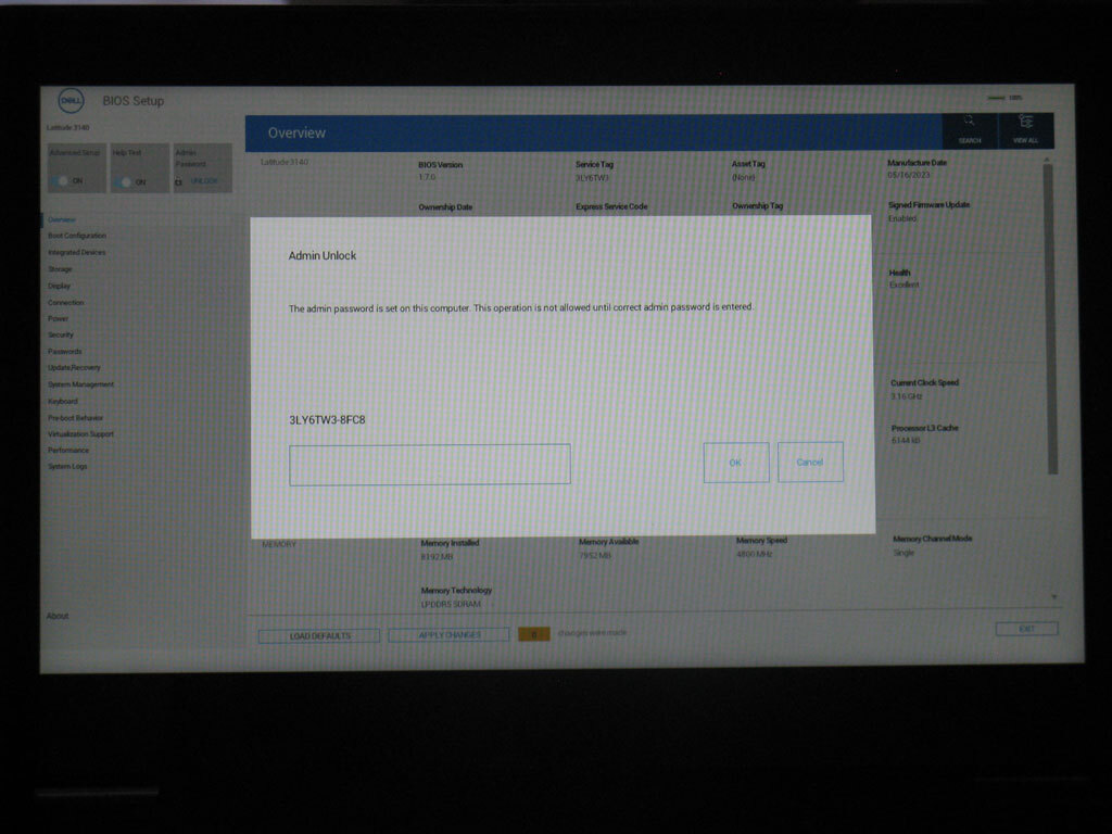

    Hoping I can get 8FC8 unlock help on this thread since I cannot find an open one for a Dell Latitude 3140.
    Service Tag 3LY6TW3-8FC8
    MOBO LA-M501P
    I've tried reprogramming the 8-bit BIOS chip (GigaDevice 25R256EY) myself by searching for 00 FC AA / 00 FD AA but it's nowhere to be found so I'm turning to the badcaps experts.
    It is different from other Dell 8-bit BIOS chips I have unlocked before. 1) Size is 32774 KB, not 32768 KB; and 2) It compresses to a very small file (154 KB), not 11-12 KB as other 8-bit Dell chips. Can someone please tell me what I'm missing?
    154 KB dump attached. Thank you. Don​

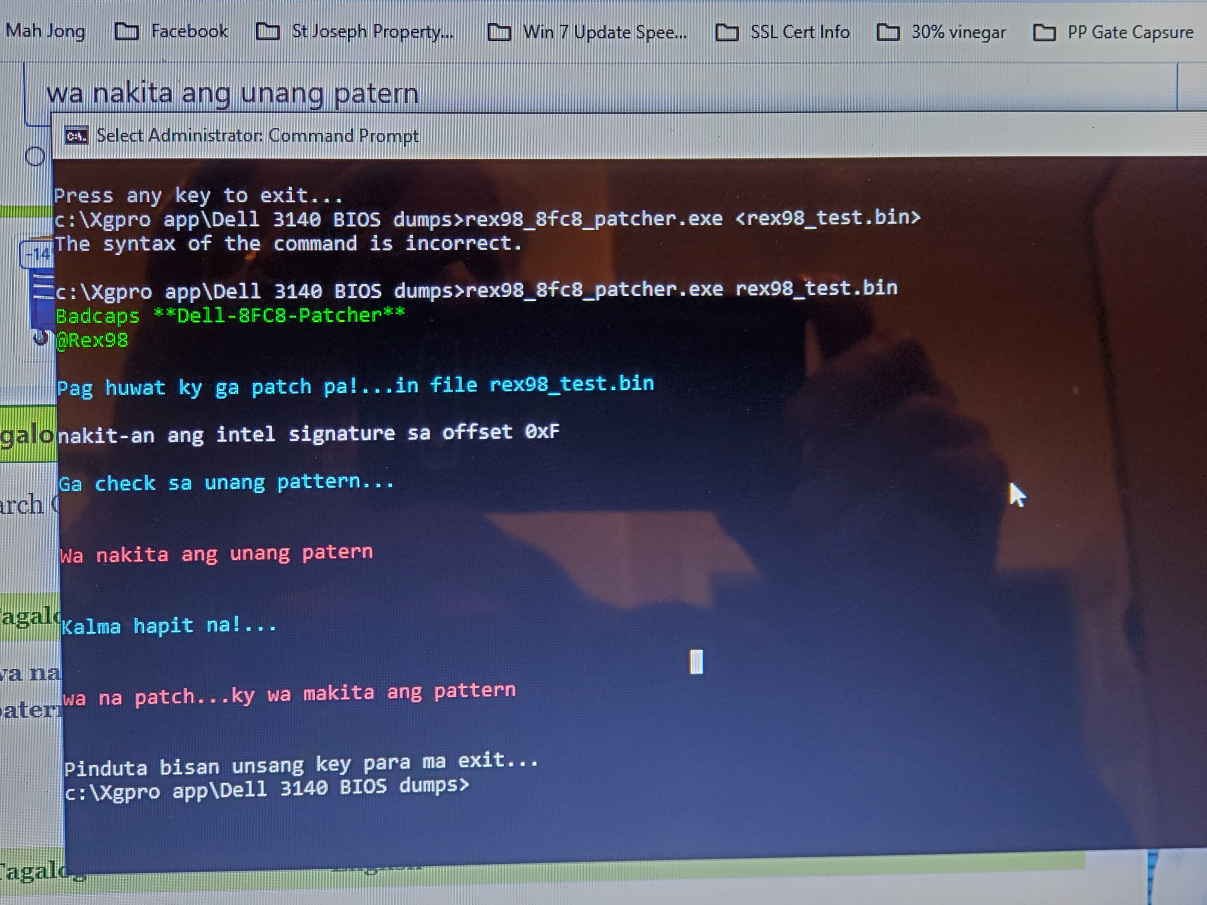

      https://www.badcaps.net/forum/troubl...l-8fc8-patcher
      • don166
        • 42
        Thank you rex98, but if your patcher just replaces 00 FC AA and 00 FD AA with 00 FC 00 and 00 FD 00, it won't work for me since I already know this BIOS does not contain either of these hex strings. I did run it and now I will go to a Philippine neighbor to translate the Tagalog text in the dos screen to English, which will probably says it could not find the unlock hex. You have helped me here in the past and I thank you again for you commitment at badcaps. Don
          it only works if it has bios password and only in main bios. i think you did it wrong since your bios uploaded is only in kb its obviously corrupted.

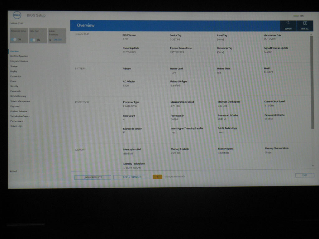

                        Pogo adapter, latest T48 software and this GD chip is not in the latest support list. And no, I don't have another programmer. The code might be gibberish but the laptop boots normally to BIOS and shows it's locked with an 8FC8 suffix. Searching on P/N GD25R256EYIG I found a site that seemed to suggest that expensive BeeHive or BeeProg devices are the only programmers that support this GD P/N. Is it possible a similar 8-bit T48-supported GD chip might be close enough to try? Thank for trying to help. Don ​

                        GigaDevice - GD25R256E [SOP16] is supported by Elnec device programmers.
