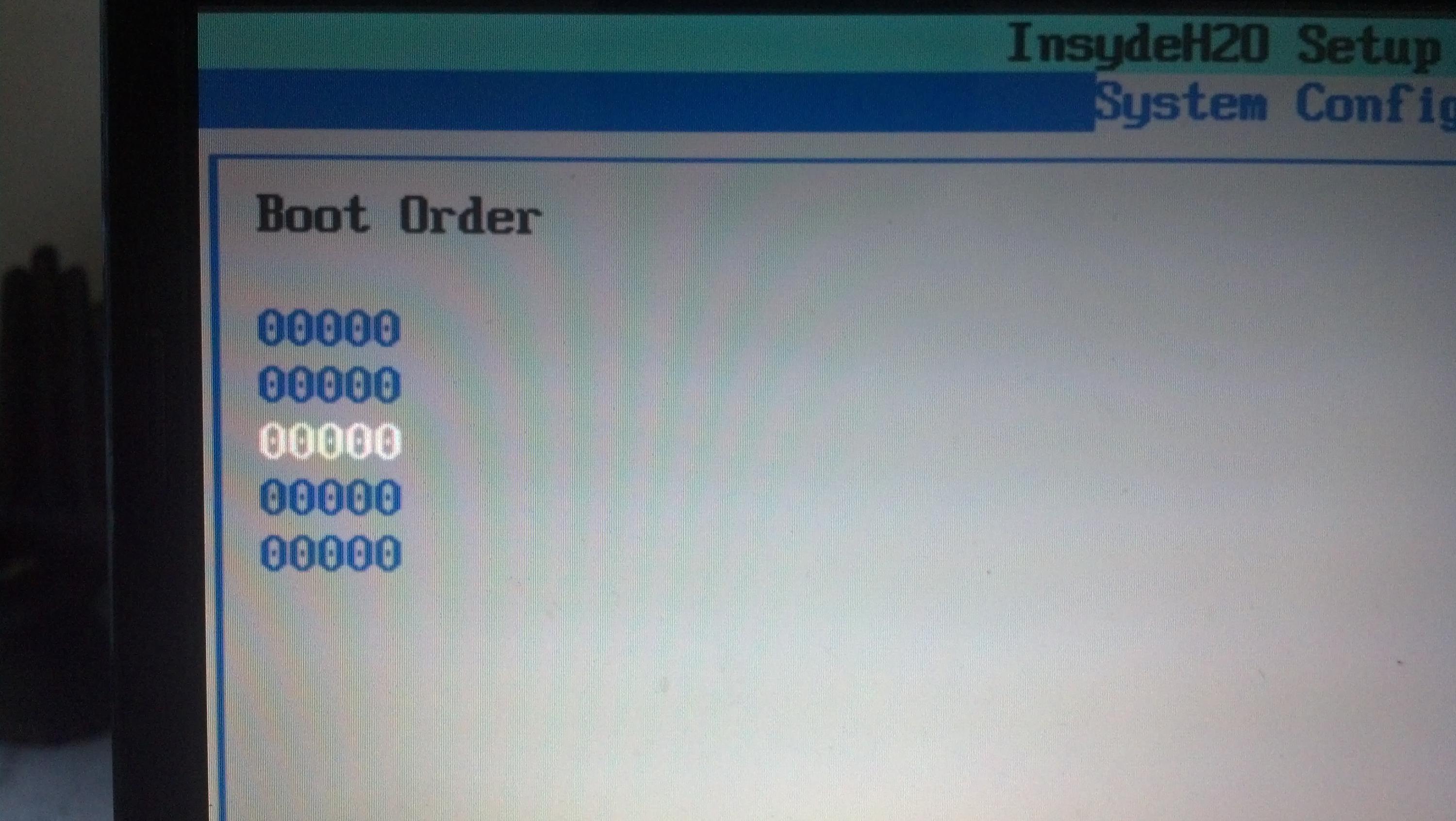

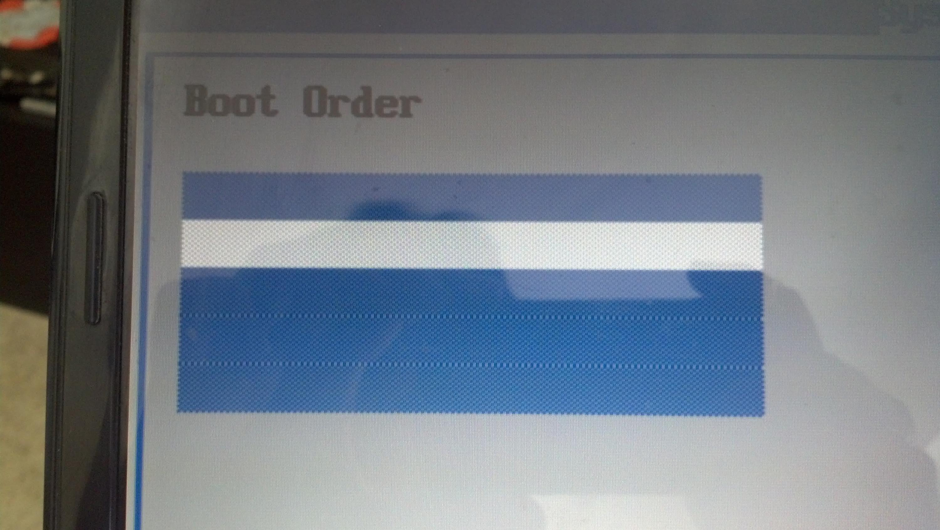

    Does anybody here encountered weird boot menu option like this in DV5? I don't know if this is bios issue or what, I haven't disassembled the laptop yet. you can see two image, its from the same laptop. It alternates on every reboot. Does not boot to windows. Any ideas?
    Re: HP DV5-1118CA weird bios boot menu
    a few reboots shows other images on boot menu. I wonder what caused this...
      Failing Northbridge would be my bet.

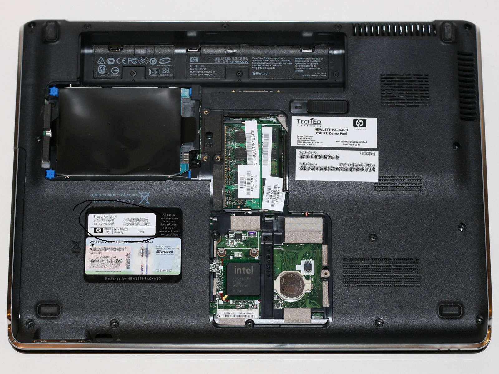

                I have already downloaded a DMI tool. I attach file. Do you know where I can find GUID and PCID number? I can't find it on the case.
                  under the battery?
                    thats the problem there's nothing under the battery besides the input voltage and battery model.
                      sorry forgot to attach file
                        if there is no serial nr there then someone took it of .
                        you know why!
                          I've got those numbers already. I'm looking for the GUID and PCID. or maybe I'm mistook it for a different number. by the way your image shows exactly whats underneath my dv5
