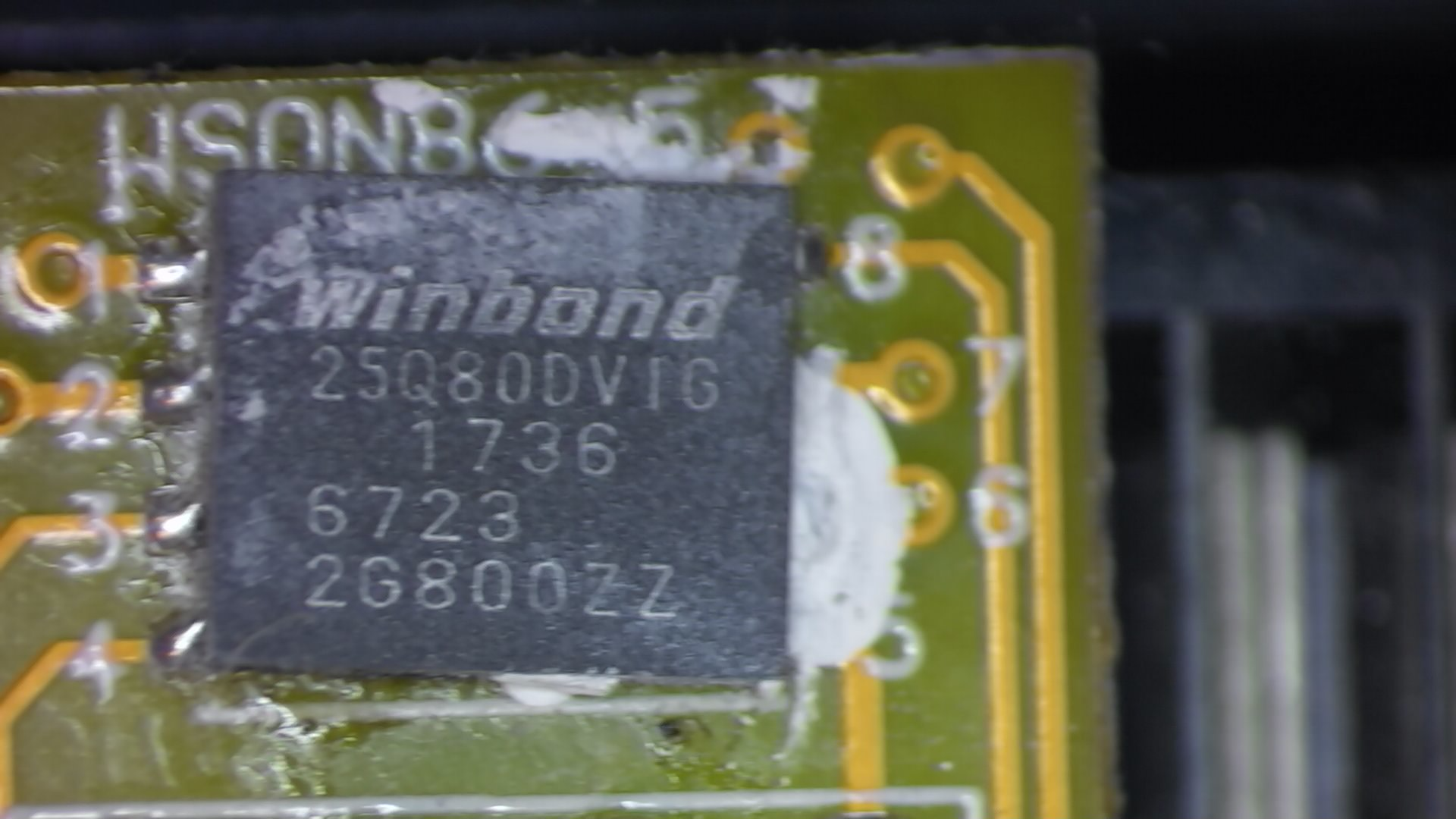

      Here is the dumped bin file.
        Wrong chip.
        If :
        Bios 8MB, choose chip with number 64, for example: 25Q64VDS...
        Bios 16MB , choose chip with number 128 , for example : 25Q128VDS...
        Bios 32MB , choose chip with number 256 , for example : 25Q256VDS...

          The file I dumped was made with the chip winbound 25Q80DV @WSON8 selected in xgpro. I added a picture below of the IC itself and the markings on it. The only other option I have for this IC is 25Q80DV(OTP) @WSON8. All the other ones that are close are soic8/16.
          This is the bios chip that was pulled off the motherboard for the hp laptop I'm looking for a bios for.​

            If the chip I have selected is not the correct one which one should I use based on the part number of the chip that is in the laptop?
              It's not a bios chip.
