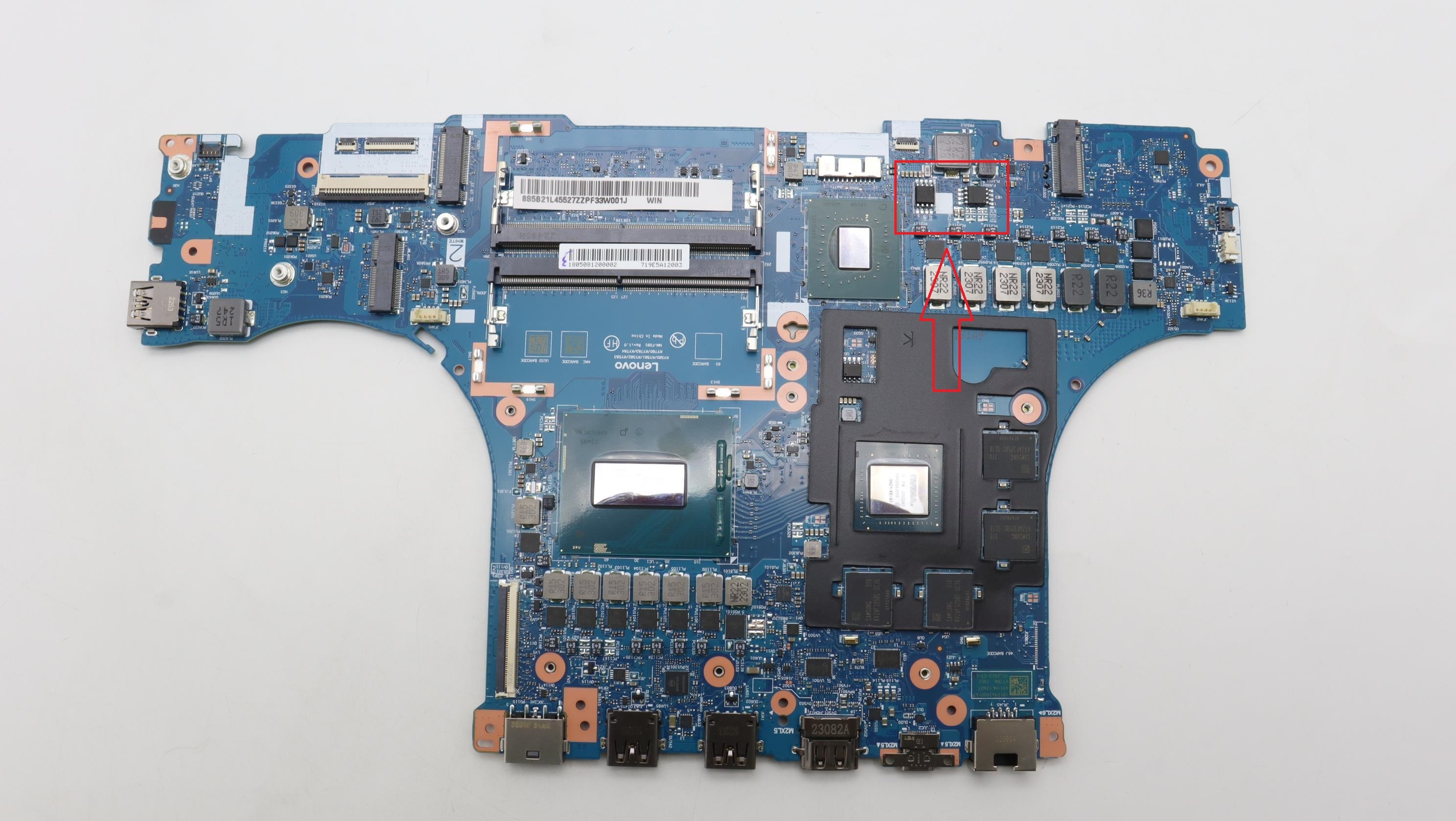

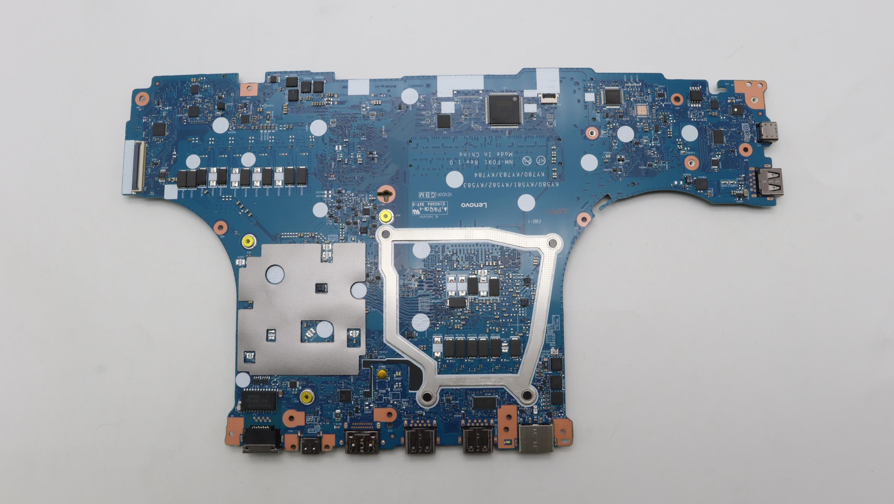

        Trying to fix a BIOS corruption issue on a Lenovo Legion Pro 7 16IRX8. The motherboard model number is 5B21L45527. First of all, can folks confirm which chips need to be dumped? Images of the top and bottom of the board are attached.

        there is 2 bios chip read it

          post S/N, full name and model, motherboard model, TYPE,etc.

            Lenovo Legion 7 Pro 16IRX8.
            MTM: 82WR0000US
            S/N: PF48QSDX
            1st BIOS chip: XMC 25RH64CHIO (used XM25RH64C in Neoprogrammer), second chip XMC 25QH128IO (detected as XM25QH128C in Neoprogrammer)
            Chips have been dumped with CH341a (w/ 3v mod) using Neoprogrammer with chips soldered directly to CH341a. A test clip was not used. But I believe the person who looked at it initially did try to program it using a test clip so it's quite possible the chips could already corrupted.
