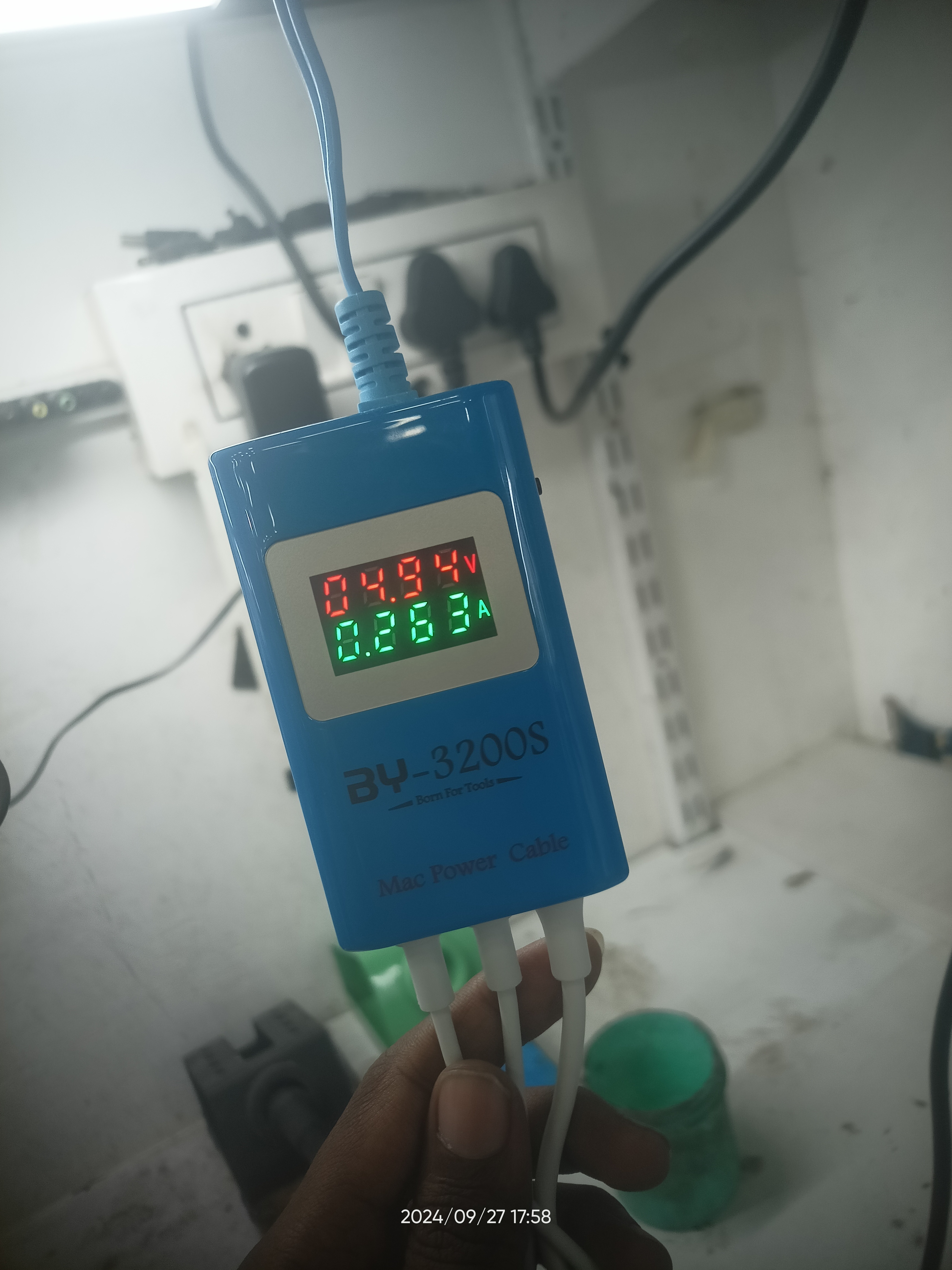

    macboo pro a2251 820-01949 no power
    i have a macboo pro a2251 no power stuck at 5v i checked no short in big coil some measure volt
    PPBUS_G3H=12v
    PP3V3_G3H=3.3v
    PP3V3_UPC_X_LDO=3.3v
    PPDCIN_G3H=5v
    PP1V8_SLPS2R=1.8v
    anyone suggest me what i check
