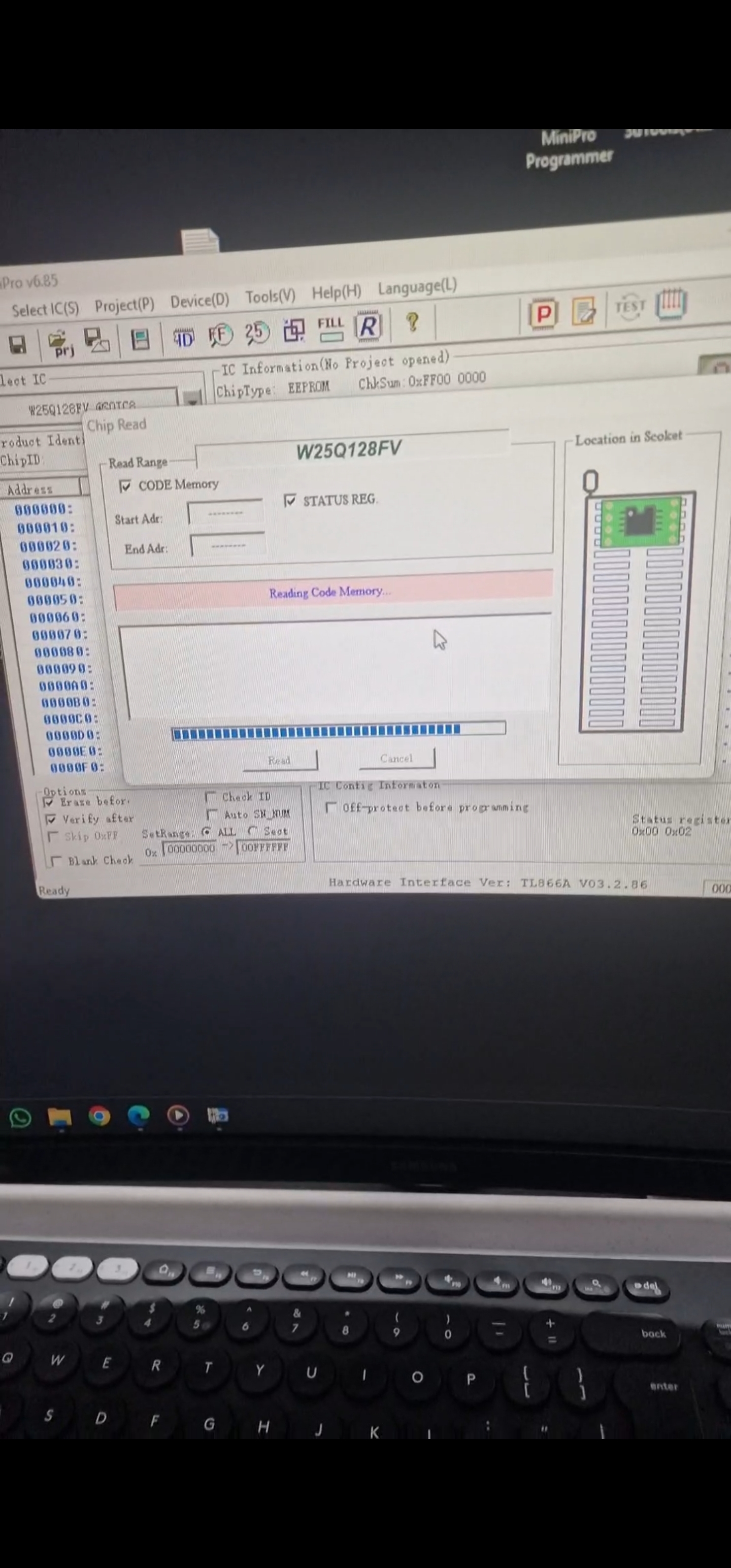

                                  Hello,i do it but still no display and no keyboard light, any other sugestion? I put a pictures with the compatiblity chip code, in my programator i don't have XM25 chip code and i write with w125Q128, i am wrong? Thnks
                                  • peste
                                    • Dec 2016
                                    • 13661
                                    • ROMANIA
                                    what did you do!!!! you have to write the chip not read it, this picture shows....at station #2 you have two chips..write on both...
