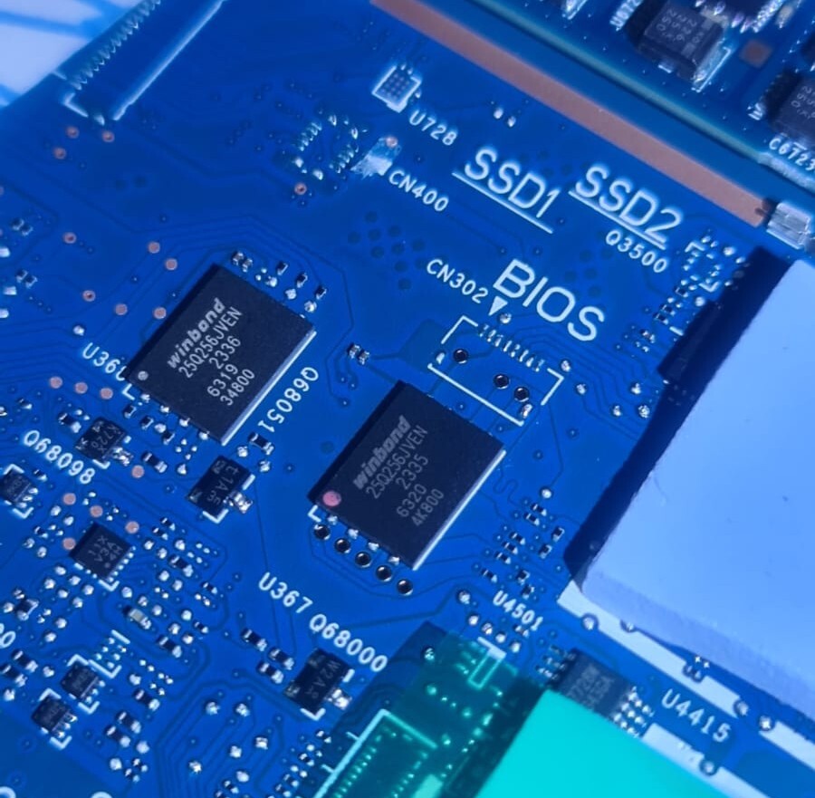

          Hi my friends, please help unlock/remove Bios password, THX!!!!
          Product Name : HP ZBook Fury 16 G10 Mobile Workstation PC
          Serial Number: 5CG4090ZSN
          ProdID: 97W26EC#ABM

              Originally posted by Stefan Steff
              Try this patched file and if the password still present you need to read the EC chip (look on the other side of MB...probably a 16Mb chip...))
              Hi, i already flashed the MAIN bios with both unlocked files with no luck, when i turn on the computer appears a message that the bios is updating, when it finishes and enters the bios is still locked by password.
              I guess I took the wrong bios chip (both chips MAIN and EC are the same model "W25Q256JV") so here I attach the second bios file (EC Bios chip), I hope you can help me unlocking it. Thanks in advace!

                #29

                Here are both chips that I desolder. I think one is the MAIN chip that corresponds to the first file I uploaded (right side) and the EC chip is the one in the left.
                  1st thing use BCU (BiosConfigUtility)with your original bios+EC to read your DMI, using cmd line "biosconfigutility /get:1.txt" -you'll need to write back your DMI.
                  write both chipsets with files I upload. At 1st boot enter in bios setup with F10 and in MAIN tab reset to factory defaults. Wait for 2-3 mins, laptop will restart few times with no image.
                  Use again BCU to read again DMI ( "biosconfigutility /get:2.txt"), open 2.txt and fill empty fields with values from 1.txt (Product Name, Serial Number, SKU, BuildID, Feature Byte, System Board CT Number, CirrusSmartAmpCalibrationData, MAC adress). Move * from HP MPM to Lock. Save 2.txt in "documents" then move it back in BCU folder. Apply new settings using cmd line "biosconfigutility /set:2.txt". Restart.
