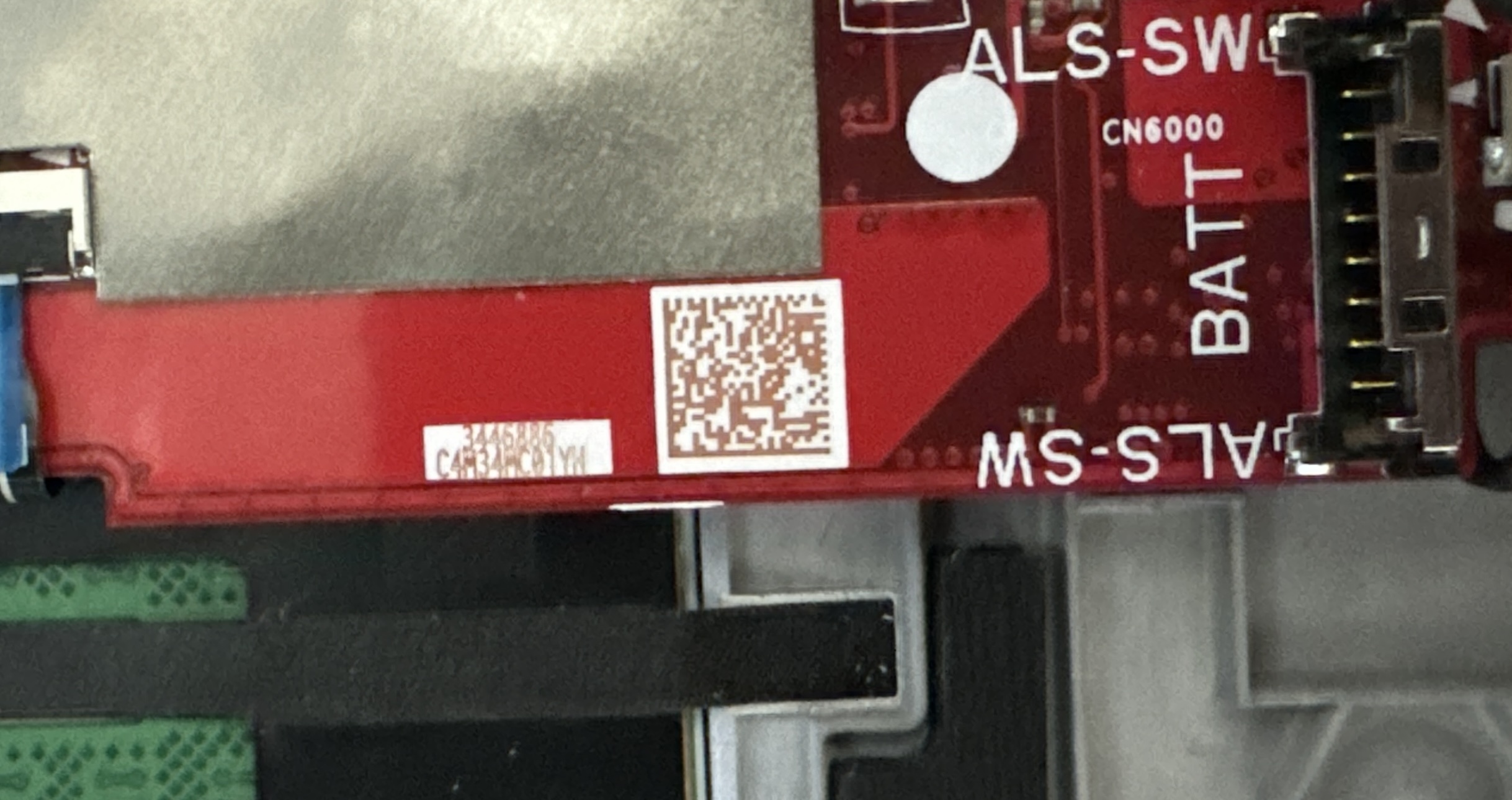

    Hello everyone I stupidly updated the bios on my Asus and it got corrupted.
    Can anyone edit the hex bios file for my device? My bios chip W25Q16JVSNIQ Winbond has a capacity of 16Mb but the bios file I downloaded on the Asus homepage is 32Mb. Can anyone help me edit the hex and adjust it for me so I can flash the bios, please?
    Thank you so much😥
    This is the original bios file from Asus website and motherboard number:
    model number: GA402XI-PMV-VGT
    6050A3447304-MB-A01​

    Click image for larger version  Name:	IMG_4024.jpg Views:	0 Size:	588.2 KB ID:	3297974This is a square white QR code on the motherboard

      motherboard number: GA402XI-PMV-VGT
        6050A3447304-MB-A01
        SERIAL NUMBER AND BACKUP BIOS FILE ?
        And W25Q16JVSNIQ Winbond is not bios chip.
