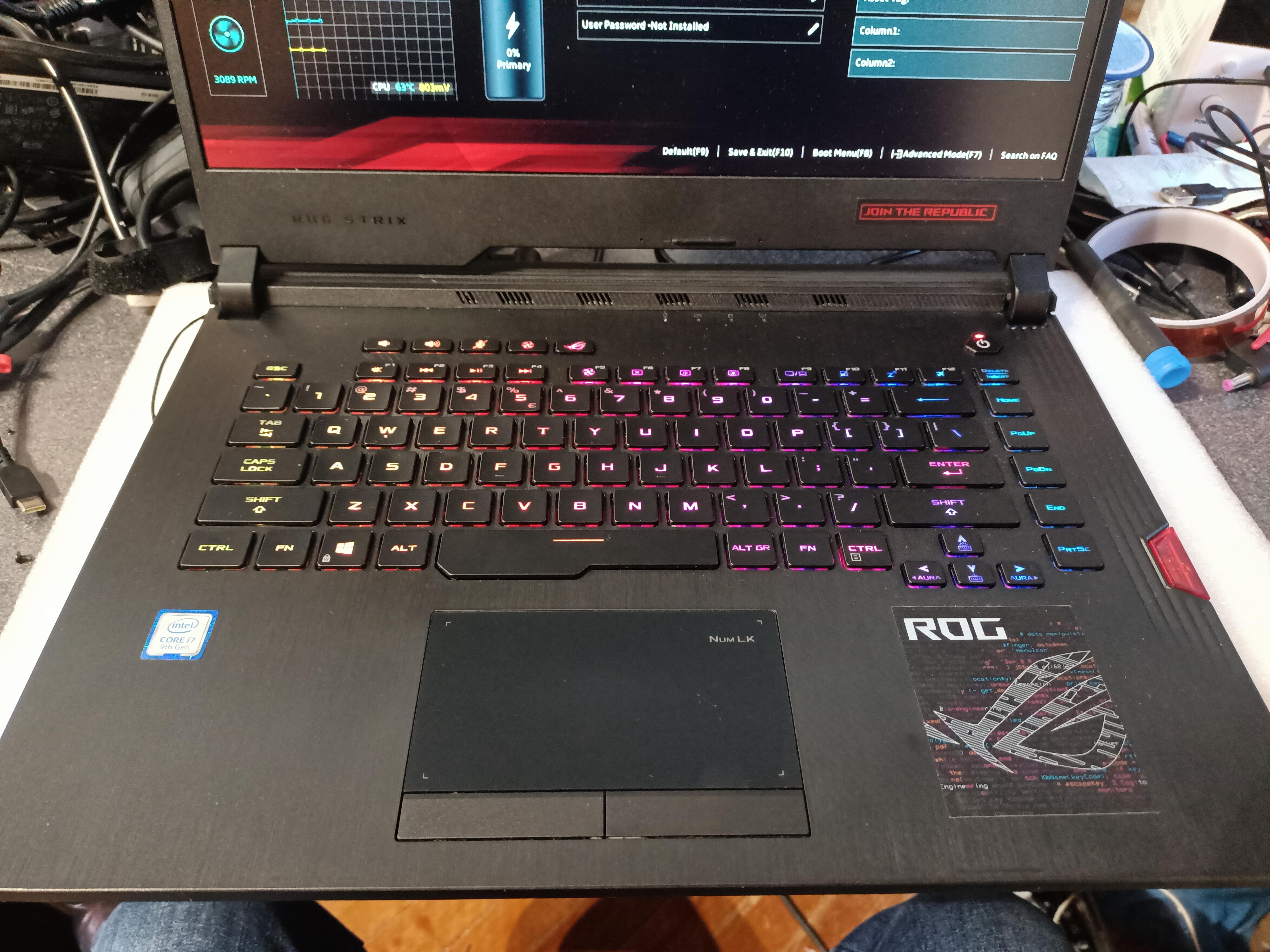

    Hello, I have an
    Asus Strix g g531gu-al065
    the board has the markings g531gw rev. 1.6
    with i7-9750h nvidia 1660ti,
    SN:K9NRCV01U42136a
    it looks like this so that all voltages are OK, the laptop "starts" but the voltage is constant
    1.3A supplied by the service power supply, (I reset the BIOS by unplugging it
    battery, RAM checked on 2 laptops and 2 slots)
    It does not provide an image either on the matrix or via HDMI, the fans start running after some time but with no effect
    constant speed while trying to turn off the laptop by holding the button
    5-10sec it turns on again. I pulled out the bios and compared the loads with several
    from the Internet, do not coincide with each other. I came up with the idea to download the bios
    from the manufacturer's website, but I'm not advanced enough to help
    Does anyone know how to replace the manufacturer's file with a bin file for the programmer?
    I don't know which BIOS version should be correct, the motherboard or the case model.
    Guide about it? Or can anyone help me and prepare a ready bios? Any tips on how to move forward? They are slowly coming to an end
    ideas
    Oryginal bios in Attachment

    Your bios dump is fcked up. If you read it with CH341a do 3-4 readings and compare them until you get 2 identical. Anyway, you have a good bios with your serial.
    • tomuso154
      • Jun 2024
      • 16
      • poland
      I uploaded your bios and it's still the same... The laptop does not reset, the power supply is 1.3A. The keyboard backlight does not work, after holding the power key for 5-10 sec, the laptop turns on immediately, there is no image. It may be an ME REGION?​

        HI,i have an Asus Strix G531GW laptop,its PCH was dead,i replaced it,now its working fine,but picture is showing after a few long seconds,i tried myself to make a clear me with my bios,i probably messed up with something,because my keyboard backlight is no more active.
        Can i get a Clear Me of my windows or from another by a professional? I never ever will try myself again( my mistake).I attached my bios wich is on my laptop,unfortunatelly i made the changes(if) on my original,maybe not,but its working,only without keyboar backlightand posts after 10-15 seconds.
        My laptop MB G531GW Rev. 1.5
        with intel i9 and RTX2070
        SN: K5NRCV005172180
        Many Thanks in advance
          • 22189
          SN: K5NRCV005172180
          Here is your new bios.
          • pityulix
            • Nov 2021
            • 32
            • Targu-Mures
            Thank you Very Much,working perfectly.God Bless You.Thanks for your time.
