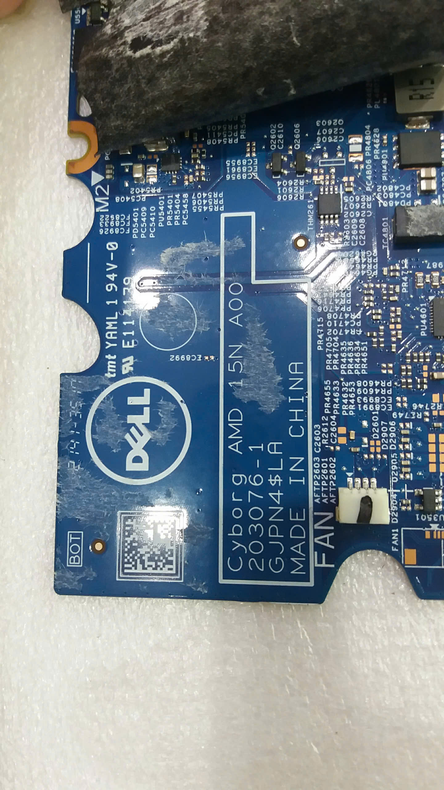

                      Hi all, I have an inspiron 5515 turn on, no display, fan at max speed. i've flash bin file from post #39, it now have error with memory and no display, fan blow at max speed at all time. Old bios attached. please help
                      DELL Inspiron 5515
                      REG MODEL: P106F
                      REG TYPE NO: P106F003
                      the service tag is:
                      1RYDQ93
                      thanks

                        Inspiron 5515
                        Service Tag: 1RYDQ93​
                        • lapfix
                          • Mar 2020
                          • 2756
                          • my workshop
                          #92
                          Try same version
                          1.27.0
