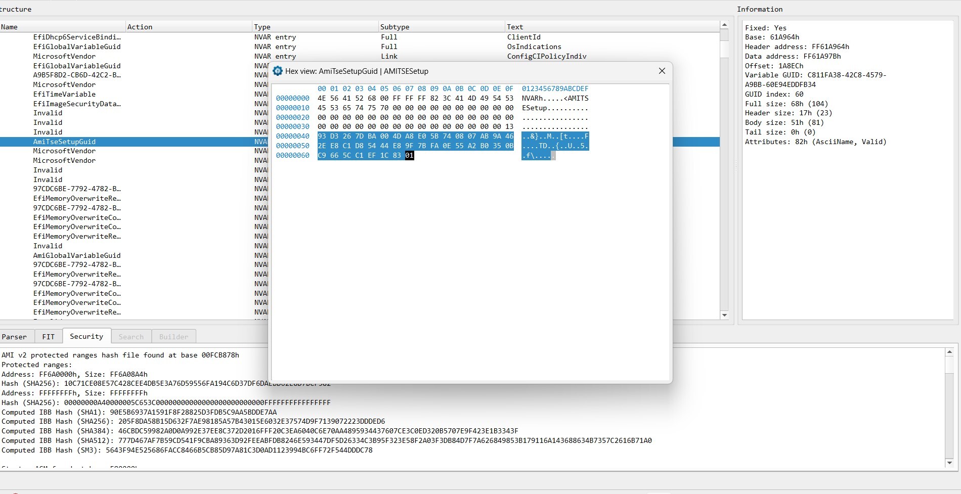

    Hi can anybody help me with a Bios password removal on a ASUS UX425EA-KI560T /N:M6N0LP02P89724B NB2555_PCB_MB_V4
    I have searched under Bios guides and Methods, extracted the bios and used a Hex reader to search for the correct string but i simply cant get my head around it.
    Original Bios dump attached
    Find the string "Amitsesetup".

      I have been searching for it but not 100% what im doing or even looking in the correct place.

        am i at the correct place?
          Open the file with HxD editor, fid "Amitsesetup", F3 to continue.

              F3 to continue.

                i just get this error
                  That's not an error.
