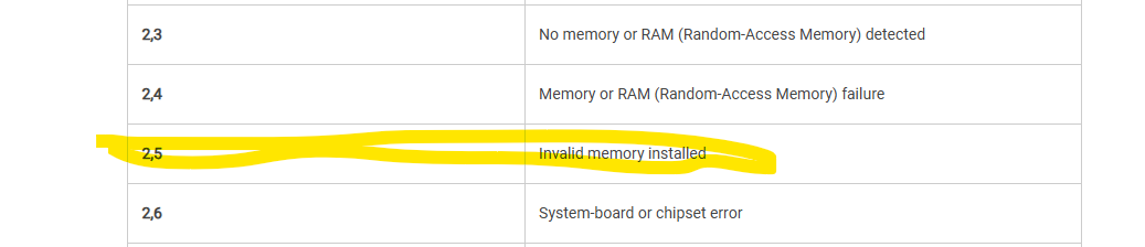

                    Hello, please someone help me! My Dell Inspiron 14 5415 laptop when starting up the keyboard light is on, but the screen does not display!
                    ST: G139KS3

                            #53
                            thank you very much for your help, i just came back from work and hurried to do it, however after i loaded with CH341A the machine still doesn't work, the keyboard light flashes continuously, the power light flashes white 5 times, flashes yellow 2 times, the screen doesn't display

                              #54

                              • nguyenhuuducntu
                                • Apr 2025
                                • 35
                                • Japan
                                #55
                                I tried removing the RAM and installing another RAM, but the problem is not the RAM. The Bios flashing process with AsProgramer reported success, should I flash it again?
