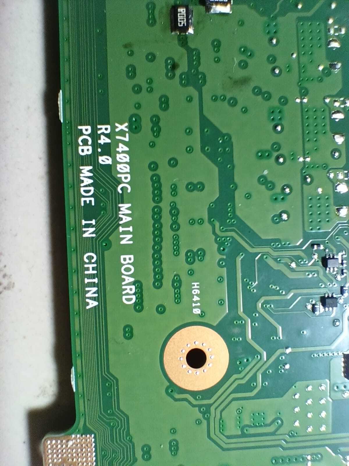

          asus n7600p
          kode mainboard = x7400pc r4.0
          sn = N1N0CX12F976029

              I've tried it, now it won't turn on, only the indicator light flashes twice.

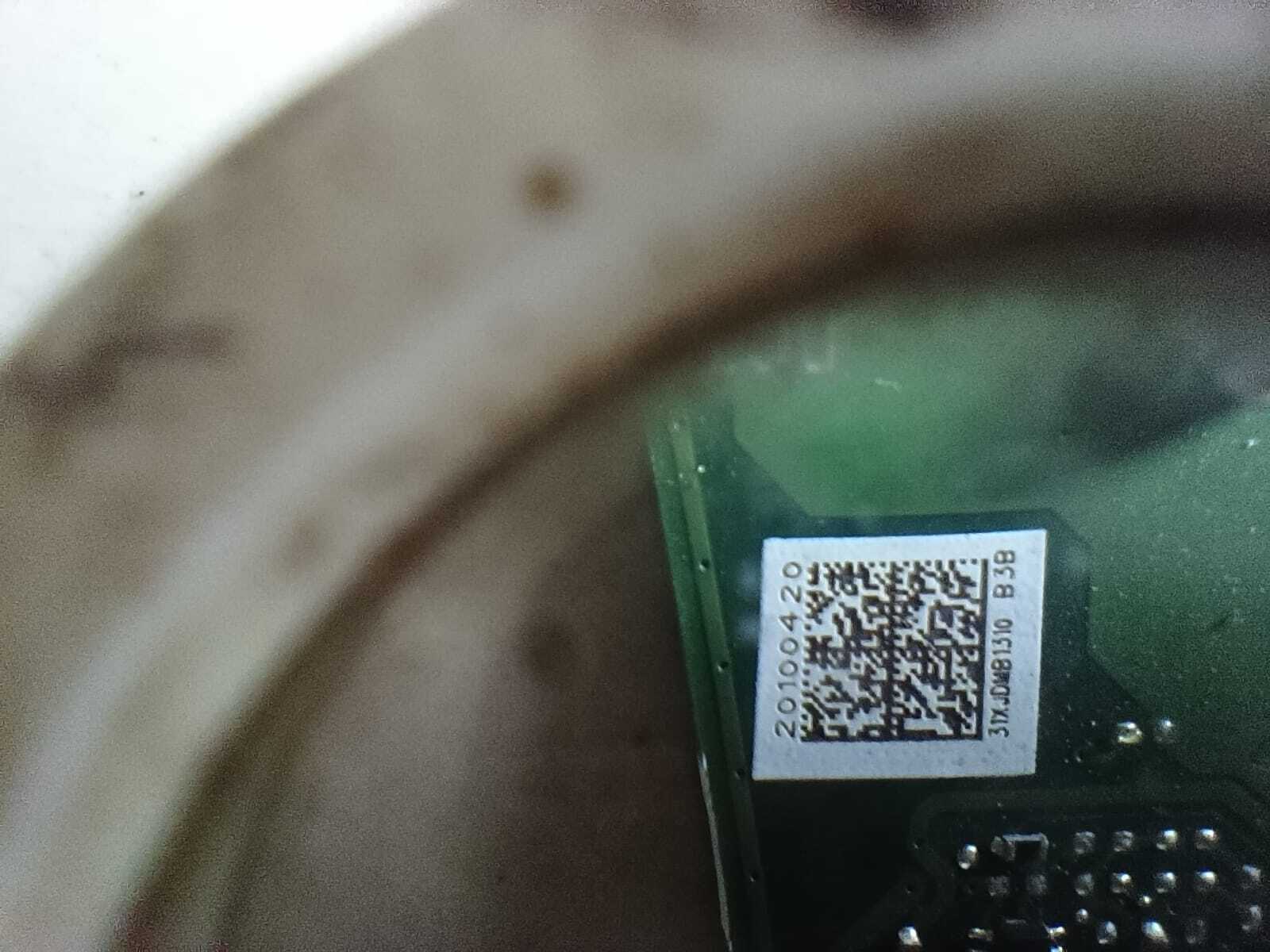

                post a picture of the QR code near the GPU ram
                • goldsink478
                  • Feb 2013
                  • 29
                  • indonesia
                  Is this?

                        I've tried it, now it won't turn on, only the indicator light flashes twice. but with the old bios that I uploaded above, it shows the display on external (hdmi)
                          SMDFlea commented
                          Editing a comment
                          flash that working bios back again, when an image shows on external but not on screen its a bad cable or screen.
