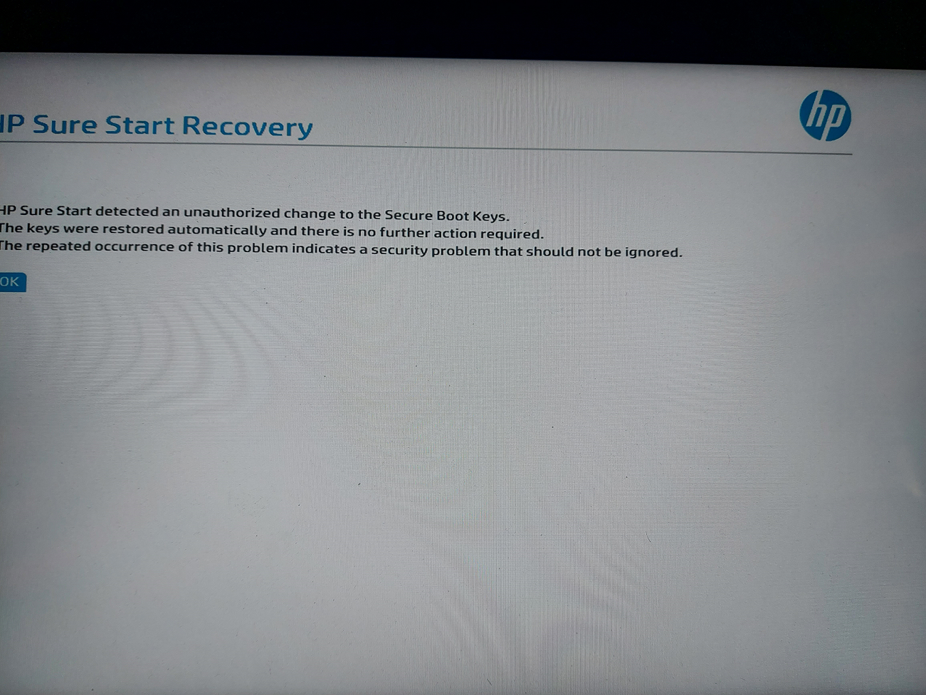

Hp Sure Start Recovery boot loop on HP Elitebook 840 G5
    HP Elitebook 840 G5
    ProID 2FA66AV
    Build ID 17WWCSAT601
    Has anyone faced such a situation in the past with laptops that have integrated HP Sure Protect.
    I tried to disable it from the bios but I don't have access, to rewrite the bios with a USB disk, it also doesn't work to enter the test menu with the F2 key, the same thing.
    I found a video clip on YT where the person in question edits the bios file saved from an HP 450 G7, but I don't understand most of the explanations because they are in Arabic.
    Can someone help me with some information?

      I'm sorry, I hope that now I will write all the information.
      HP Elitebook 840 G5
      ProID 2FA66AV
      SN 5CG82334TL
      Feature Byte: 3X 76j6S6b7B7H7M7Q7W7m7saBaEapaqauawbUdpdqgdhKhk.h4
      CT: PGWHQ00WBAQ1E2
      Mainboard model: COMPUTRO-6050A2945601-MB-A01(A1)

        post bios backup
          This is my bios backup.

              Thank you.
              It is almost the same, I did not write it in the SPI memory because I will try to modify certain portions of the memory until this message disappears and in addition it is for another platform (mine is Q78).
              Maybe someone has a solution! 🤔

                change your laptop hdd/ssd/nvme m.2 whatever you have in the laptop and check again the status is change or not ?
