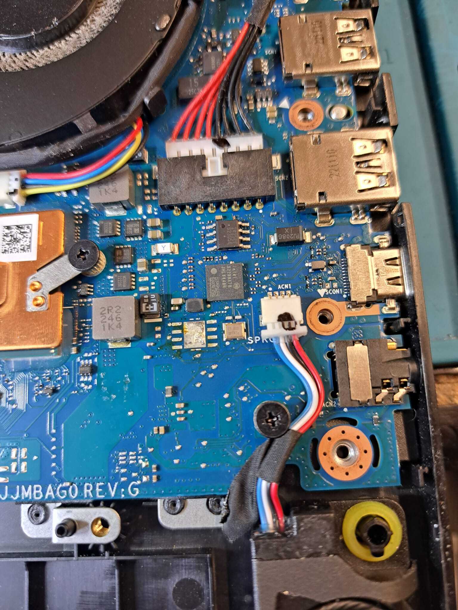

    Hi!
    It's an Asus FX506HC-HN053 laptop.
    After trying to remove the bios administrator password, it asks for the password, but no longer accepts the known password.
    I'm asking for help.
    Model : Asus FX506H
    FX506HC-HN053
    SN:NCNRCX0263904C
    MFD: 2022 - 12
    Board Model: DA0NJJMBAG0 REV: G
    Bios chip:Winbond 25Q80DVIG
    Bios Dump:

    try to find another bios .

      wrong chipset, look near PCH
      • Shandor2012
        • Oct 2015
        • 5
        • Romania

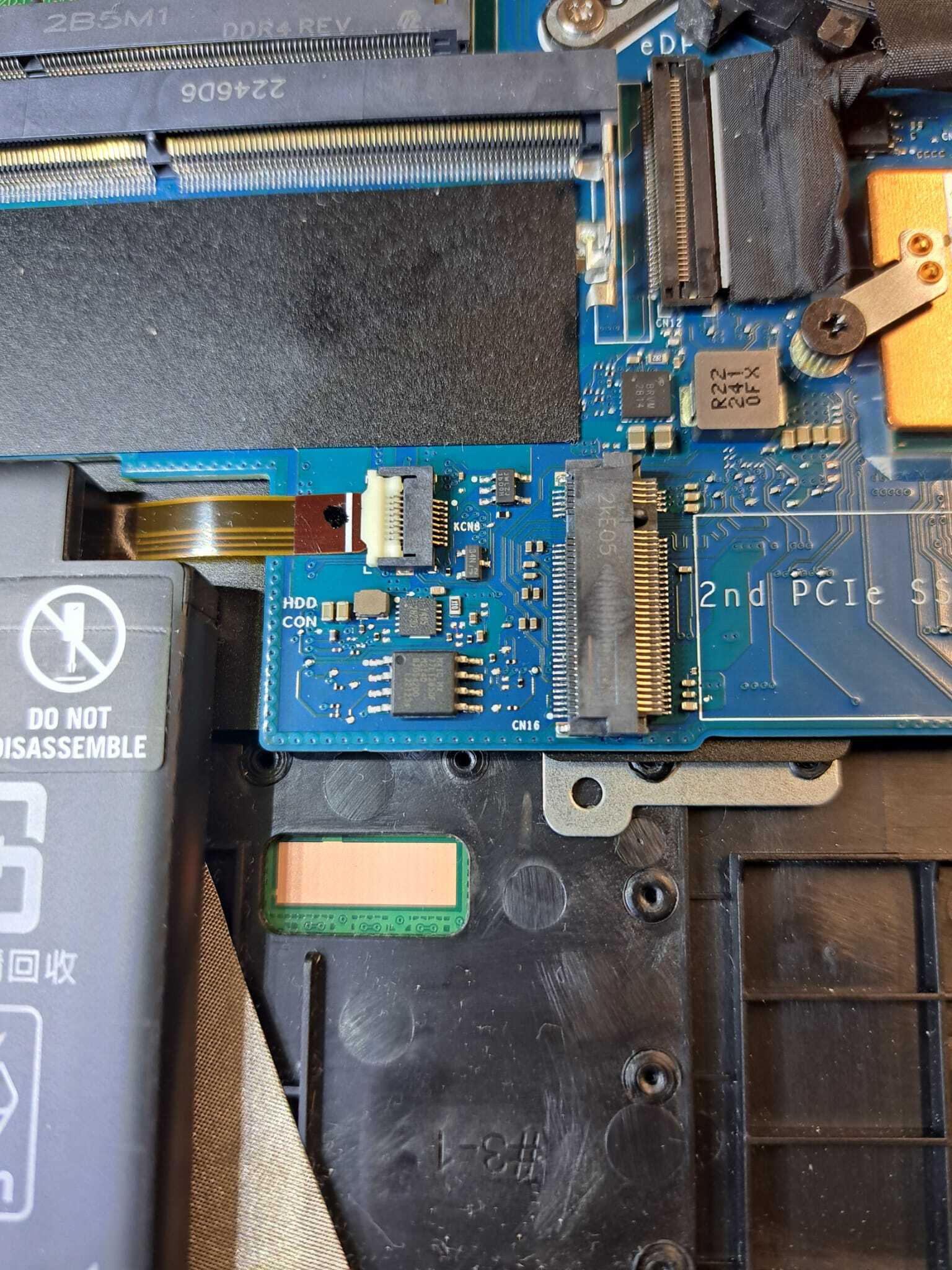

        You are right. Closer to PCH was this chip as seen in photo1, but I found another flash chip, MX77L12850F close to the second M.2 connector​, photo2
        I didn't find this face in the list from the TL866C programmer, but I'm documenting myself and coming back.

          yep, that one, MX77L12850F, I must have been looking at the other motherboard. Read it and post the dump.
          LE: I was looking at FX504 MB ...

            I managed to solve it.
            The MX77L12850F chip can be replaced with Winbond 25Q128FV, and the content can be found in the attached file.
            I update the description data and attach the working file. It is 100% tested.
            Model : Asus FX506H
            FX506HC-HN053
            SN:NCNRCX0263904C
            MFD: 2022 - 12
            Bios chip:MX77L12850F
            Bios Dump:
