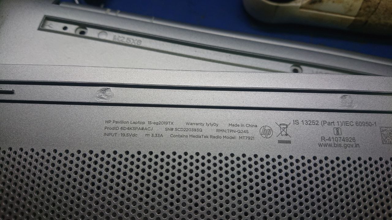

DAG7HEMB8F0 HP PAVILLION LAPTOP 15-EG
  • IT Expert
    • Mar 2022
    • 12
    • Pakistan
    DAG7HEMB8F0 HP PAVILLION LAPTOP 15-EG2019TX
    NEED CLEAR ME 40 SEC LATE DISPLAY.
    DAG7HEMB8F0
    SN#5CD220393Q
    DAG7HEMB8F0
    SN#5CD220393Q
    [Guide] How to extract ready for programming dump from HP update executable file
    https://www.badcaps.net/forum/showthread.php?t=121948
    https://www.badcaps.net/forum/showth...51#post1261151
    DMI: 26000 - 802FFF
    Windows key: 8A6000 - 8A603F
    P.S. Serial number in your dump is different.

      maybe somebody chang back cover.
      • Vesko356
        Vesko356 commented
        Editing a comment
        Yes it happens often, doesn't matter - follow the guides to make yourself a clean dump.
    • IT Expert
      • Mar 2022
      • 12
      • Pakistan
      guide me how to clean my dump file.
      thanks
      • Vesko356
        Vesko356 commented
        Editing a comment
        "Cleaning" your file is a much more complicated job, and completely pointless in your case since you have a guide to the easier way to do it. Just read the above two guides, make yourself a clean file and move the DMI and Windows key using shown offsets.
        But if you still want to do it the hard way, be my guest:
        ME Firmware Cleaning Guide
        https://www.badcaps.net/forum/troubl...-guide?t=88533
