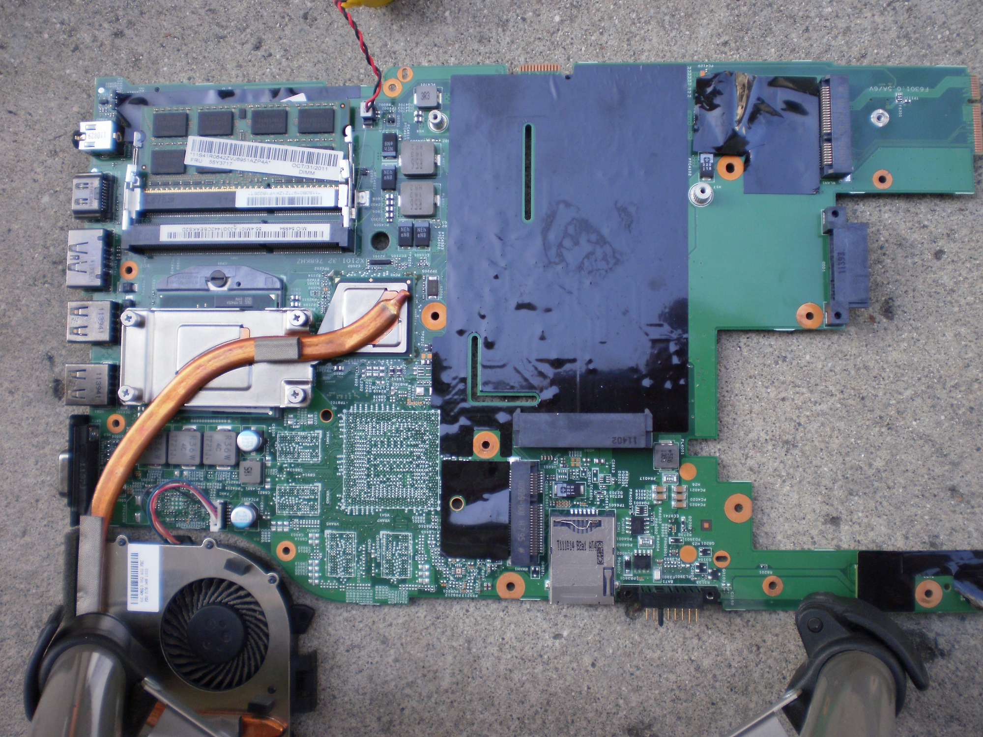

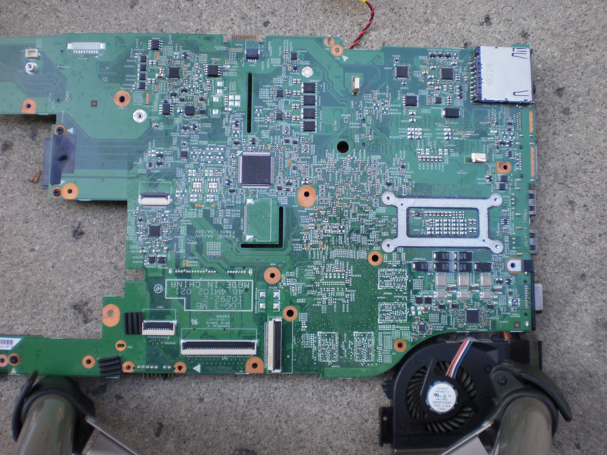

                              #34
                              Re: Dead Lenovo Thinkpad Edge E520 (BIOS ?)
                              post a clear picture top and bottom of the mobo

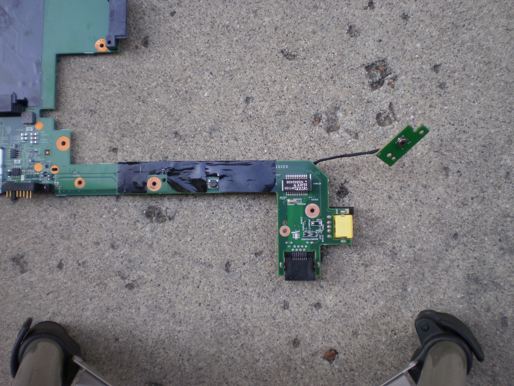

                                Here is to late, but tomorrow I will do that.
                                I think, that I don't have 3.3V.
                                • tibimakai
                                  • Jan 2012
                                  • 3680
                                  #36
                                  Here are the pictures.

                                    #37
                                    Right upper side of the 1st pic is what, near the m-pcie connector?
                                    • tibimakai
                                      • Jan 2012
                                      • 3680
                                      #38
                                      There are some parts under the tape. I did not look there yet.

                                          #40
                                          check the output of those voltages, usually on coils. post schematic.
