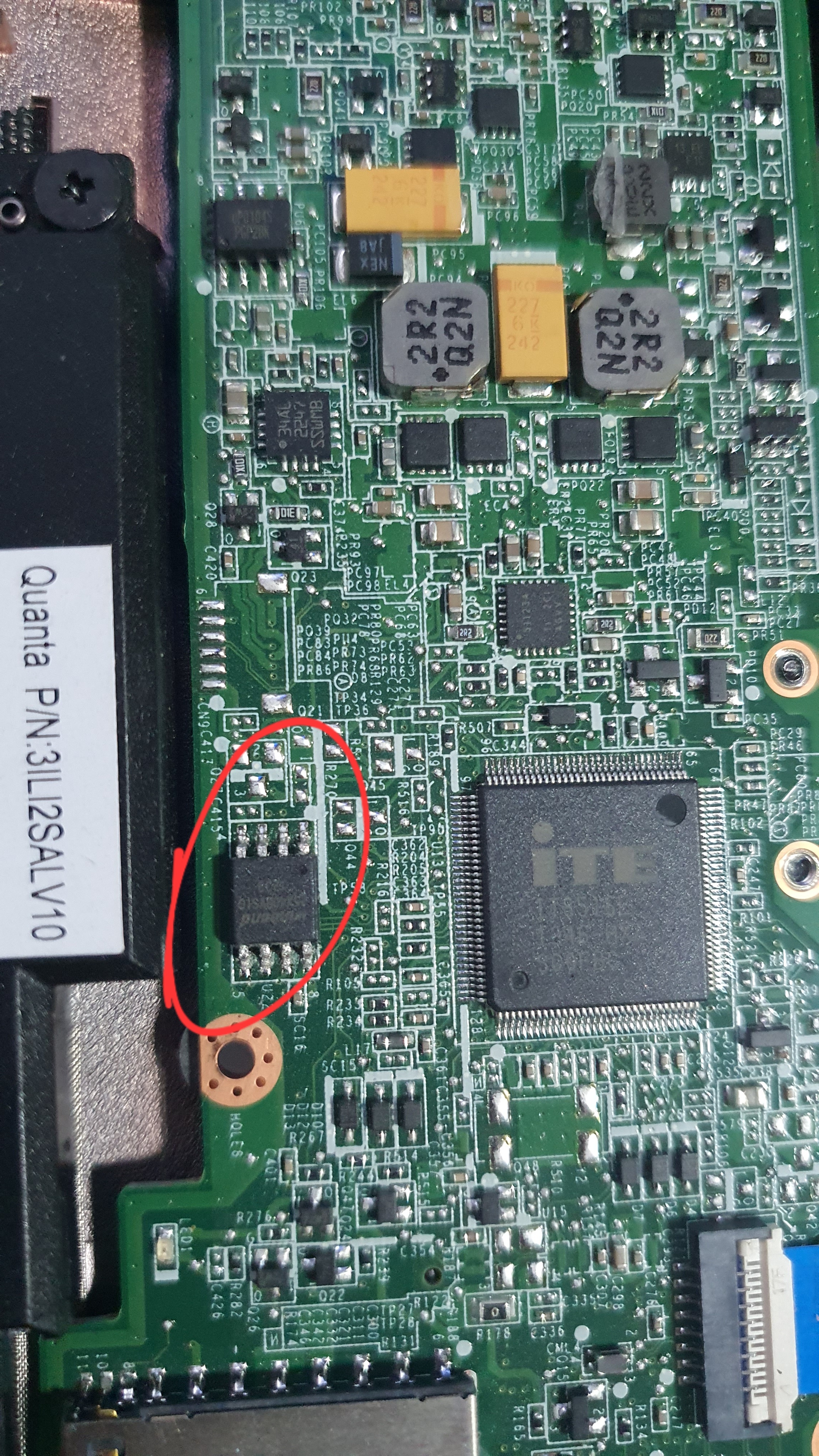

    I am trying to locate BIOS chip for Lenovo ThinkPad E130 but cannot find it. Is there anyone can share the location of the bios chip please. Thanks

    provide more informations, like serial and motherboard id. If it's Edge E130 one chipset is located near RAM slot and CMOS battery and the other chipset is located on the other side of MB near EC chipset.

      thanks for your response. Motherboard part number: DA0LI2MBF0 REV: F

      Is it the one encircled in the picture. Will the short circuit of the two pins method work on this model?
      Really appreciate your help. Many thanks

        I think that is EC bios chipset, Main bios is near RAM slot.

          Thanks, I have found two chips near ram slots, 1 is 4MB and the other one is 8MB. I have read using programmer and can't figure out which one will have bios stored. I have attached both files. Will be very grateful if you can unlock it if its the right one please

            bios is split between 2 chipsets, you have to merge dumps to get full bios image.

              Thanks, I have merged both files together, could you please have a look if it can be unlocked

                I really don't know how to unlock it and don't find DMI area. I can provide a clean bios and use LMU to write serial and machine type.

                  Thanks for these files but after erasing the old dump files on both chips. I have written these files you have provided. The password is still there. Any idea please
