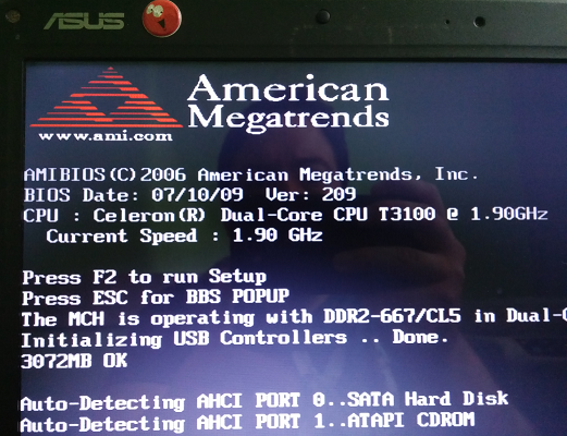

                                  Below is the screenshot of the ASUS notebook I unlocked.
                                  Bios date is: 07/10/09 so I tried couple of codes and one worked, I don't remember which one.
                                  I first assumed it is the year/month/day like in TXT doc so the code for
                                  2007-10-09 is 1AAAABAB and it didn't worked
                                  Than i tried with month-day changed order
                                  2007-09-10 which is AA2LBADB and also that didn't work
                                  Than I tried with the year being the last 2 digits:
                                  2009-07-10 - L11A0ADB
                                  and again reversed month-day
                                  2009-10-07 - 000LAALD
                                  I got the code right from the third try but I don't remember the order I did.
                                  This is only to help all of the users here to check the other variants of codes if they didn't do already.
